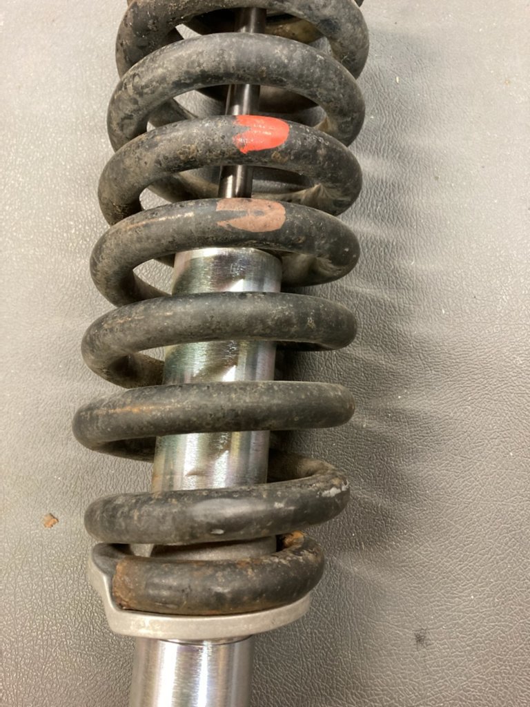

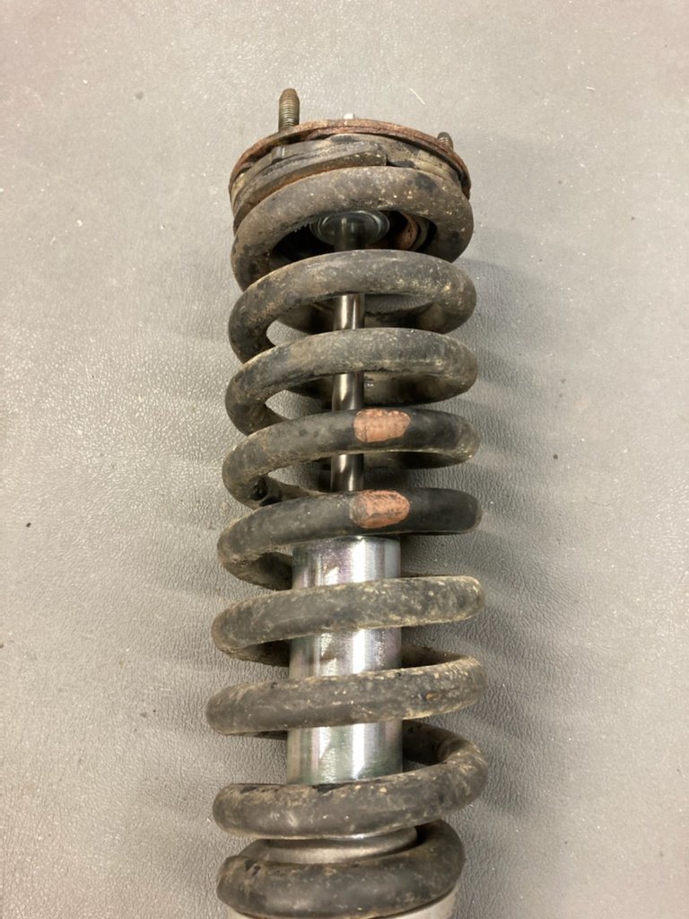

    I got curious this morning when we were looking at springs and color patterns. I have been wanting to pull my shock assembly off and lift them for a while but have just not put in the time. Decided to at lunch because i didnt really pay attention to what color mine were when i did the shock swap and i've been wanting to raise the front end a clip or two so it gave me a good excuse to pull the front wheel off and look at the spring.
    Ever seen a drivers side Red and Gold? Passengers side Gold Gold?
    Before pulling anything apart i did a bunch of measurements, even have measurements off the OEM shock. Was really wanting to try to see how much lift you get with each change in shock length. My truck with the Eibach adjustable shocks on the lowest setting, with stock springs was within 1/8th" on drivers and passengers side. I didnt have the typical Toyota lean like the Tacoma and 4R do. With them on the second clip i got almost exactly +1.5" on both sides they are within 1/4".
    The bed rail shows level, but the side step is nose high. The front is noticably higher and i'm either going to bring the front end down a notch after driving it a week or so, or lift the rear up a shade more.

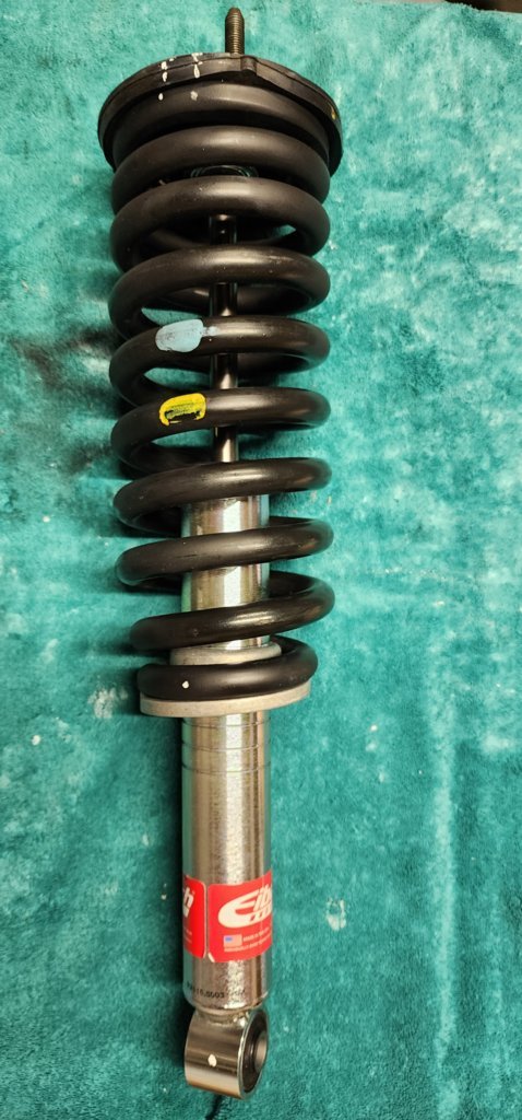

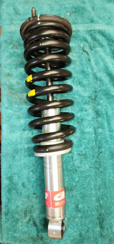

    Can confirm 2003 AC 4x4 colors that were bright painted even after about 250k. Touched up the black at rub points when assembling. But don't match yours ... DC seemed to have the reds, blues and purples but those look likely stock.
    https://www.tundras.com/threads/trd-coil-spring-r-y-y-p.129209/

    Interesting, thats the same combo i had, i had the same black shocks. I think its a red / gold. I scrubbed it to try to lighten the color and i am pretty sure its a red / gold. Not sure of the spring rates, i dont guess it matters unless someone was really trying to make an extensive list of colors and fitment. 2005 Double Cab Limited 4wd with Red / Gold + Gold / Gold

    For the records if someone is tracking... do you recall the side each was one?

    Yeah:
    2005 Tundra Double Cab Limited 4wd
    Drivers side - Red / Gold
    Passengers side - Gold / Gold

    I forgot to measure before swapping out the shocks and coils. I'm using the same shocks (Eibach Pro Truck) along with the their matched springs. Visually, on the bottom notch it looks pretty close to stock height and I haven't yet bumped them up any higher though I would like to go up one.

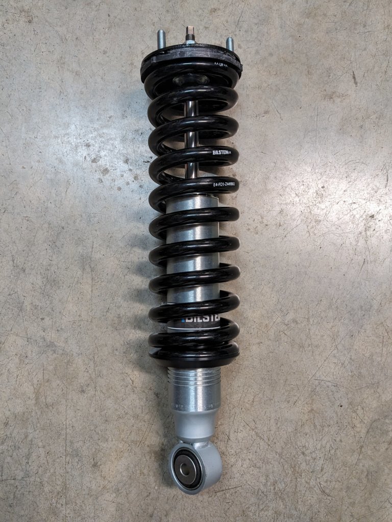

    Thanks! Ya I just have to remember to leave time for the other hobbies and responsibilities, and leave money in my bank account!
    Right now my goals are:
    1. To create safety margin where possible. Tires and ball joints come to mind as the truck will see a lot of winter storms and slick conditions. These will happen in the coming week.
    2. Promote longevity. Fluid film and my frame maintenance are done. I do push my trucks beyond the pavement and do drive moderately aggressive, so the spacer lift has to go, too many cracked spindle stories. Gussetted ones probably won't happen until the hubs start howling. Most other maintenance is up to snuff. Timing belt and all the goods this spring/summer I think.
    3. Fun stuff is last and will probably slow roll next year. Bigger brakes, better head unit and speakers, spindles, might repair and reinstall airbags (lines)... Heated seat stuff, backup camera, the list is already too long. I remember I have an auto dimming mirror from my Tacoma, wonder if the plug is the same...
    4. I'd like to get a camper on here, something like a FWC fleet or maybe a Topo Rincon, or maybe a Scout Tuktut? Definitely something minimalist and light. Getting a little old to be hunched over in the Leer shell these days and trying to dry shit from skiing... This might happen before the stuff under 3 if I can just enjoy the truck for a while LOL.
    Sneak peeks below:
