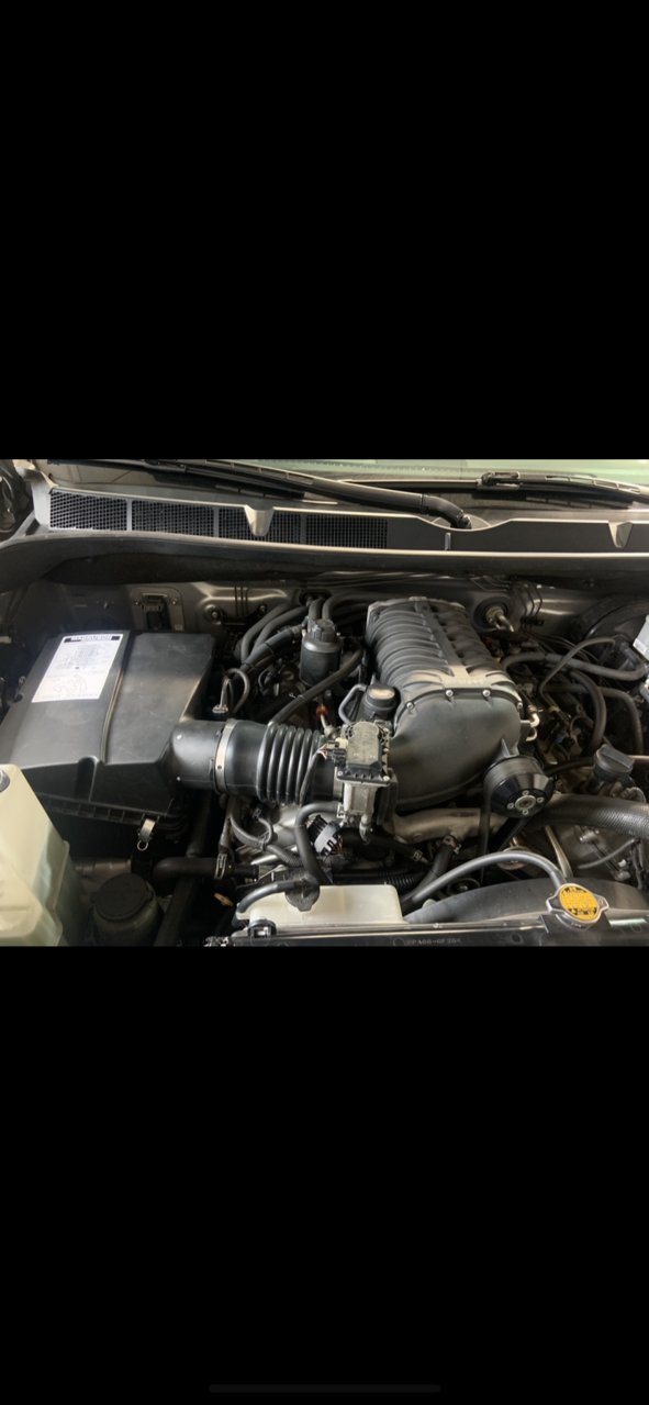

    Yup it works great with the Harrop rubber tube! Been running it for a while now. The angle is basically exactly the same as the stock box, just a larger diameter MAF tube. The weird magnuson snout angle is why they provide the funky angled intake tube for the magnuson. It’s actually more natural for the Harrop.

  3. Aug 15, 2023 at 6:36 PM
    #123
    Silver17
    Oct 3, 2021
    #68847
    3,670
    Eastern PA
    2017 TRD 4x4 Harrop SC
    I did the SABM with it. Not sure how the stillen tube goes through the engine bay but I would imagine it would be doable.
    Saltyhero13[QUOTED] likes this.

  11. Aug 16, 2023 at 8:25 AM
    #131
    Saltyhero13
    Saltyhero13 Throbbing Member
    Aug 12, 2020
    #50704
    4,913
    Fuel delete mod Cup holder upgrade
    Yes I saw that late last night/this morning on the SC super thread. I was going to cross link here but you addressed the fundamental question. Thank you.
    @19PlatinumCrew if you don't go with the Maggie box (which won't allow mounting the Stillen snorkel) and you decide to keep Stillen air box you'll have to talk to Nat Speed what size custom tube you'll need if they will support modding. MRP sells a 3.75" ID (might be too small) and a 4.0" ID (might be difficult to find a correctly sized reducer coupler to go from 4.25" OD to stock TB).
    At that point I would just get the Lexus TB and go with the 4.25" ID tube. You can skip the out of stock coupler and mount the roofing flasher to the box to make it air tight (or whatever other sealing method you choose). You can also skip the roofing flasher and just insert a panel with a duct coupler inside the box and call it a day. This would basically look similar to a SABM. That leaves finding a TB coupler and mounting the filter inside.
    I still think just getting an off the shelf Maggie box is much easier to deal with. You need just enough intake (Maggie) not the biggest intake.
    reywcms[QUOTED] likes this.

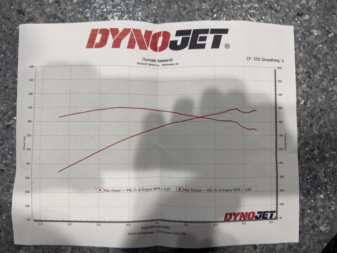

  15. Aug 16, 2023 at 9:01 AM
    #135
    WinterWarlock21
    WinterWarlock21 New Member
    Dec 6, 2020
    #55783
    242
    Dan
    South Jersey
    2016 Quicksand TRD Pro CrewMax
    https://gearproject.co/profile/SandShark21
    Sitting at national speed. Should be out of here by 2 pm. Lunch then final walk around and test drive before heading home to south jersey (4.5 hours). I’ll do a full write up afterwards.

  30. Aug 16, 2023 at 4:40 PM
    #150
    WinterWarlock21
    Dec 6, 2020
    #55783
    242
    Dan
    South Jersey
    was stuck until 3 in VA. Hit a wall of traffic in DC and then some light traffic near Baltimore. GPS took me route 1 back to Del Memorial Bridge. Boy was it a looooong drive. Glad to be back home. Thank you!
