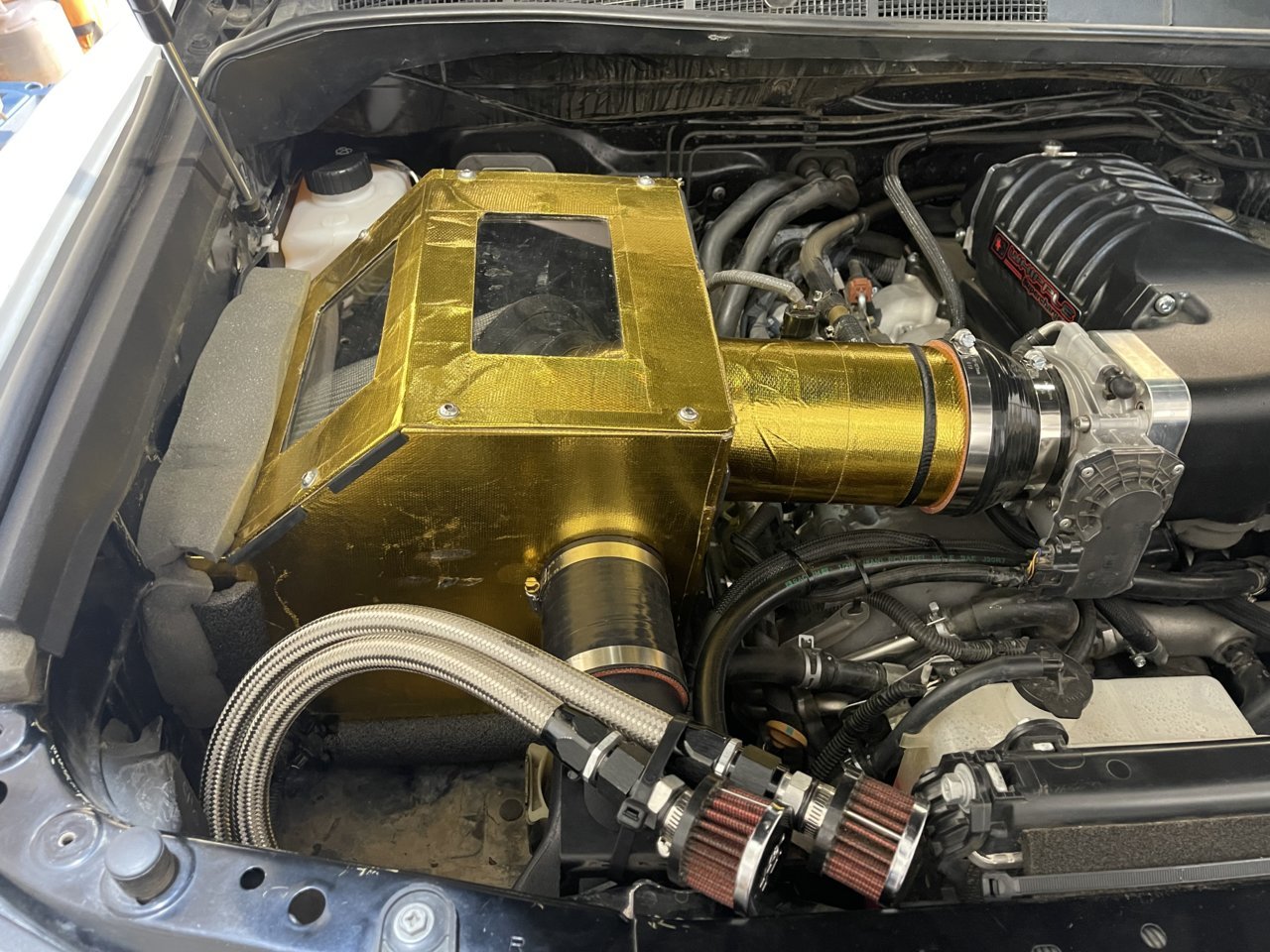

    Catch can ,psb1and mount ordered...trying to decide if I'm keeping the Stillen or changing to the TRD box...and the credit card gets full again

    If you are using the stock TB you will probably be able to keep the Stillen with no mods needed. The Harrop doesn't change the TB position.
    You only need parts if you are trying to get it to work with a larger intake and/or TB.

    To everyone with a afr/boost gauge what is the best location for the bung to be welded in and does it matter what side Driver or Passenger. I have the Innovate ps1 ordered

    If you’re doing the 80mm pulley I would definitely get the larger intake (TRD SC/Magnuson SC intake). You will be exceeding the MAF voltage limit which means your tuner will basically be guessing on getting the fueling correct beyond 5k RPMs or so. Been there, done that! Then later down the road I had to pay out more for a retune on the larger properly sized intake. I also used to get annoying P0101 MAF codes all the time in the stock sized intake, but no more after upgrading and retuning. Do it all the right way the first go around is my advice.
    Some have it drivers side others have it passenger side. Mine is on the drivers side, but it’s a bigger pain to install with the driveshaft there than the passenger side. You want it down stream of the primary O2 sensor and installed at the angle called for in the directions. The case for the driver side bank is it has cylinder 5 which tends to be the problem cylinder. The case for the passenger bank is it the passenger fuel rail gets fed second in series after the drivers side rail.

    I think Stillen is one of the better airboxes on the market because of the front snorkel/inlet, that is really the main distinguishing feature.
    You could feasibly mod any box and mount the inlet to it RE: PS + Stillen snorkel fusion @reywcms since Stillen now sells the snorkel inlet separately. Modding a box that way would be easier and cleaner than the approach I took (out of desperation).
    You don't really need their special deflector since you can mod the stock deflector just fine for the intake and pump hoses.
    If you go with the Radium catch can and the Stillen you'll have to get a spare bracket from radium to shift the can over and avoid physical interference with the intake. I don't know about other catch cans on the market.
    Stock Air Box Mod (SABM) might be able to do the same for you as the Stillen but I've not seen them compared side by side.

    This is accurate! The two main reasons for switching boxes is the larger maf pipe and larger box for more air/bigger filter . I have the Prospeed box and added the stillen tube.
    The issue with the Prospeed box is it isn’t as sealed as other units. I also added a much larger filter than what was provided with the kit.
