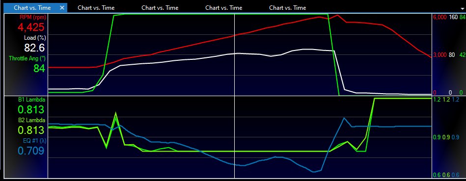

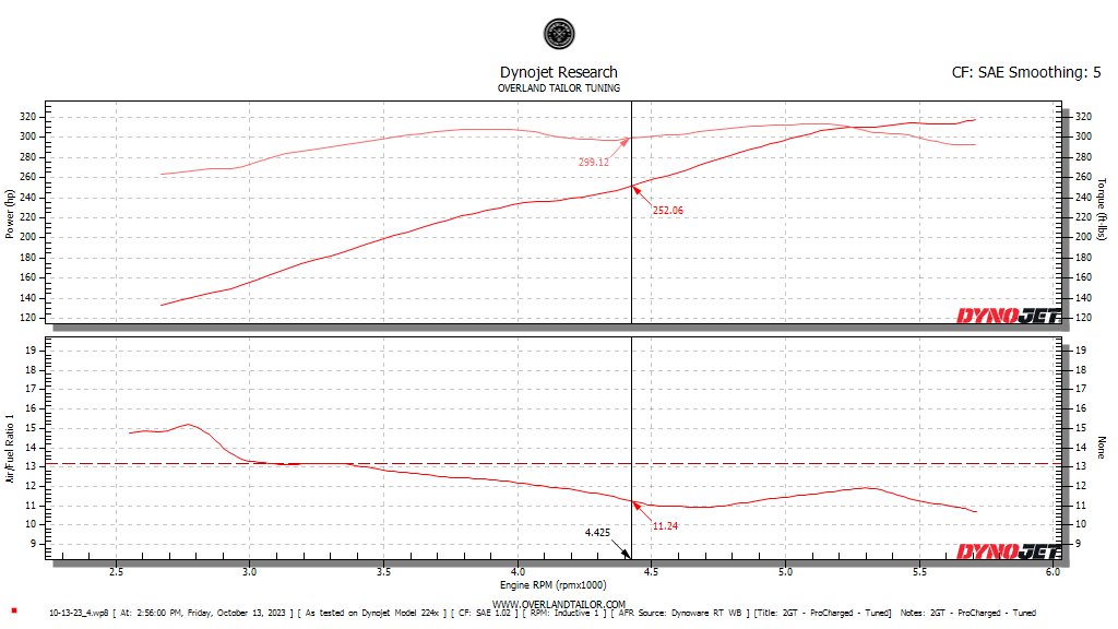

    Great Question!

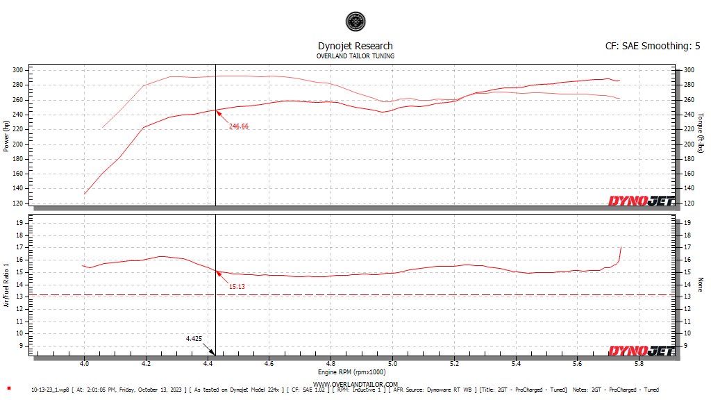

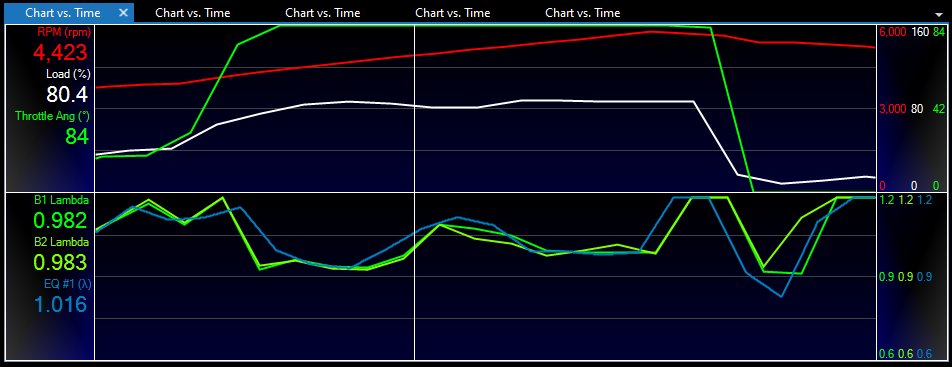

    Let's take a look at this very thing with some actual data. All collected at the same time.
    2G Tacoma, all stock other than a ProCharger kit as our test subject. Stock exhaust, stock ypipe w/ 2nd cats, and stock manifolds with primary's. Let's look at what the factory O2's read (before all 4 cats) what the wideband read (it was installed by ProCharger after the merge in the ypipe so after all 4 cats). and we'll look at what the tail pipe sniffer said.
    Stock ProCharger tune:
    How's that for "lean"..... :)
    To a work in progress configuration with a bit richer mixtures..
    There you have it. I'll let you guys digest on that for a bit. :)

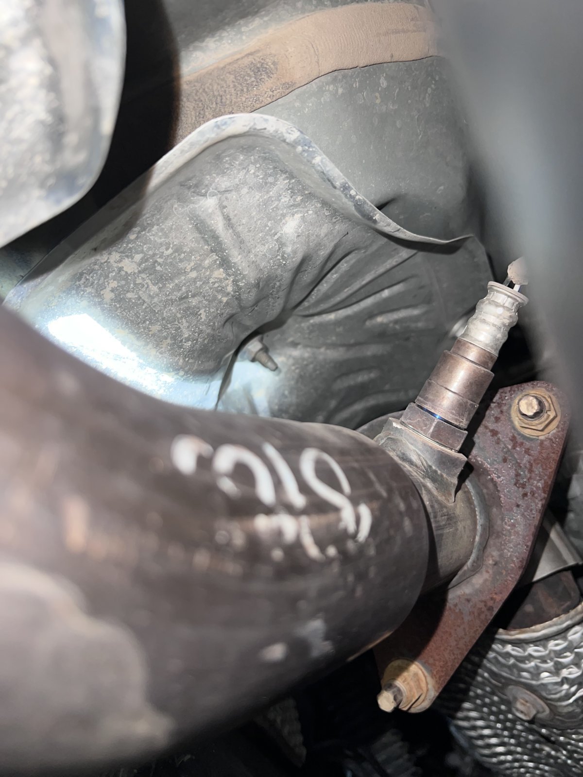

    570 bucks for gauge install basically to set it up and wire it in I had already mounted it in the ac vent and ran the wires to the driver's side fuse pannel. National Speed was to pull cat pipe and weld in bung,wire up the gauge and I told them passenger side before primary cat...again NO COMMUNICATION OR JUST DONT CARE...didn't mean to yell

    You are justifiably emoting frustration. For the money they ask for they certainly didn't treat you well nor do the job correctly.
    Shame on them. Reputations are hard to rebuild.

    At this point I think that ANYONE looking to have National Speed do work for them should be aware of my situation. We are adults and can make our own choices, I am not going to rant and rave and call out anyone personally all I will do is relate MY experience with them,what has and may happen in the future as I use my truck.
    We have a trip planned Nov 1st and I will be towing the camper so that will be interesting to see how it towes with the Supercharger. I do worry about the installation since we all have seen how many things that have gone wrong with my installation, just hope it doesn't leave us stranded on the side of the road.
    As far as the afr gauge and sensor location I'm attempting to resolve that before our trip. Thanks to ALL the forum members that have commented, offered information and advice.....to be continued

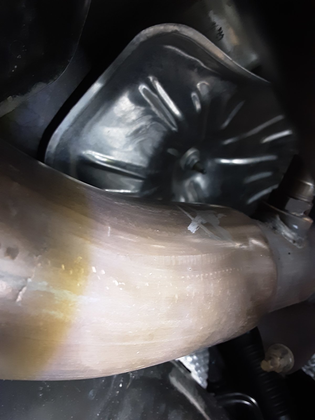

    Doubt it will make you feel any better, but the white mark on the pipe near the factory sensor is more than likely from manufacturing/assembly. Every one I’ve seen had some kind of white paint pen graffiti in that spot.

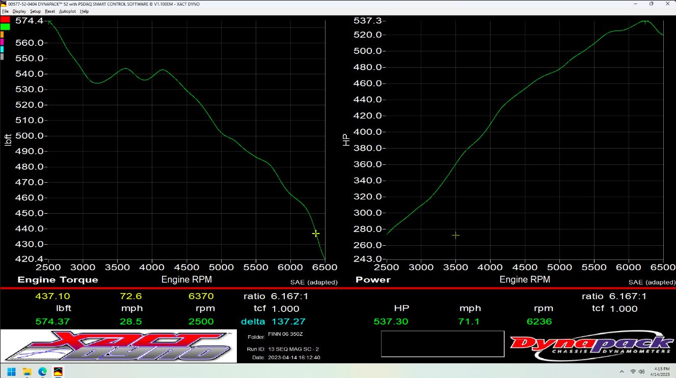

    574, 537. Belt was slipping at full beans

    Seems kinda suspect that there looks to be an x where the sensor should have gone.....doesn't change that it's not installed in the right location

    The local guy took a look at my psb1 sensor location said shouldn't be a problem to move...scheduled for next week then we can see if the gauge was set up or not. I'll keep yall posted......truck seems to be running great

    Yeah the angle is good but seems too far down stream.

    Boneheads put it after secondary cats.....directions said after primary factory sensor

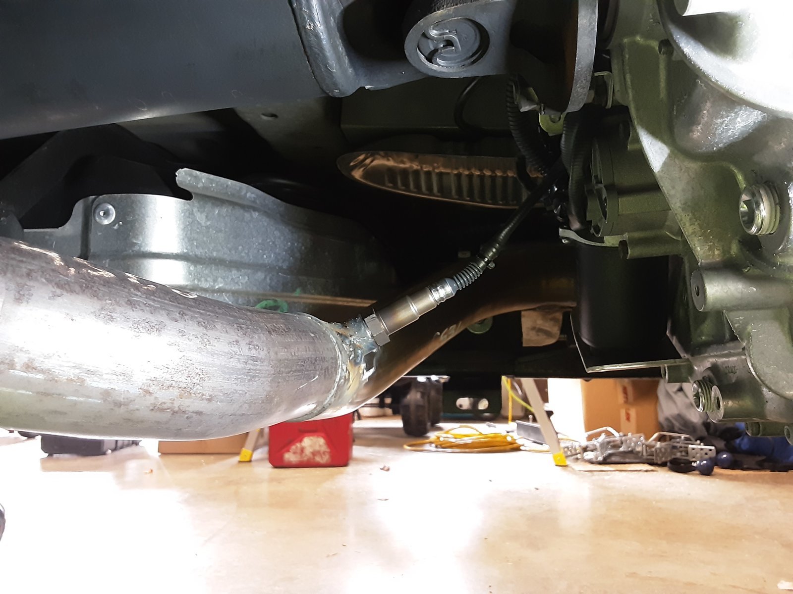

    Wow! Did they read directions? Aem and Innovate say about 18 inches from manifold. Should be right around front of primary cat or a bit closer.
    Some shops will put it further down but I'd like a quicker read.

    I think since they were upside down on this install get it out a quickly as they could, I have about 300 miles on it and it seems to be running well....time will tell
