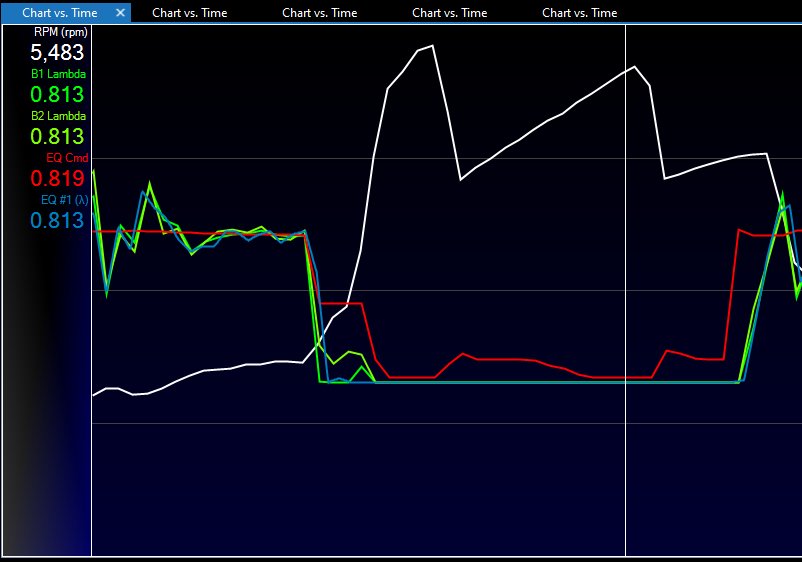

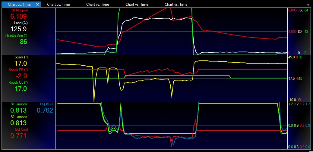

    Rey's last log with us. (EQ #1 = AEM Wideband)

    In your experience is running in the 11s for AFR safe? Most places seem to shoot for low/mid 10s, do you think that's too conservative?

    We're not most places, and we don't follow the pack - we follow what the data tells us. With the particular vehicle/setup that generated the log above, that's what we deemed appropriate. Our testing hasn't shown or given us any reason to target 10:1 or otherwise on a stock internal 3UR with any of the available blowers running quality pump fuel at this airflow level. We've gone richer and leaner and settled where we did (for that particular combo), as we've not observed there to be any improvement in output with a richer mixture on similar setups we've tested on the dyno. We've got folks with similar setups towing 7K+lb trailers cross-country with our calibration, and I 110% stand by our work.

    I have no dog in the fight. Can you share with us what AFRs Nat Speed put on OPs build? Hopefully not too late.

    EQ#1 should be ignored. It's an unused channel in this log.

    Interesting so about the same as your shop uses, correct? Edit: sorry leaner.
    Curious as to any other findings.
