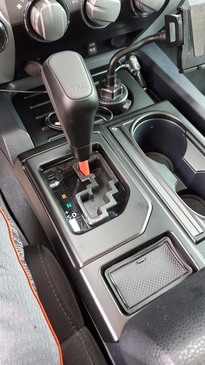

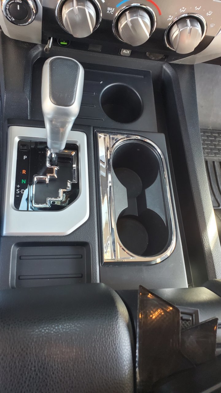

    Hey y’all, thought I’d share a pic of my random combo … this might not be everyone’s preference but it’s my truck so I get to do whatever I want!
    Used the MESO trim for the cup holder, great quality and fit. Love the simple look.
    Kept the OEM silver outer trim around the gear selector, I like a little contrast and it doesn’t blast my eyes with sun reflections.
    Used the AJT pop-in trim around the inner gear selector because it also has a simple design and was very easy to install.
    Also, just wanna say that I am grateful that we have both AJT and MESO providing us with options. They both make quality products.

    You do you. How do the colors match between the two manufacturers?

    Great match color wise. One thing I forgot to mention is ... the MESO stuff seems to have a bit more "texture" – not a lot, the AJT stuff is more smooth than the MESO stuff.

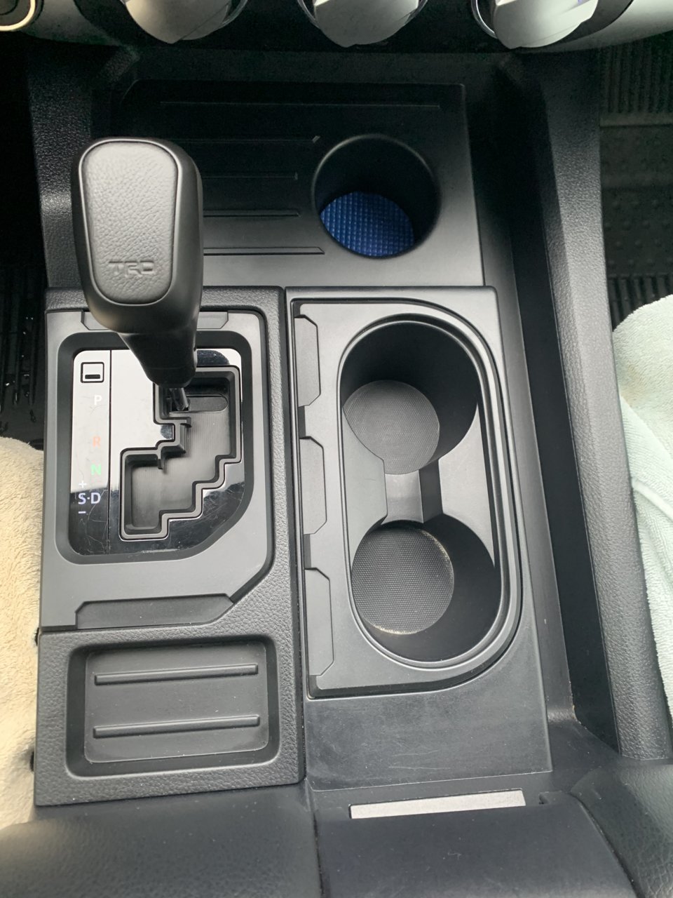

    Through this thread I figured out the direction I wanted to go with console. Finally got it all together today. AJT around shifter, Amazon full cover (was linked earlier in thread), black with red stitch TRD knob, with red heat shrink to cover exposed chrome below it.20220211_134952.jpg 20220213_104007.jpg

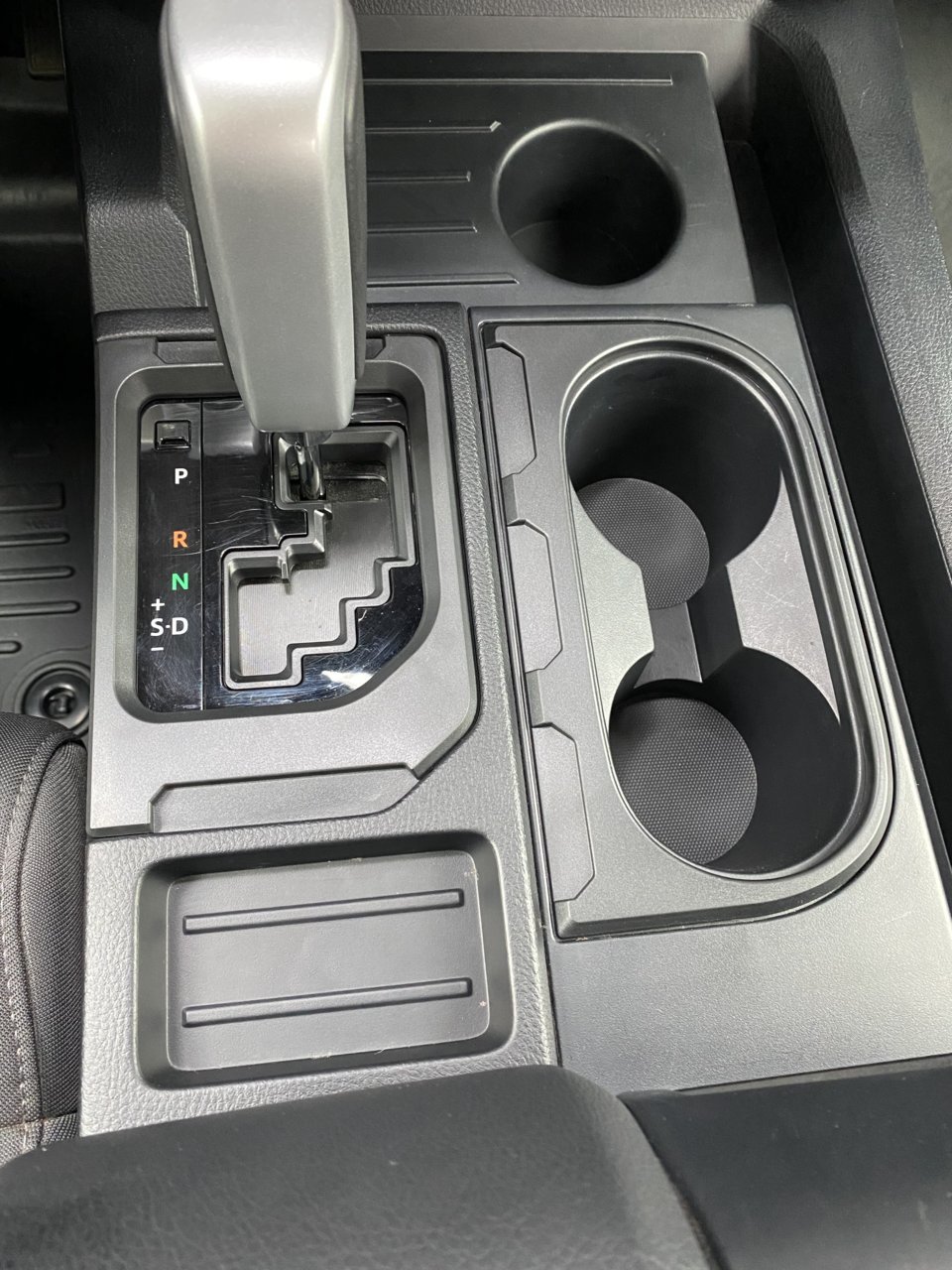

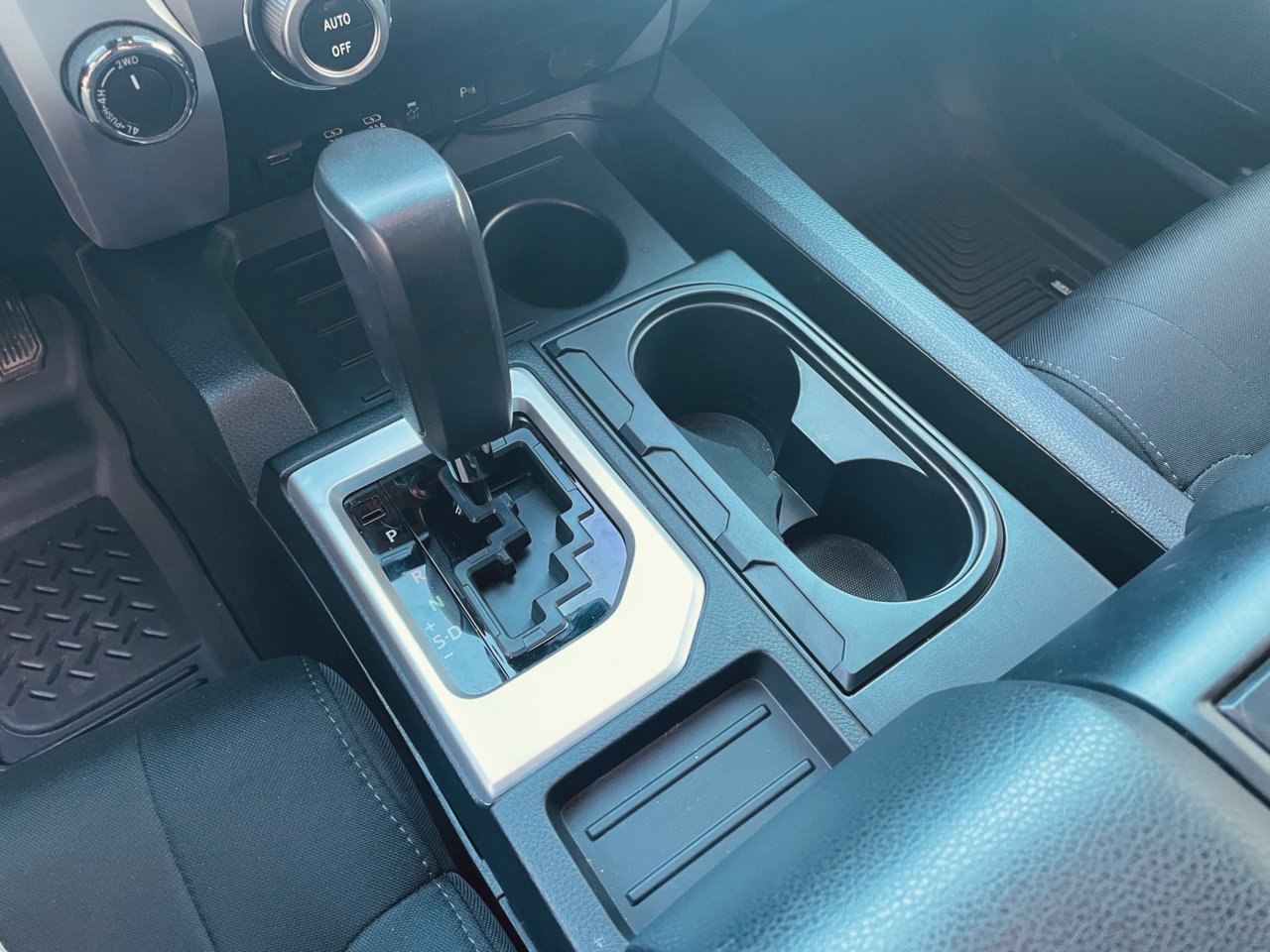

    Here’s the meso mixed with ajt shifter ring for guys wondering how they match together. since the ajt is just snap in it’s a lot easier then the meso and I might just leave it. Installing the other two takes 10 minutes probably if you have a drill around to knock out the plastic welds. just don’t go crazy and mess up something on the other side.
    I also found their youtube video to install helpful for those wondering since meso didn’t make one

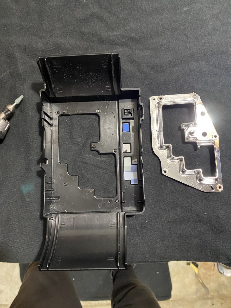

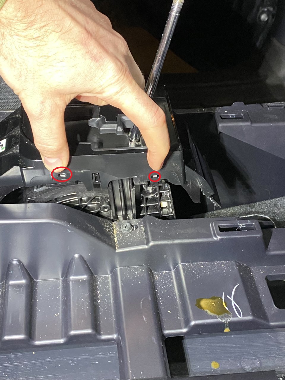

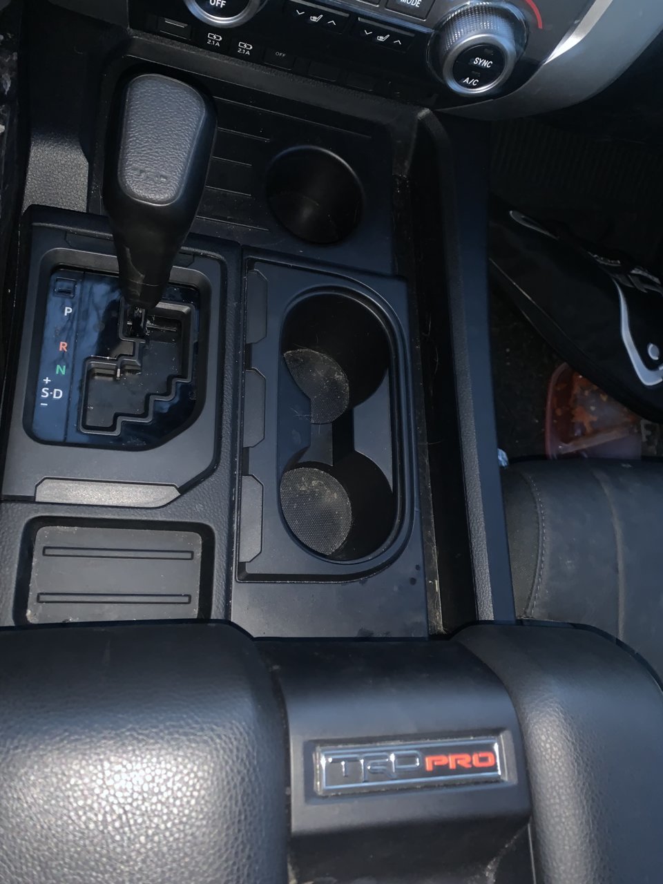

    11AE0D9A-E0E3-4D31-A211-04F3FE9946F4.jpg Install done. Pretty easy. Go slow with the 1/4 inch bit for the plastic welds. Good fit all around, would recommend.
    Tip I would recommend… I was unable to get any of the trim kit tools between the chrome shift trimp piece and the shift column so I popped the whole thing off, flipped it over and pushed the chrome piece out. No damage.

    Super clean look. I'm please with mine

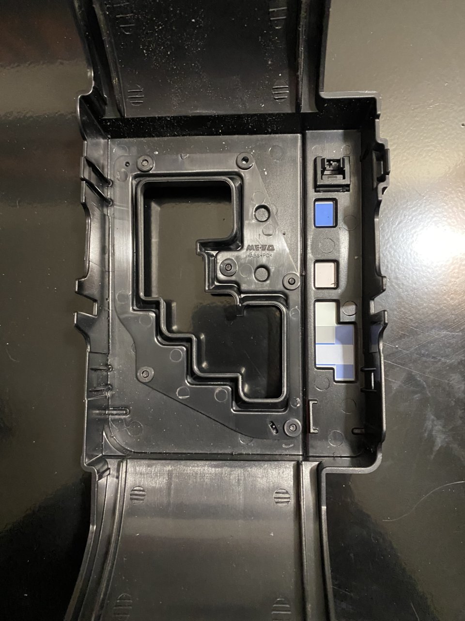

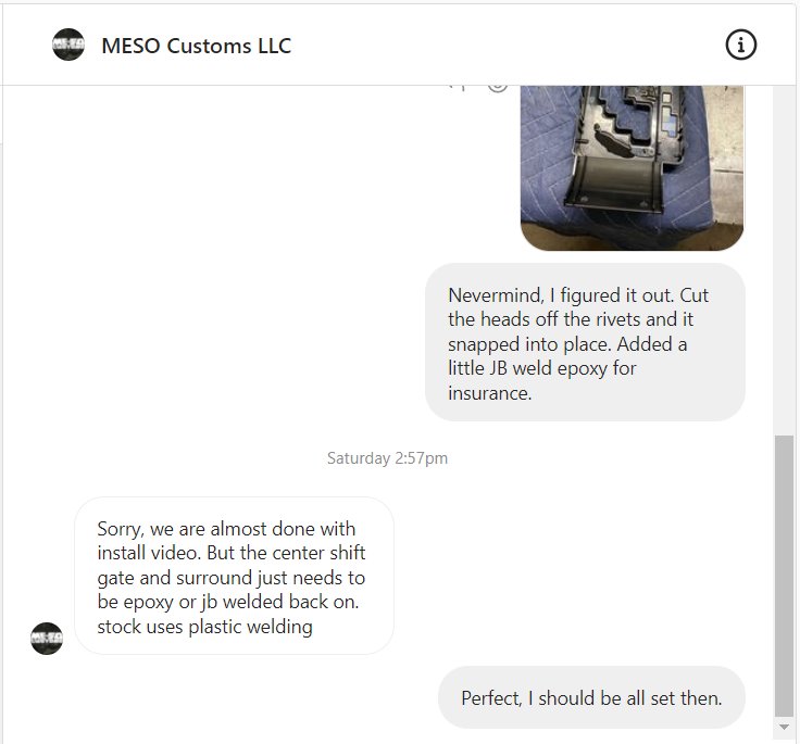

    I reached out to Meso mid install of mine and he was slow to reply but I figured it out. When he eventually got back to me he advised some expoy on both the shift gate trim and the larger trim that encompasses the shifter (The one you drill out spot welds). I didn't expoxy the surround in because it clips in pretty securely but I did put some dabs of it on the shift gate trim since it's fighting gravity.

    You can see why the AJT design one is much easier to install it just pops in. But you still need to take it apart. I emailed meso and the answer was asap for the video and that was about a week ago. Nothing yet. I’m holding off on buying this for now.

    While the AJT shift gate piece is easier since it's an overlay, I wouldn't say that the meso piece is particularly difficult. The longest part was waiting 20 minutes for the epoxy to dry. Getting the shift piece off of the truck, chrome inlay removed and black piece in took all of 10 minutes. All you've got to do to remove the shift piece is gently pry on these clips (two on each side) and it lifts off.

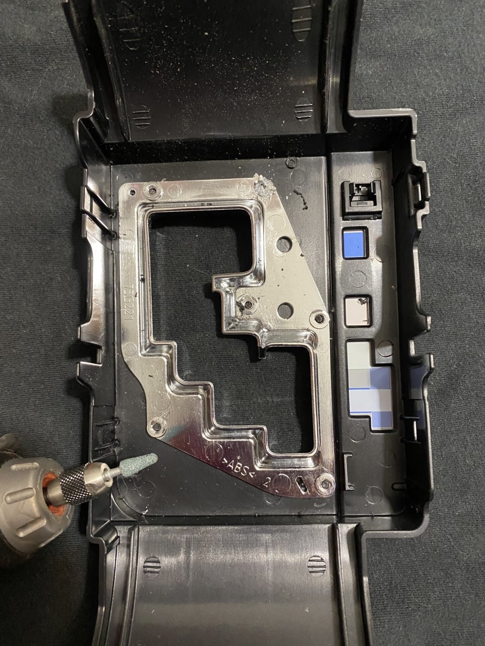

    I keep seeing to drill the plastic welds, but I think using some needle nose pliers and gently twisting off the top of the welds is a much better way to do it. You don't risk drilling too deep and it leaves most of the plastic 'post' in place to align the shift gate part.

    Logically sounds ideal.
    Don't think it would work out that way or as clean. But, I wouldn't mind being proven wrong. The welds are pretty flush so it would be hard to get a grip with needle nose pliers, or have a precise pair of pliers for that application.
    Also, my dremel worked much faster and cleaner than pliers.

    I did exactly that using a tool called flush cuts. Fantastic for precisely cutting small wiring (14 gauge and thinner) and cutting zip ties flush so you don’t stab your self. Took less than 30 seconds to cut all the welds off.

    Thanks for that. I did wonder what you used. I don't have any tools for precise cutting but usually just find a way around it one way or another.
    I also liked that I found another use for my dremel other than trimming my dogs toe nails :anonymous:
