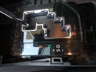

    Ok let me give some advice on this install. As for the shift gate piece, all I did was get an interior trim plastic tool and slide it between the chrome piece and the shifter panel and twist just a little and all the black welds just popped off nice and clean. I didn’t glue new piece in place, when you reinstall it back in truck it stays in with pressure when you clip in the shifter panel back into truck.
    As for the outer trim piece around shifter, I turned the whole panel over and used a 1/4” drill bit. I first took a razor to all the plastic welds to take off the rounded parts and flattened them all out. Then I placed a piece a tape about 1/2” up the bit and drilled very and I mean very slowly. Do not press down. Let the bit do all the work with the weight of the drill. Hold back the drill as much as possible. Once your through all 6 welds, then get a large flat head screw driver and pry the piece out start at each weld. Make sure to bend the tabs off the parts that lock in. Once you break the three welds on one side you can basically grab the panel and slowly break free the other side. Do this slowly.

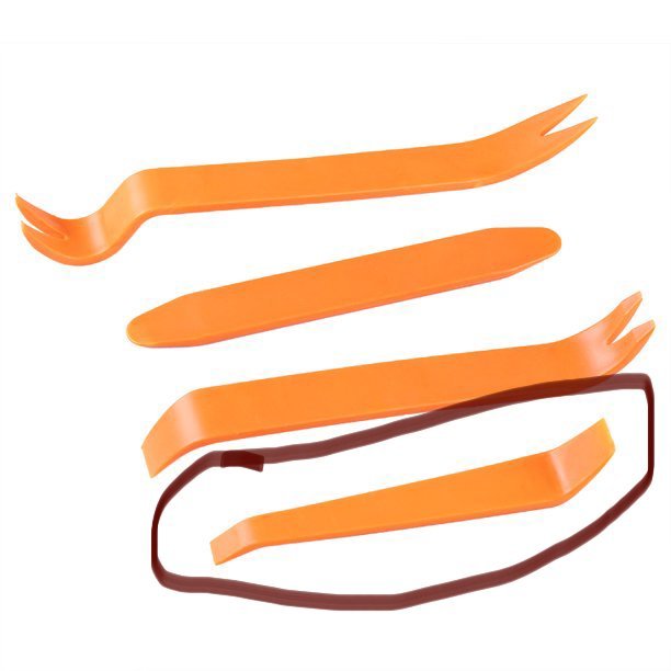

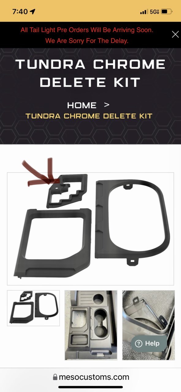

    Can you take a picture of where you inserted the pry tool on the shifter gate replacement?

    Sure, I slid the thin section of the tool under where the arrow is on the part in the picture. I used this tool in 2nd pic and circled it.

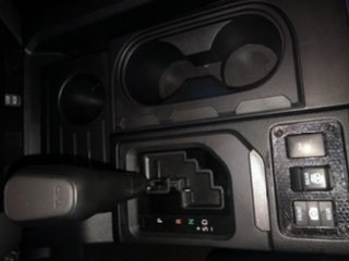

    So do I need to remove anything else before prying? I can’t figure out where to pry up the stock stuff.03C187F0-10C6-4E56-A3E7-52954799B45B.jpg

    Take that off and look on the back you will see. It’s held on with 4 little tabs

    you have the remove that whole black piece with the letters. Be easy with it, it just has a few tabs on each side and comes off real easy. You have to pry from the bottom side.

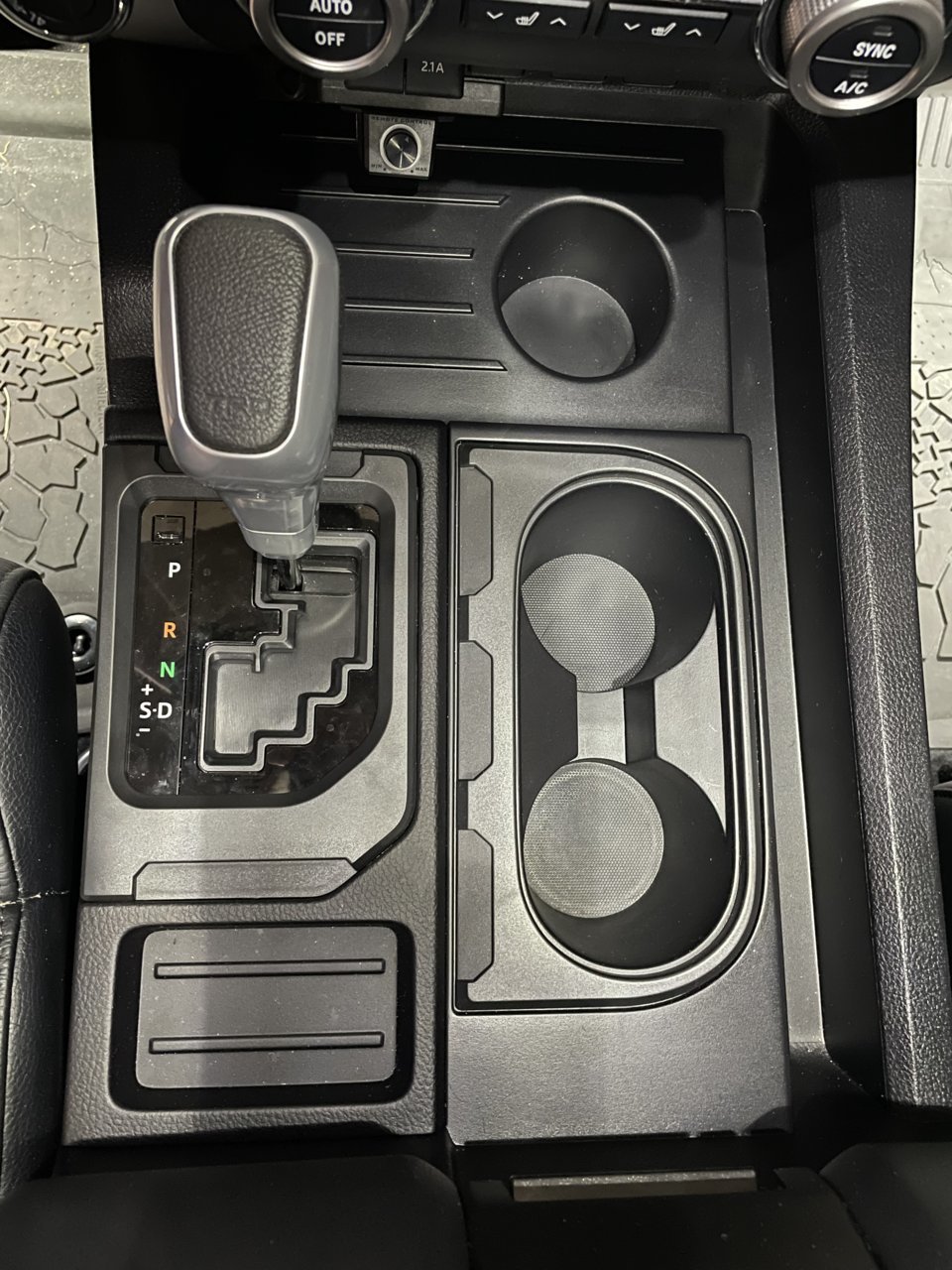

    That’s the step I was missing and was trying to figure out how you popped the chrome piece off. Thank you for all of the help and advice. All finished up. D670FDDE-9AA0-4D6E-AA83-44923EBB22AE.jpg
