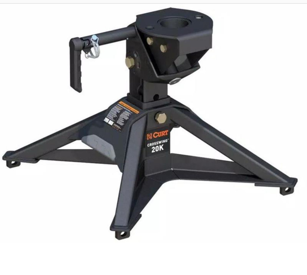

    I need to check this hutch out. I need a hitch for my '21 Crewmax. My present hitch in my '08 double cab is a non slider, can this hitch come with slider assemblies?

    I don’t believe you can get a slider with this style of fifth wheel hitch. Check their website and reach out to customer support which is very good. You may not need a slider because it can be set up to move the fifth wheel back so you may clear the cab.

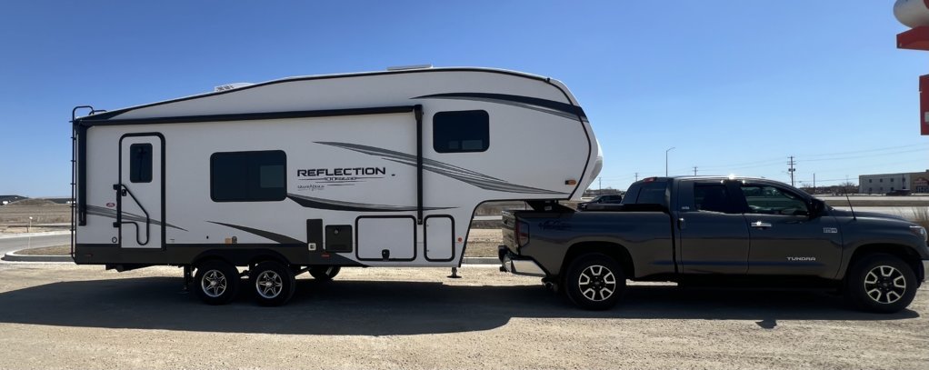

    I pick up the RV this weekend. Probably the worst conditions to be pulling any RV. There was a very strong cross wind but the Tundra handled it without issue. I’ve been planning this RV purchase for about a year so I had time to prepare the truck. Added a rear sway bar, new 10ply tires, installed the hitch and added a set of air bags. When we lowered the weight on the truck I was expecting to have to increase the airbag pressure. I only run them at 10psi. The truck sat perfect. I didn’t have to add any pressure to the bags, I’m thinking I didn’t even need them. The trip home was about a two hour drive and even with the strong crosswind, no issues. I have to set the pin box up one setting to get the RV perfectly level. I did do a braking test and it stopped very similar to my previous bumper pull which was 5,000lbs. The brakes on the Grand Design 22RK just work better. Happy camper.
