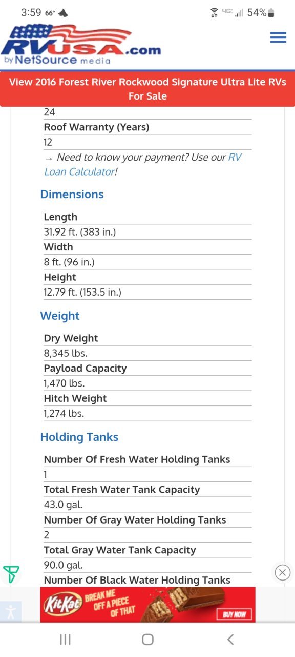

    The truck is not a lux model, it's an SR5 TRD DC with Max payload 1745

    What does the sticker on your door panel say? There’s a good chance it’s less than 1745.

    Pin weight empty-1245
    Trailer empty 8345 lbs x 15.25%=1273 (close enough)
    Camper Payload is 1470 lbs. let’s say they pack light and use a little over half of that weight 750 lbs.
    8345+750=9095 lbs
    9095x15.25%=1387 lbs pin weight.
    1387+100 lbs hitch=1487 lbs pin weight.
    1745 lb payload - 1487 pin weight= 258 lbs.
    Hope they take a crap before leaving and both weigh 129 lbs or less.
    Not likely. Maybe their pin weight is less. Most storage in campers is up front, so it’s not unrealistic to maintain the empty pin weight ratio (more likely would go up)
