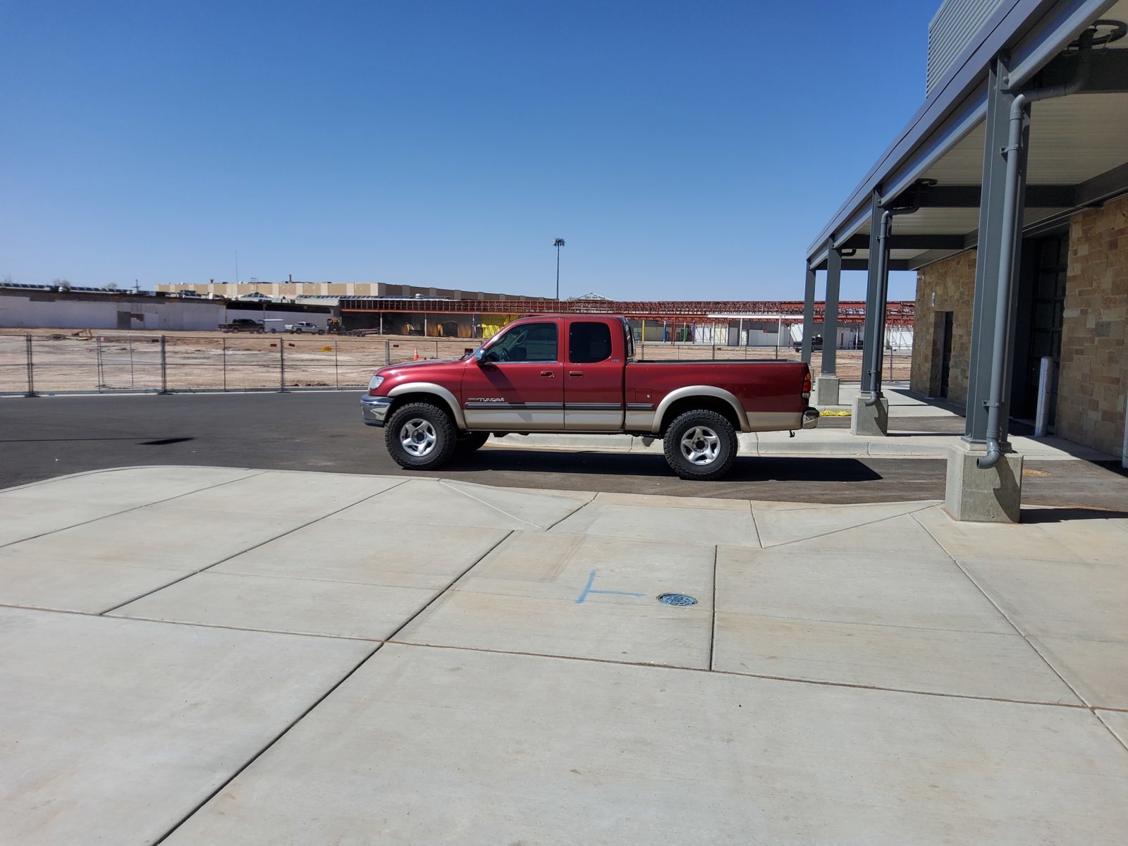

    All I have in that pic is the toytec boss series set at whatever they are out of the box. Nothing in the rear so it sits pretty level.
