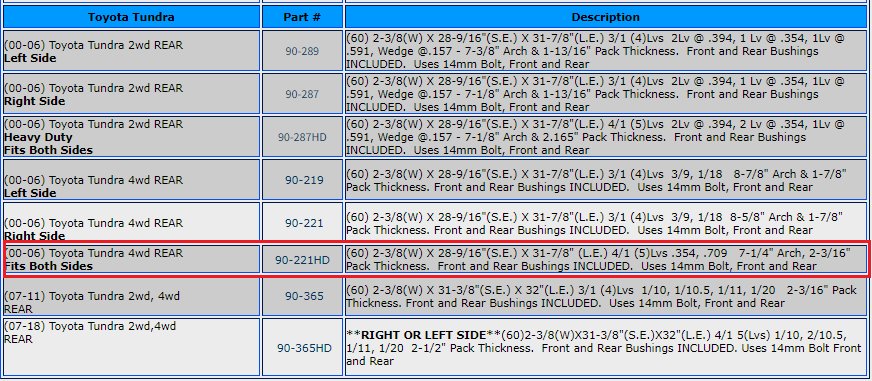

    Shifty, what leaf pack are you referring? I have only seen the $1100 pack and considering I am using my FGT to haul my sled deck and mountain cat the 22 year old springs just aren’t up to the task and why I installed the timbrens.

    See signature. That pack will get you a solid 1.75" - 2", at least if AC/V8/4WD like me.
    EDIT: This is their parts list. Your truck info in your user profile unfortunately doesn't list whether you're 4WD or 2WD so ... different part for each. I got the one boxed in red for my 4WD. Three rows above it is the 2WD p/n but I dunno the difference. You'd need to ask ATS. They're responsive. You'll need new longer U-bolts, they sell those too. Direct link to the 2WD springs is in my signature.

    If that was directed at me, I’m 4 x 4, and I did modify that in my signature
