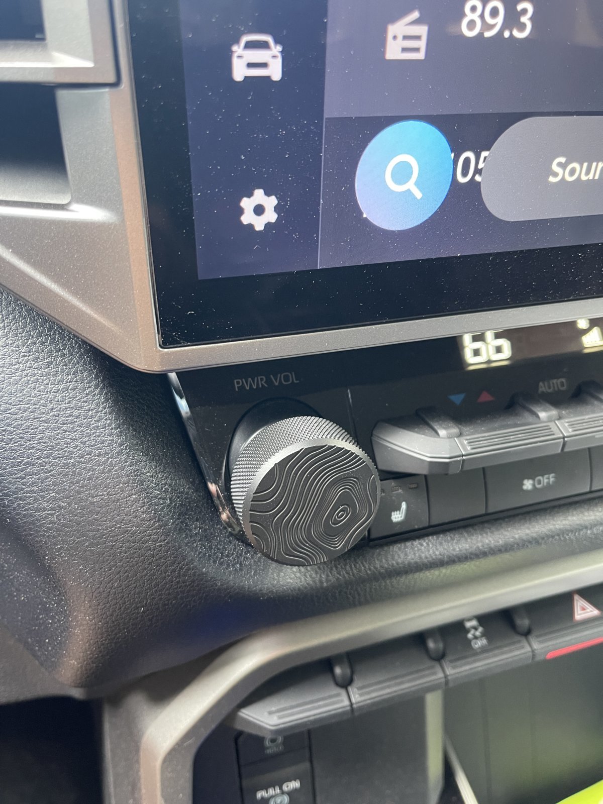

    Hey folks. I thought I would share since I haven't seen this posted on either of the two threads (that I know about) regarding the weak volume knob for the 14" screen.
    I know a lot of folks think AJT is overpriced. If you're looking for another aluminum knob alternative, check out this guy: Toyota Tundra/Sequoia Volume Knobbies - Topographic Map - Mace Manufacturing (macemfg.com).
    It popped up on Reddit last night and thought it was a cool option. Priced kind of between the $20 (plastic?) Amazon knob and the $100 AJT knob.
    However, as a fan and owner of many AJT products, I would be remiss if I didn't point out that AJT has since released a cheaper alternative that is priced at $55 and allows some customization. However, it's currently sold out due to high demand: Radio Knob (2022+ Tundra) - BLACK (ajtdesign-llc.com)
    Sharing in case the weak knob is still a problem with the newer trucks, which I assume it is since AJT seems completely sold out.

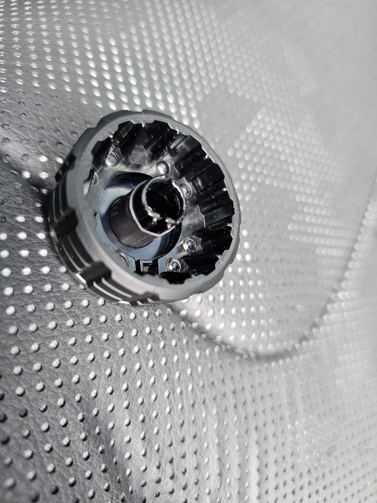

    A quick fix. If you have a .45ACP shell case laying around, cut the end of and slide it over the broken stud. Mine was just cracked. It slides on with a tight enough tolerance that it
    stays and reenforces the post. Could use some glue, but mine is on tight enough that it stays put. The OD doesn't touch the hole it slides into. Was slightly snugger sliding it in place on the dash.

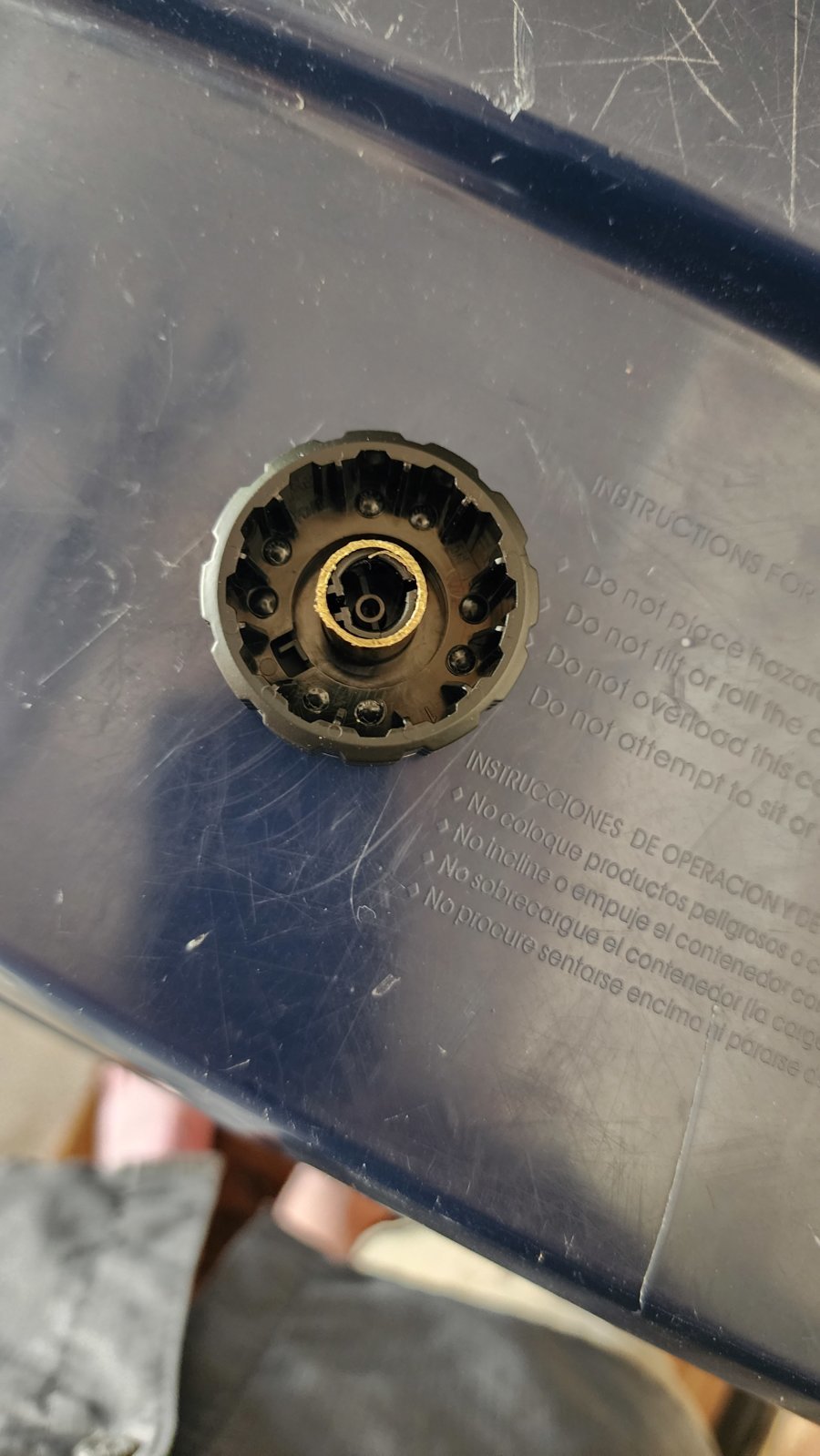

    I just put some heat shrink tubing on to reinforce after my 1st broke.

    The MACE is back in stock today, so I ordered one of those. All metal seems like closure. I also went by my dealership and they ordered an OEM. But those are backordered. I like all the fixes folks have posted, but the plastic knob is so shitty I’m not feeling good about spending time with it. Not feeling real good about ordering the MACE but I’m tired and am caving. Aren’t we all just running around fixing stuff all day every day.

    Upon receiving my 2nd replacement knob from dealer, I took the advice of some and bought the heat shrinking rubber tubing. 1/2" to 1/4" worked perfectly. Tubing multi pack was $2 and the repair took less than 2 minutes including finding the torch, lol.

    I “installed” the MACE knob today. Wow, what a unsatisfying “mod”. Paid $69.95 with tax. Probably reinforcing an OEM replacement with the 3d printed sleeve would last a long time, if one ever arrives. Mine broke way down at the bottom and the sleeve looks like a legit reinforcement along the entire length of their POS design.
    Assuming the MACE knob weighs 1 Oz, roughly comparing the aluminum MACE knob to my TRD aluminum running boards — I thought the running boards were pricey, but they are about $2.80 per oz. Not an apples/apples comparison but I think it’s funny/not funny anyway.

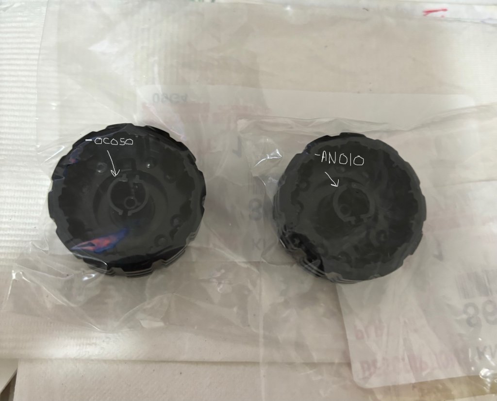

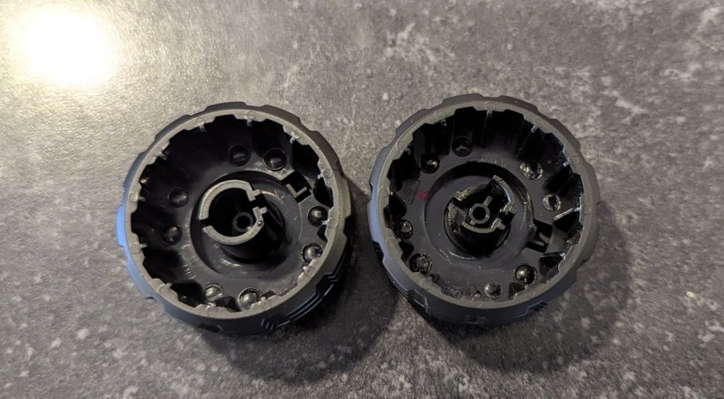

    I believe someone posted on Facebook that there was an "improved" radio knob from Toyota, 86128-AN010, with a "beefer" shaft, to replace the 86128-0C050. I order three of the -AN010 for $8.16 each however, I was received only one -AC010 and two -0C050; you can see the difference on the mounting shafts in the picture.
    However, contacting Toyota Parts I was told that 86128-AN010 was the old number and replaced by 86128-0C050. I doubled checked with my local Toyota Dealer Parts Department and they confirmed the the -0C050 is the replacement for the -AN010. WTF Toyota, the replacement is the weaker version!!!

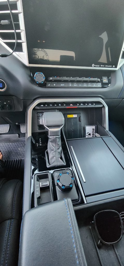

    20240921_065455.jpg I love my AJT Designs knobs.

    Mine broke today, 2023 Capstone, the dealer oil change guys broke it. So the dealer grabbed one off of a 2024 Tundra on the lot. It looks the same but isn't. It doesn't slide all the way on so it wobbles. They have a few replacements coming in tomorrow. I'll go in and see if the are the old or new style. Either way I think i will order after market to save myself from having to replace it again in the future. What a terrible design.
    UPDATE: I went back today and the new one fits perfectly and it is an updated design with a beefier stalk, so we shall see. But I did order one of the ones mentioned earlier in this thread, the $55 dollar one. I'll put that on when it arrives and save the stock one for when i trade this in.

    The one i received today looks like the 86128-AN010. The one that broke off in my truck didn't look like either of those. The one that broke off in mine had 4 flimsy plastic tabs making up the mounting shaft, not the two shown in both of those pictures.

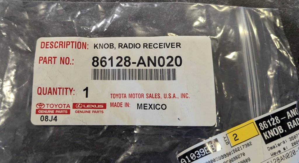

  24. Nov 29, 2024 at 2:32 PM
    #54
    Garand
    Garand New Member
    Aug 12, 2018
    #18050
    86
    2024 TRD OR Limited DC
    285/65R20
    It looks like there is yet a new part number for the replacement radio knob.
    The dealer replaced it under warranty.
    86128-AN020
