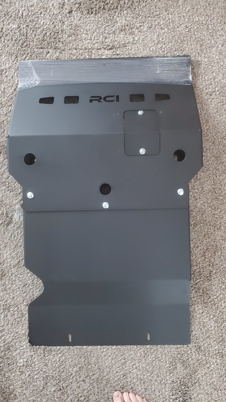

    2017 tundra limited *sold*
    325/60r20 falken at3w, 2.25 dobinsons ,20x9 +20 fuel torque wheels, leer xr100, bmc
    20220305_190145.jpgthis came in today wooot . Also ordered some rocksliders. New tires are next
