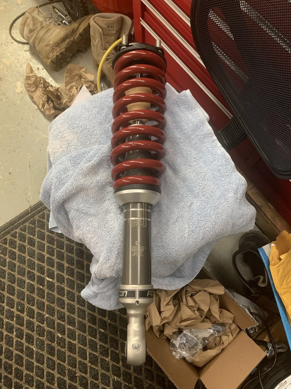

    Falcon Leveling System, Coachbuilder +1s, RCI Skid Plates
    Got the fronts assembled today. It is supposed to rain all weekend and Monday so doubt I will get them on the fronts on this weekend.
    If I can catch a break in the weather I should be able to slap the rears on quickly.
