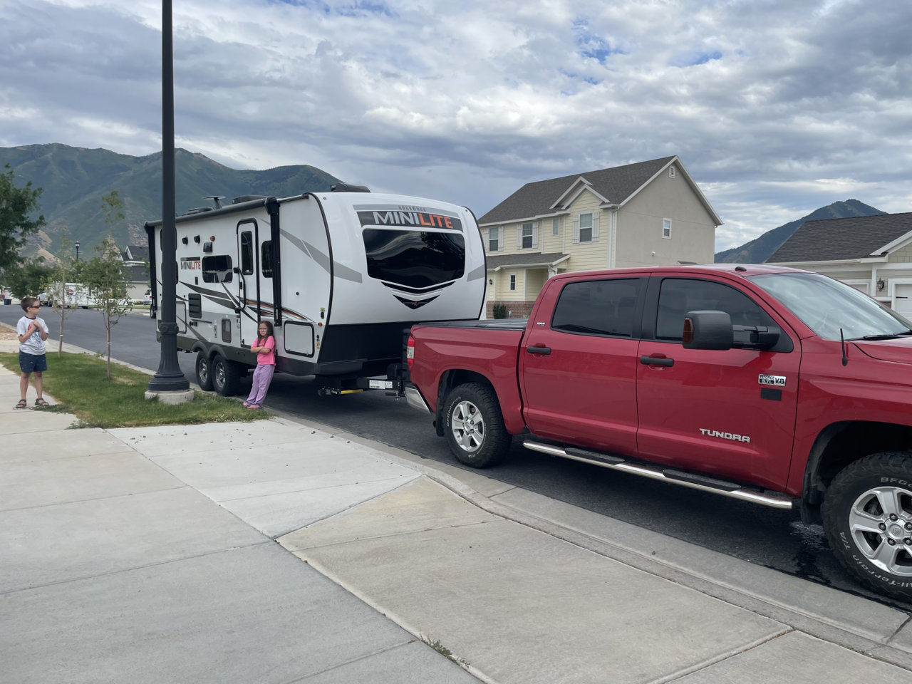

    So, got some travel time finally with our trailer and I have to say the Falcons are awesome, two trips so far. I actually forgot to switch it to "Tow Haul" on the shocks and could feel every bump and jolt twice over. As soon as I threw the switch it was so stable. Freeway driving was great. My first trip with these was actually through Price Canyon Utah. If anyone knows that road, it is terrible, but the Falcons were solid. I have them set at level in front so a bit of squat with the trailer attached.

    Nice! What setting did you go with?
    I just did 3,800 miles towing my boat (roughly 5k lbs) set on the middle setting. Absolutely perfect! Hit a bump or dip and zero drama. Just rebounds and stops. I love these shocks. Mine have been on for almost 2 years now.
    I don't know anything about the road you were on but from Flagstaff to Page AZ has got to be the place where they train road builders to build roads. HORRIBLE! Just random undulations the whole way.
    PS. Red is THE best color.
