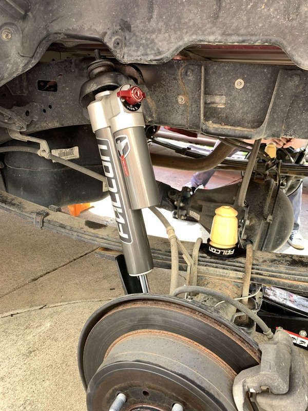

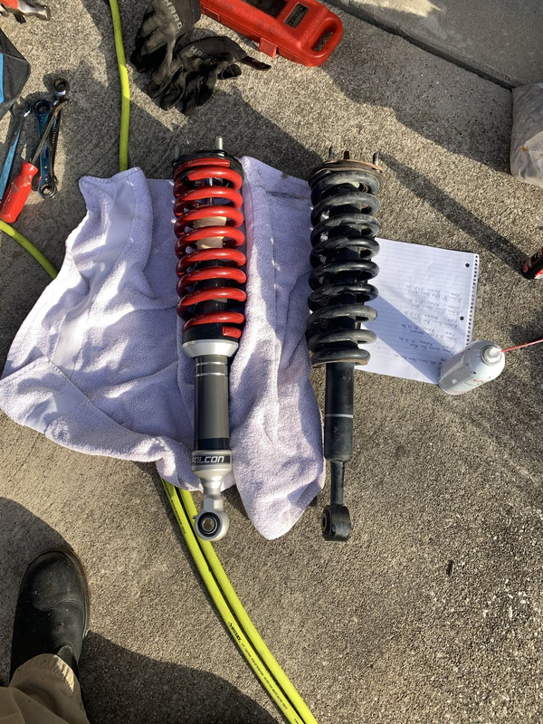

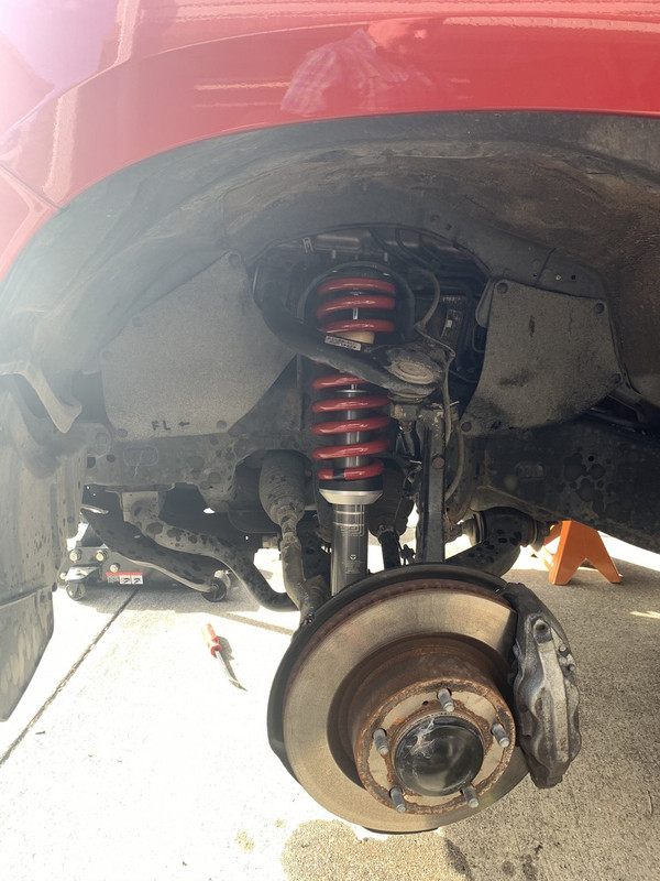

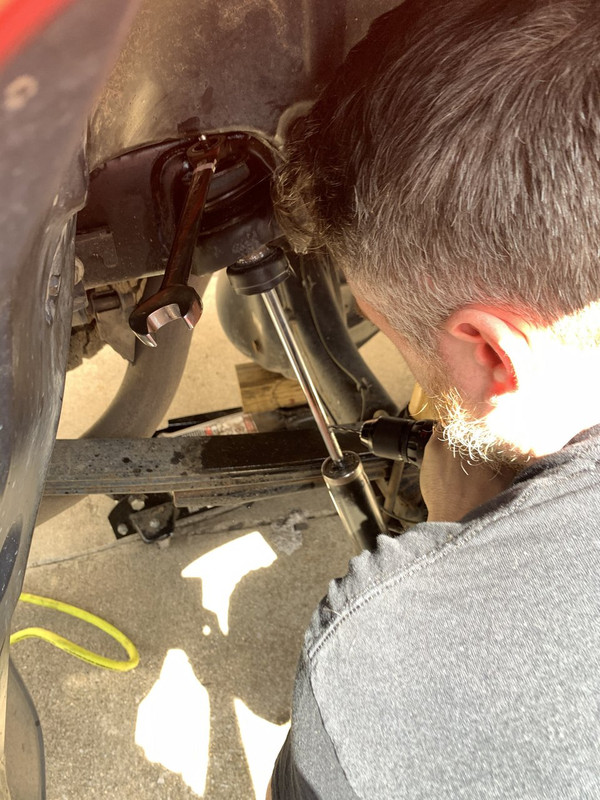

    Well folks today was the day and they are on. As always not without a fight! Fronts went on easy as could be. Rear driver came off and went on without an issue.
    The rear passenger was not going to allow a smooth or quick day!
    The top nut on the factory strut was seized as a mother! We drilled a hole in the shaft put a screw driver through it and still would not budge. Ratchet strapped the screwdriver and vise grips to the leaf spring. Nope, snapped the screw driver. Had to end up cutting the top nut off which is a chore as there is zero room up there. The question was posed to remove the bed but we finally got it.
    We started about 0830 if we had no issue with that top nut we would have been done about noon. But we got done at 2:20 and had to leave to pick up the kiddos at 2:15.
    Wow, is all I can say!!!! The ride on this thing on the road is out standing.
    I did not get a chance to install the diff drop or the sway bar relocation blocks so I’ll do that one night this week before I take it for the alignment.
    Took the boys to Rally’s for some milk shake and they have the worst angled drive thru imaginable. At full lock got some high pitched scraping. And tried not to do that and ended up curbing the wheel pretty good. Ohh, well those will be replaced eventually. Also got the scraping at full lock the other direction so I am hoping that was just the skid plate. I have RCIs to replace the factory so hopefully that will fix it.
    So these shackles sound like an absolute beast in some instances. I think I’ll ask my shop who does my alignments how much for a shackle install. May be well worth it for them to do it.

    Beautiful! Where'd you get the red springs?

    I picked up a set of 3k mile OEM take springs on FB so I would not have to disassemble mine. I had them, my TRD rear sway bar, and SDHQ ABS sensors powder coated burnt brown red. Almost an identical match to the Barcelona Red.
    They don’t shimmer in the sun like the truck does but everything is under the truck so you would never know. Put the chip up to the truck in the shade and it disappears.
