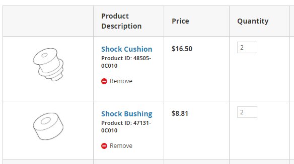

    I have a Coachbuilder +1 arriving today to put on. Figured I would order new shock cushions while I'm working under there. Should have done it before installing the shocks but hey! What I have works fine and the front is at 1/4" lower than the rear. Thinking the Coachbuilder +1 should level the truck with the boat on.

    These part #s are for the rears? You wouldn’t know the part number for the front, would you?
    *edit- I can do my own research..just asking if you already know. Thanks.
