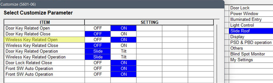

    Update: I was able to have all 5 seat belt chimes turned off, and my windows down from fob added, however the tech said he could not find a setting that allowed windows down without sunroof either opening or tilting… so for now it tilts…
    he also stated that there was no “windows up from fob” option for mine, so maybe it doesn’t exist or at least not for double cabs or certain trims?
    lastly, he confirmed that my truck does not have the fake engine sound, so that also seems to be a CM only deal…

    Tell him to look here(see image below) and set position #3(highlighted) to OFF.
    This prevents the sunroof from either sliding or opening with wireless remote.
    I don't see this option in TS ver16 or ver17 for my truck as well (Platinum crewcab).

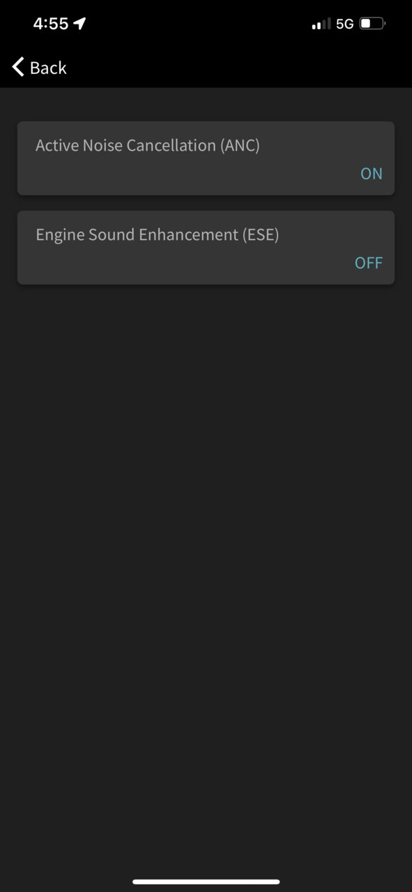

    Carista app lets you disable it
  27. Jul 11, 2022 at 5:38 PM
    #117
    xc_tc
    xc_tc New Member
    Dec 28, 2021
    #72329
    895

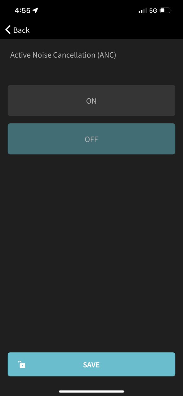

    You don’t want to disable ANC though. That’s active noise cancelling and will make the cabin quieter.

    Wrong photo, but did play with that a bit and it makes a big difference around town
