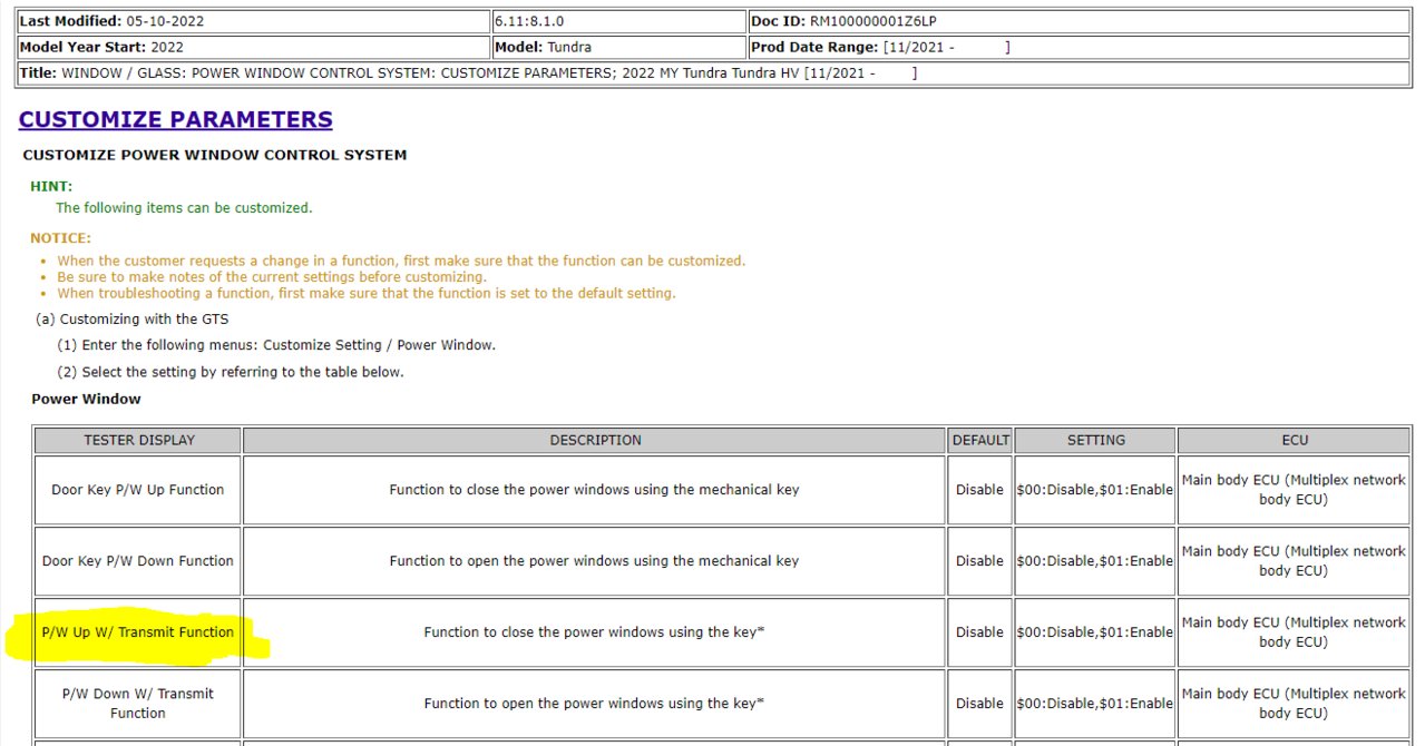

    Sorry for general lack of reply to this thread (despite promising to do so).
    Been busy, but more importantly...all my TS work has thus far been done with ver.1.4.8 of USB->ODB2 interface.
    I am/was wondering if there is a difference in options displayed with a newer version (2.0.something).
    So, while all the info I have is valid for 1.4.8 VIM., I am waiting for my 2.0 version cable to be delivered today.
    I will reconfig my TS for that, and verify if all I see now is exactly the same with the newer interface.
    I was planning to make a new TeachStream general/specific thread in the future, and still may, just so we all have 1 place to go for all TS-related things, but for now, here's what is possible to change in TS ver.17.0 (latest), with 1.4.8 VIM:
    (note the highlighted selection, and the lack of option for P/W up with transmit)
  12. Jun 16, 2022 at 11:54 AM
    #72
    jmay86
    jmay86 New Member
    May 28, 2022
    #78895
    403
    Josh
    Columbus, Ohio
    '22 Lunar Rock LTD DC TRD-OR
    Appreciate the update! I will be sure to ask the Tech guy tomorrow for the P/W Up feature and report back if they do or do not see it.
    Also, I assume all of those Auto Up/Down functions are ON from the factory, right?
  13. Jun 16, 2022 at 12:20 PM
    #73
    99ways2die
    99ways2die New Member
    Mar 30, 2018
    #14012
    671
    NJ
    2022 Tundra Platinum
    Correct; only the highlighted selection was "disabled" by default before my changes.
    -99

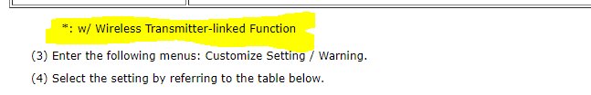

    Additionally,
    If you are asking them to enable "P/W down with transmit" then consider whether or not you want the sunroof to open with them.
    It is a separate, and configurable option.
    (I chose to disable mine; don't want sunroof opening with windows down...as I'll usually roll all my windows down with remote when its really hot, then once I get in the truck I'd most likely end up having to close the sunroof and rolling the cover back up...thus kind of defeating the usefulness of that particular feature).
    **In the even of rolling down my windows by mistake and/or not knowing about it, then having it rain...I'd rather have only windows rolled down, and not the sunroof!
    And now we know why this isn't enabled for everyone by default; just imagine the claims against Toyota ("I didn't know it would roll the sunroof/windows down when my dog sat on the remote, and it rained for 10hrs after!!")
    -99
    Mine is set to "close" despite of the screen shot below showing "ON - I took the creen shot before I disabled it. (highlighted selection)
