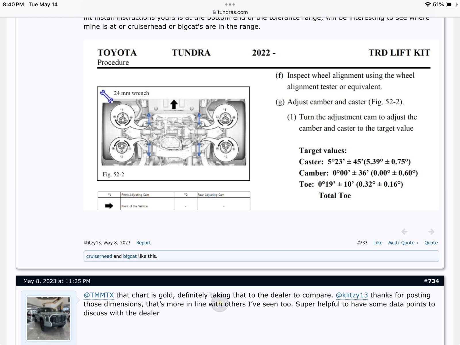

    I have a 23 Platinum with dealer-installed TRD 3" lift kit on 285/ 65 BFG KO2 stock rims and at full lock my swaybar rubs.
    I really don't want spidertrax spacers.
    Will the ICON 1" sway bar bracket blocks work? Will trying to get the truck aligned to the factory spec for the lift kit work? Here it is:
