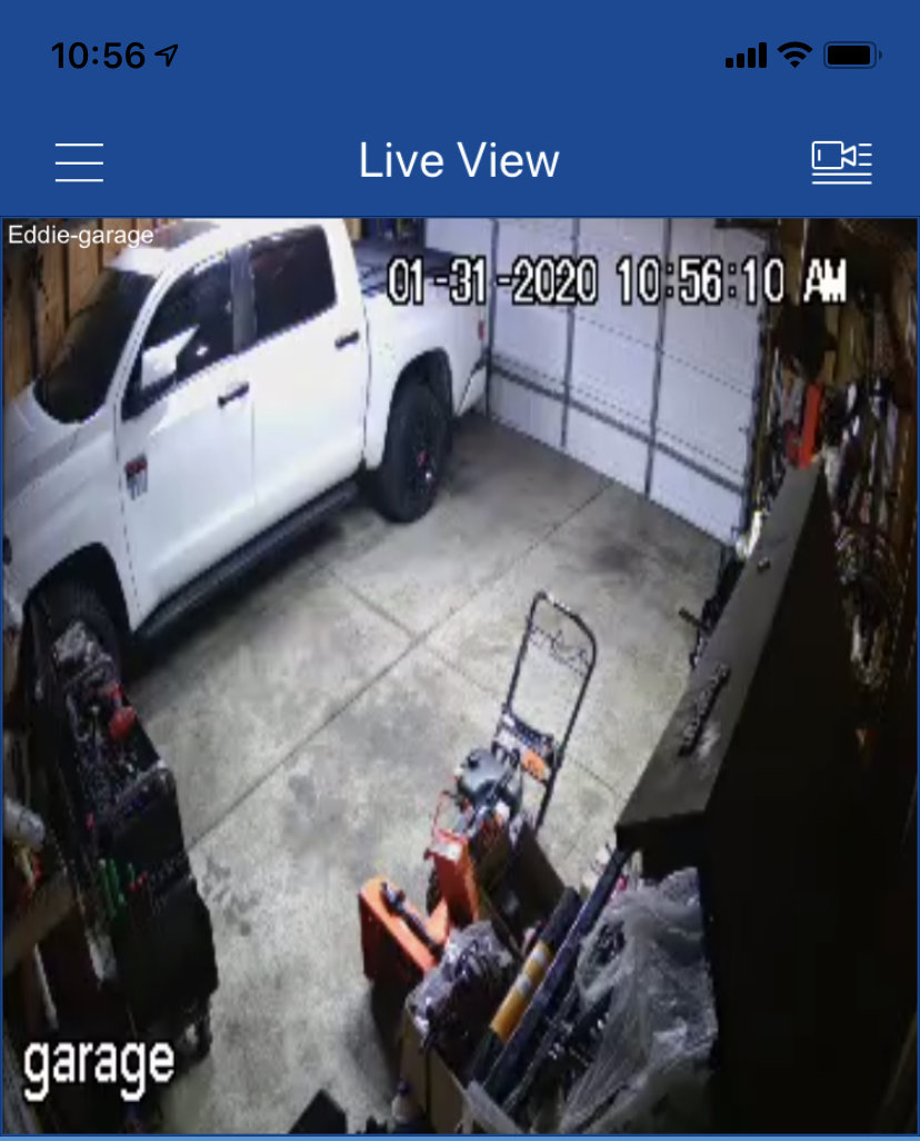

  19. Jan 29, 2020 at 7:13 PM
    #49
    773_eddie
    773_eddie Trd Pro
    Feb 17, 2019
    #26204
    661
    Eddie
    Chicago
    Tundra Trd Pro
    12volt remote start, weathertec accessories, Trd Pro decals, Toyota console safe,VLEDS Puddle Lights,Frac Harness,TRD PRO front and Rear Sway Bar,NSV Hood Light Bar,ESP long box,AJT accessories,Thinkware U1000 dashcam, coachbuilder 1/3 Lift, HR LED’s,Pro comp Traction bars, JL complete System wit 2 10” subs, Kenwood DDX9907XR HU
    I have a 19 pro in white with 6500 miles and when detailing it I have notice a couple of what I would call like spider webs or stretch marks it’s weird never seen that on paint b4 it’s minor you have to really look at it close to see them

  27. Jan 31, 2020 at 8:53 AM
    #57
    773_eddie
    773_eddie Trd Pro
    Feb 17, 2019
    #26204
    661
    Eddie
    Chicago
    Tundra Trd Pro
    No dents anywhere and I don’t drive it in bad weather stays in the garage never been hailed on didn’t hail in chicago since I bought it in Jan of 19 and I only got cought in 1 snow fall rare late March of 19 other than that always been in the garage nice and clean
