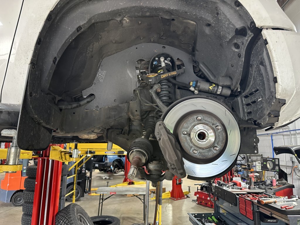

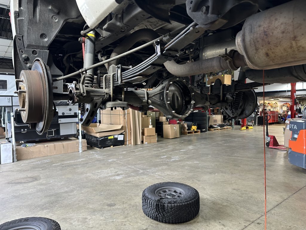

    Truck is finally under the knife. Let’s see if these Amazon gears and eBay Powertrax are any good!

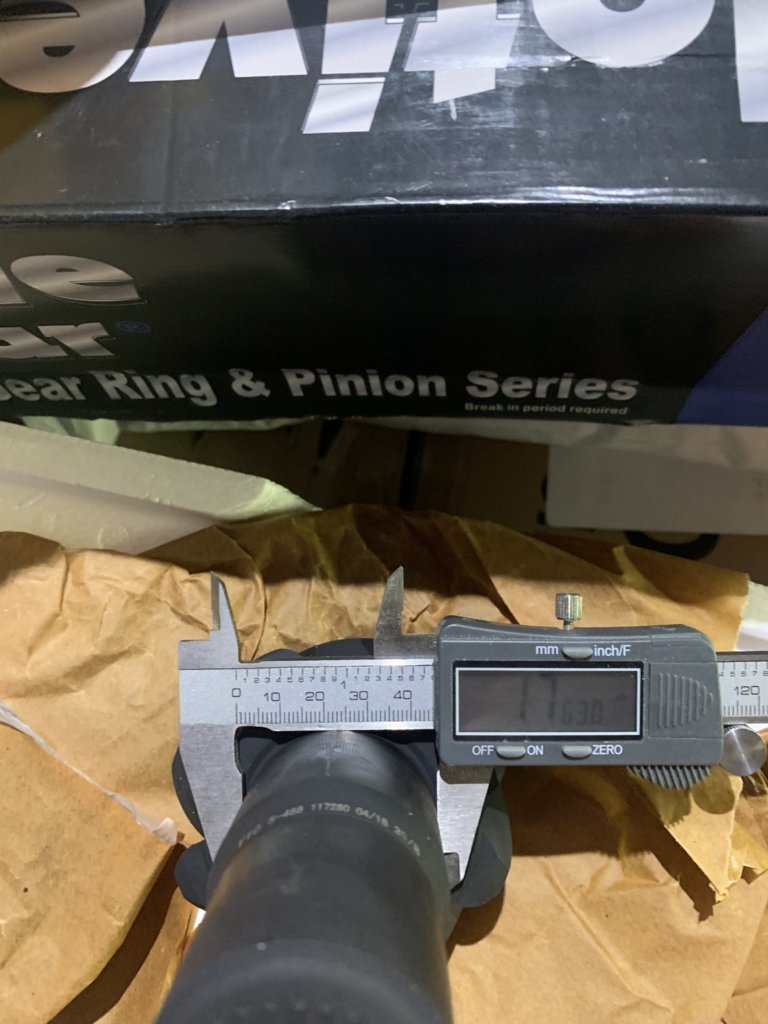

    For giggles I pulled out my motive gear pinion to mic it, then compared it to the Nitro gear set next to it. I compared the larger bearing diameter but suppose I could check the smaller bearing as well.
    Motive - 1.763”
    Nitro - 1.768”
    Maybe 5 thou is enough to loosen up a press fit, but I wouldn’t think so..?

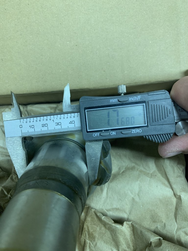

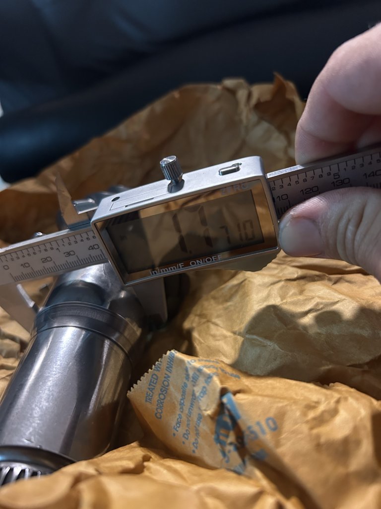

    Granted these aren’t really outside mics, just shitty Chinese calipers we are using, but my rear motive measures 1.771”

    Just measured my nitro kit Koyo bearing race diameter and it’s 1.7370 vs the pinion 1.7710.
    1.7710-1.7370 =0.034 interference. Sounds like a tight interference fit to me. Pinion is definitely larger than the bearing. By that measurement almost too large I’d think. Like I said though, using shitty calipers.
