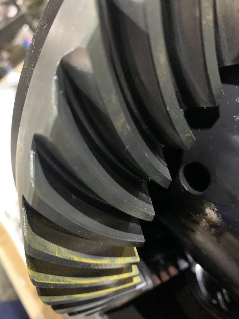

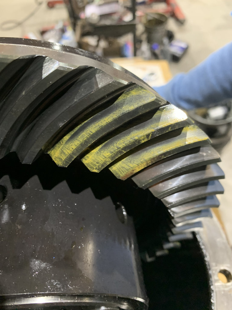

    Bearings finally showed up yesterday. We were able to setup the factory gears with the new Speedmaster. Owing to reusing the factory gears, we were able to reuse the factory shims all around! So machining tolerances on the Speedmaster look to be pretty good (same with the Auburn it replaced). We marked the pattern, for which my buddy was kind enough to give me a little education.
    Compared to what you would find in a manual, the pattern looked a little narrow to me, so I asked him about it. He noted that because the gears are used gears, they are going to mark differently than a new set. The wear is concentrated more on the middle of the tooth (an indication that he set them up correctly 140k miles ago as well!) and actually forms a little bit of a scallop or rut on the teeth - a virtually microscopic rut that you can see with your marking compound but can't feel with your fingernail or hands. This leads to a smaller wear pattern when setting up the gears again.
    The important part is WHERE the pattern in marking - middle of the tooth is perfect, depth wise (or laterally oriented with the axle shafts, if that makes sense). Due to the way the gears mesh and basically roll - being hypoid gears and not straight cut gears - the pattern will roll off the outside edge of the tooth, but shouldn't mark too far inside the tooth (toward the center of the carrier). I checked the marking on the pinion gear and it had polished itself on the center of the teeth, but you could see unpolished material on the other edges of the tooth, indicating a good centering and alignment with the ring.
    Hopefully that's helpful if you need to setup your gears after initial break-in as the pattern can change a little bit from what you'd see with brand new gears.
    Oh, and he harped about Maintenance! Maintenance! Maintenance! He was truly impressed with the condition of the gears and differential case, attributing it 100% to me changing the oil often. So pat on the back for me :)

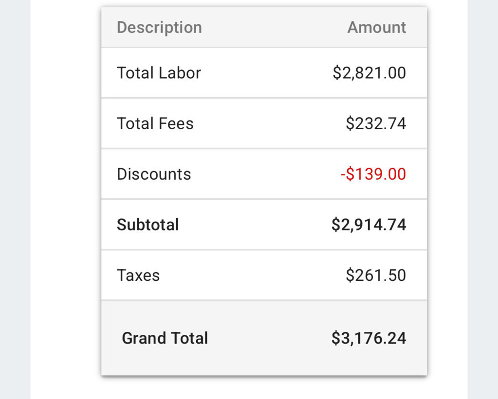

    Got my estimate from Outlaw Nashville.
    Seems high to me. Gonna shop around.
    This is to install front and rear Motive gears with the Yukon install kits and speedmaster limited slip in the rear—all customer supplied.
  18. Feb 11, 2025 at 1:37 PM
    #648
    bflooks
    bflooks New Member
    May 9, 2020
    #46273
    2,374
    Metrowest MA
    That's just labor? I paid right around $2k even for labor up here in MA. I supplied the gears and install kits.
  19. Feb 11, 2025 at 2:00 PM
    #649
    Terndrerrr
    Terndrerrr 923000 miles to go
    Jul 8, 2019
    #32965
    6,217
    Music City
    6UR-FE
    Yep. That line “total fees” is other unspecified stuff, probably mostly gear oil :notsure:
    The discount is for the free 500-mile gear inspection and refill of gear oil.
  20. Feb 11, 2025 at 4:15 PM
    #650

    The labor quote is for 18 hours of labor @ $149/hr.
    And they said the 500-mile check up includes:
    • drain of differentials
    • remeasure of backlash
    • refill of differentials
    That doesn’t really specify if they pull the rear diff, though.
    Also included in the quote was another approve or decline job for an 8” readylift (lol) @ $5700 plus tax and a cab mount relocation @ $1100. :laugh:
