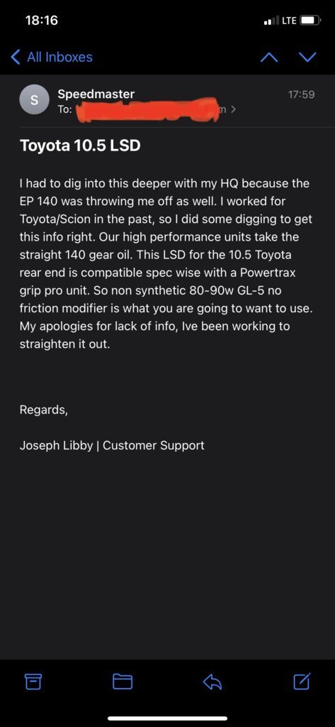

    Heard back from Speedmaster concerning gear oil. Here is their response:
    Mdl, Abell207, Silver17[OP] and 2 others like this.

    That’s good to know for those with the speedmaster, especially since I’ve read some say the 5.29s are more likely to make noise with the thicker oil. I think the speedmaster and powertrax are very similar units. I know there was speculation they had different number of gears, powertrax 3 and speedmaster 6 but as it turns out they both have 6.

    Well damn.. already have the 85w-140.

    I doubt you will have an issue running it in warmer climates. Maybe get some extra grippiness from it. But I guess you will have to run it and see, then tell us how awesome the Speedmaster is :)

    That is interesting they stated 3 different gear oil weights on different emails with the same guy. Good he kept digging into it!
    But like with the powertrax using a lighter oil will just reduce the response and be better for those in cold climates. @Lemuel1 has running it with 80/90 and reported no issues.

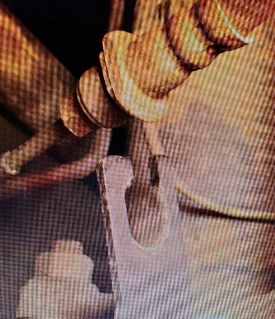

    You can notch the hard line so you can pull it out. Take the e brake cable support bolt out and you have about 10 inches to pull out. No need to take rotors off. Clean up where the o ring sits for a good seal. I've reused mine twice so far, no issues. I did this when I replaced my rear axle bearings.

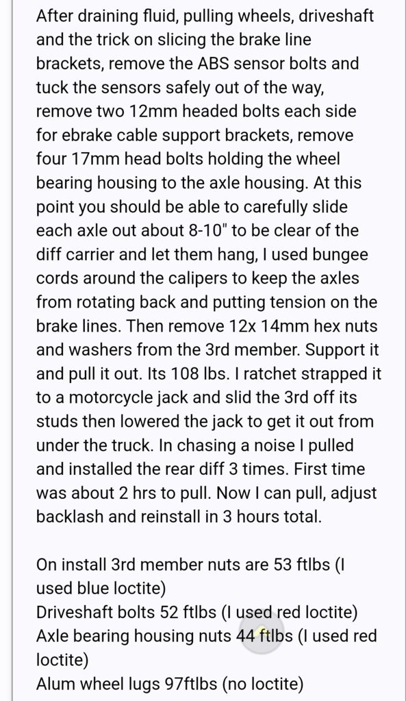

    Here is an excerpt from the DIY re-gear sticky in performance threads. One thing is don't let it rotate as it can mess up the brake line. I used long zip ties through the axle bolt hole to the notched brake line support. I left enough slack to get 10 inches so they clear the carrier.

    Funny thing - the box itself clearly started straight 140. But as you suspect, I’m sure it will work with various weights to varying degrees of lockup. I was trying really hard to convince myself that straight 140 would play nice with sub freezing temps..
    We notched the bracket the same way. Works great. Glad you got a pic of it and posted about it.

    I got that pic from a write up back in 2012 on tundratalk when I needed to do my rear axle bearing. I try to download tech write ups as it save time over the factory how to's...
