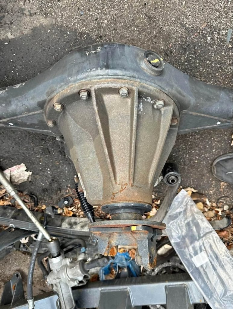

    Is it worth buying a spare carrier and have it regeard? I found a local one for pretty cheap just not sure what to look for and see if it would work for my truck.

    If it's a good deal. They demand top dollar in certain areas. Looks to be an 2009 and you'll most likely replace bearings and seals.

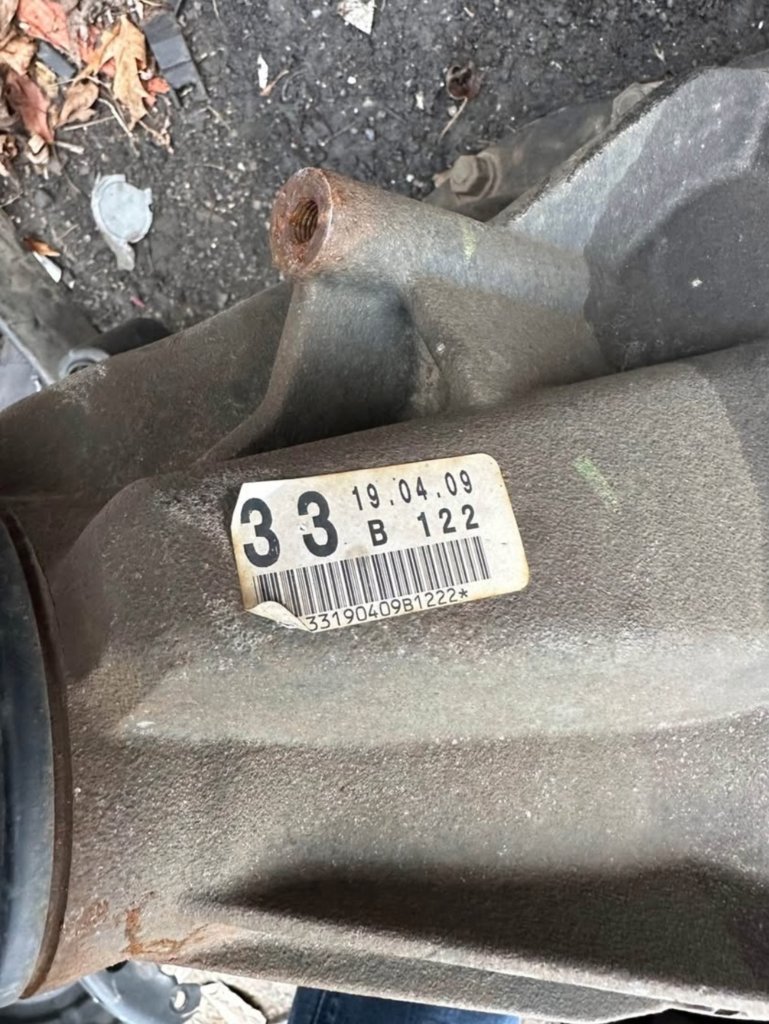

    Guy says it's a 2019 Like the stickers says 19-04-09. Ethier way if i do mine i was going to have it fully rebuilt.

    How could I tell if it's a 10.5?

    I believe group 33 is 10.5. The number under the scan code is the same iteration of the numbers above. Does he have the Vin code to see if its 4.10 or 4.30.
