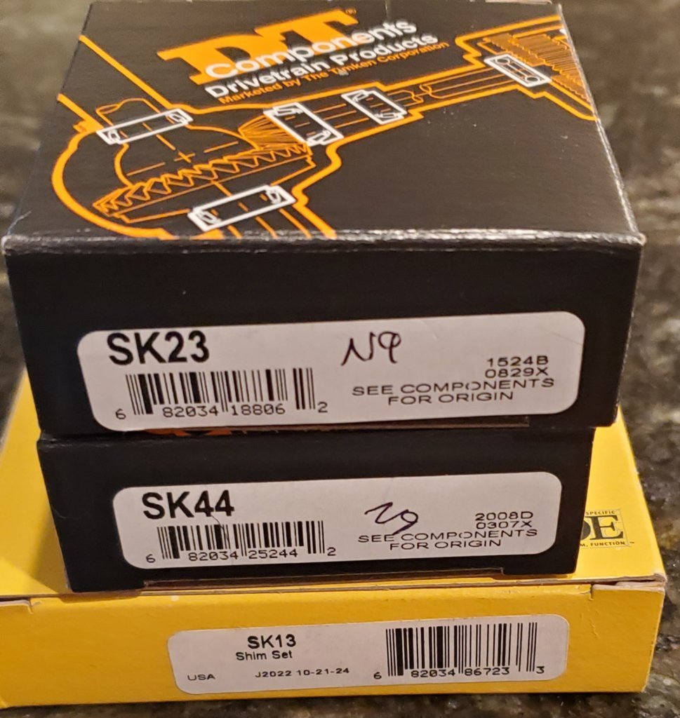

    I ordered a Timken bearing kit for the rear. Got a good deal only it did not come with the shim kit. I spoke with Motive and confirmed the shims that come in their kit. Rear shims are SK44, SK23 and SK13. A front GM 9.5 shim kit works for the Toyota 9 IFS which include SK47 and SK13. I ordered the shims through Drivetrain America.
    I'll confirm once the shims arrive. Also Dana 44 rear shim kit Motive 1115 works too. This is according to what is included in Motive and Yukon kits.

    Do you have the details on the part numbers and good place to buy the necessary Toyota seals as opposed to the ones in the master kits?
    Also, just looked at my front Yukon kit and it uses Nachi bearings that are made in Japan. Not sure how they are. I’ve used Nachi bearings before in large electric motors at work but this is a whole different application. Hoping they are of similar quality to Koyo or Timken…

    Nachi Are good bearings. Guess they say "all japanese bearings are good".
    Rockauto substituted a BCA bearing kit for the Timken I planned on. 2 pinion bearings are Koyo an carrier are NSK. Which I'm happy with.
    I only ordered front/rear pinion seals and front drivers side from fred anderson with the sale. My local Toyota parts has some shims and seals if I need them. Deciding on Toyota fipg or that right stuff by permatex?
