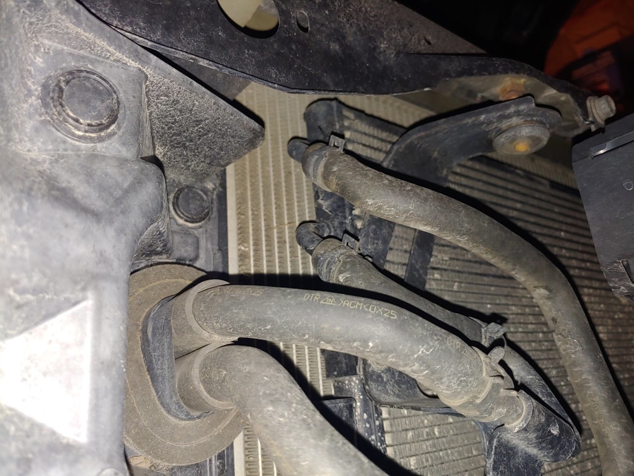

    Getting ready to rock and roll...im assuming I hook up to the top line to drain? Thanks!

    Oooookkkaaayyy, well, as usual that took forever. The video in my first post is a great place to start, however, I had to do a couple of things just a little different:
    1. Screw that stupid 5/8" fill line, just use 1/2" line for both draining and filling...I could not for the life of me get the stupid effing 5/8" line to fit into the fill hole on the transmission, 1/2" went in perfect. 12' total of 1/2" ID tubing would be plenty for this job.
    2. It took a little for me to figure out where to hook my drain tube on the front of the truck since I have to tow package. See picture below with arrow, maybe this will help someone in the future. This is the very front of the radiator super easy to get to.
    3. I followed the directions on the final drain/fill from the video on my first post, before you do the quantity level check using the stupid paperclip, and after filling until fluid comes out of quantity level check bolt it wasn't for whatever reason nearly enough when it came to stupid paperclip time. I had to add another 1.5 qts (I ended up throwing some liquimoly in there too, hopefully my transmission likes it...my wallet doesn't).
    4. As with above, 12 qts isn't enough, you definitely want to have 13-14 qts (I ended up using 13--thankfully ACE near me had AMSOIL transmission fluid, hopefully it plays nice with the liquimoly and the other overpriced Toyota WS fluid).
    5. For whatever reason, my back hurts.

    That's quite the knowledge bomb!! I didn't drop the pan, as I've read that the bolts like to break when taking them off.
    I'll do another flush in 30K, because I hate myself. I plan on hitting the bolts with some PB Blaster a week before, then attempting to get the pan bolts off. I may even order new bolts beforehand just in case I get to drill bolts out.

    It was making sense to me up to the part about lifting old deposits off the magnets :confused:

    my interpretation of that was that the high detergents kinda dissolve the gunk and sediments and distributed back into the suspension mixture.

    My take on his statement is that a "Flush" might wash the collected metals off of the magnets and allow them to get to the internals. I would never do a "Flush" without dropping the pan, cleaning the magnets, changing the strainer, o-ring, and pan gasket. Along with the two crush washers and possibly the fill plug o-ring.
