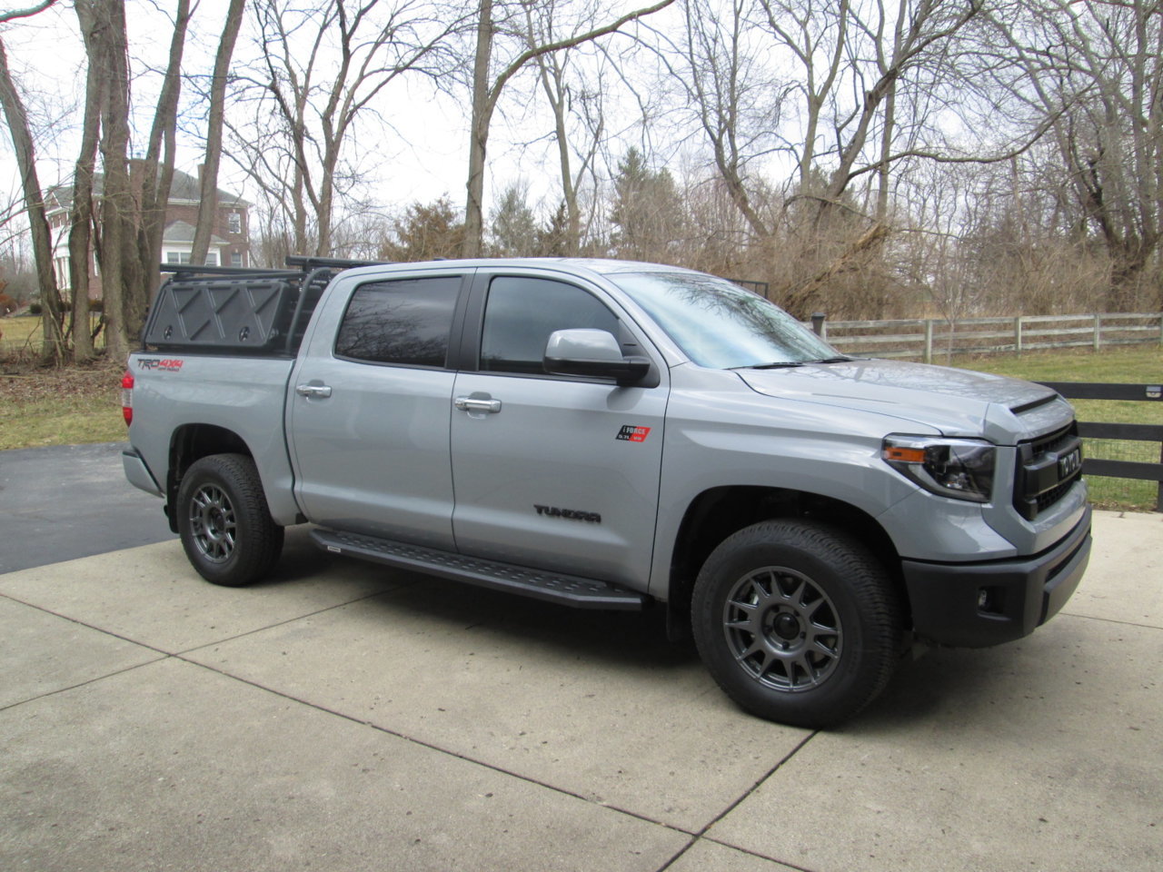

    18x9 +25 offset. Factory sized tires no rubbing whatsoever. Icon Compression wheels

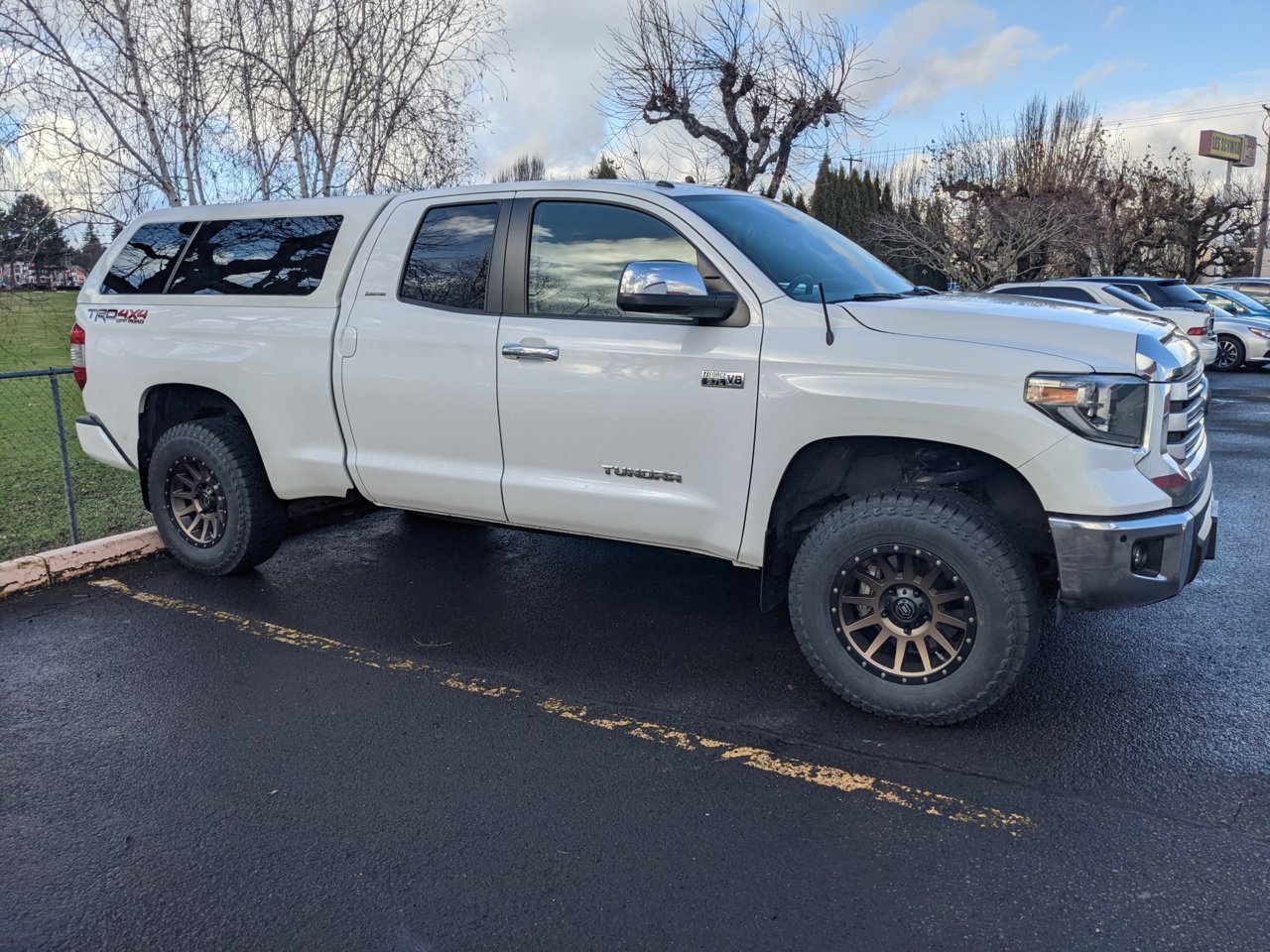

    Got mine on today. Pretty pleased. Chipping away at the things I want to do with the truck. Had a little rub and removed the front little flap assuming that will take care of it.

    I have 275/70 18. I had stepped up to those on my stock rims. Didn't have any rub on the stock, but the offset change did it on these.

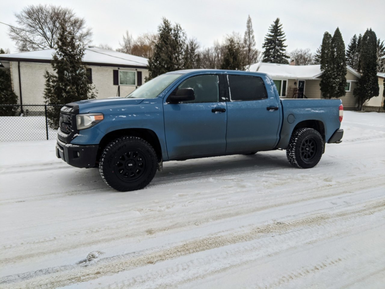

    I'll close my loop too. I went with Black Rhino Stadium on 275/70/18 tires.
    Like you...I'm waiting on my suspension. Hopefully in the spring.
