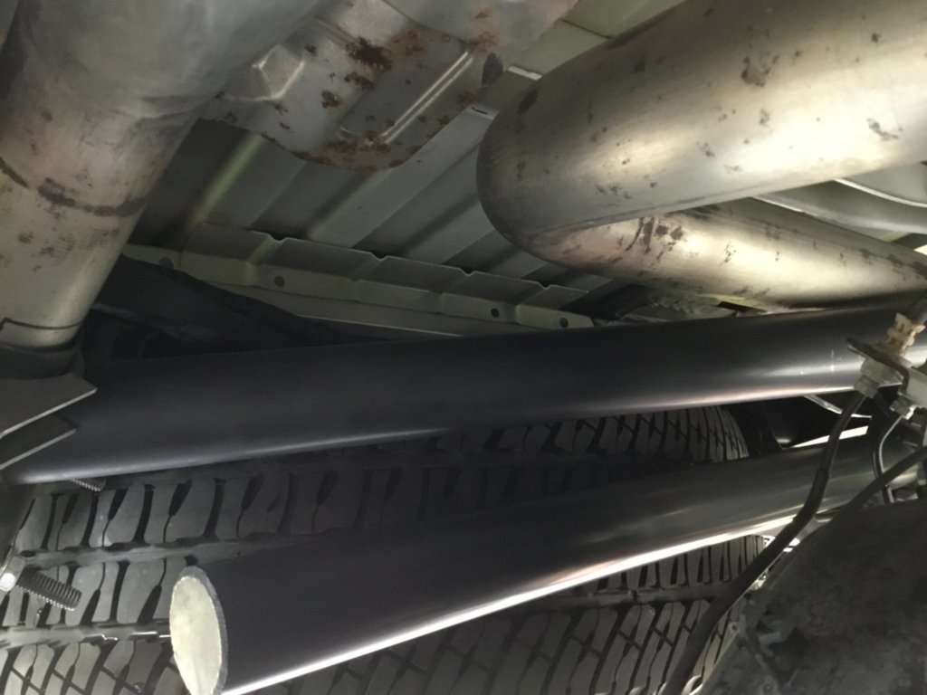

    I used 2 of the resonators on a 2018 with TRD exhaust. I don’t know if the tailpipes are routed the same as your 2009. They crisscross each other. Picture gives you an idea.
    Worked well on canceling drone, but not cheap. It will temper the exhaust sound too.

    Way cool, thanks for sharing. I always wondered if you could put 2 resonators on the TRD dual exhaust.

    You can, but the driver’s side has a slightly different angle than the passenger side. I had to buy them as a TRD specific pair from Keith.

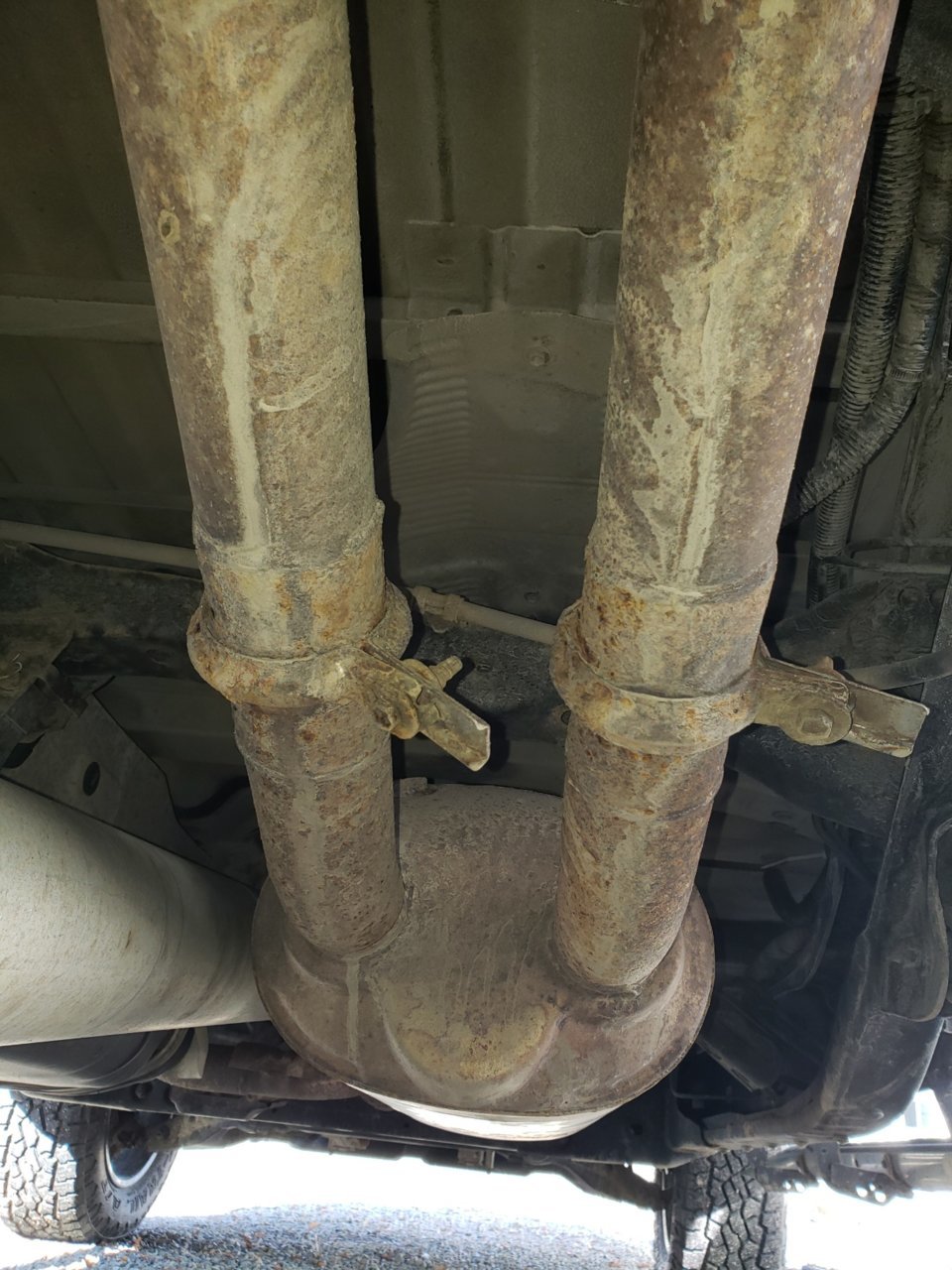

  13. Mar 6, 2022 at 6:50 AM
    MoToad
    MoToad [OP] New Member
    Dec 29, 2021
    #72385
    56
    Toad
    BC Kanuckistan
    2009 Tundra DLX
    OK. Ignore this. I am now understanding the Helmholtz concept of an enclosed pipe. Snow is melting away and will get under the truck today to get some picks of my exhaust setup.
    Here's a pic of the twin tail pipes coming out of the muffler and turning left and right at the spare.
  14. Mar 7, 2022 at 8:01 AM
    MoToad
    Dec 29, 2021
    #72385
    56
    Toad
    BC Kanuckistan
    2009 Tundra DLX
    It's a pissoff I feel the need to deal with this (it's pretty damn loud). I have owned both an F250 Turbo Diesel and a Ram 1500 Hemi and never had this.

    Drone is a reality of these V8s and dual exhausts make it worse. Find a stock single out 2007-2013 exhaust system - they're laying around everywhere and so worthless that someone might even pay you to take it away. At some point (I think 2014) Toyota shortened the mufflers and the stock trucks got louder - all I know is my Dad's 2010 is much quieter than my 2021. I bought the resonator for mine because it droned at 1500-1700 RPM and I hated it. The overall quality of the truck feels much higher now because it eliminates the vibration you feel from the drone.
    The resonator will solve your problem, but the cost is significant.

    This guy explains it.
    NoDrone Resonators from Synapse Engineering - YouTube
    He says the length determines the RPMs it covers. He did not say wether a short piece covers lower or higher drone. Mine is the typical 1800 to 2500 range. I finally got to the front of the truck this morning to find that my twin exhausts run into one muffler at the front. So, I guess I would need two. He also said that the farther forward the more cancellation you get.
