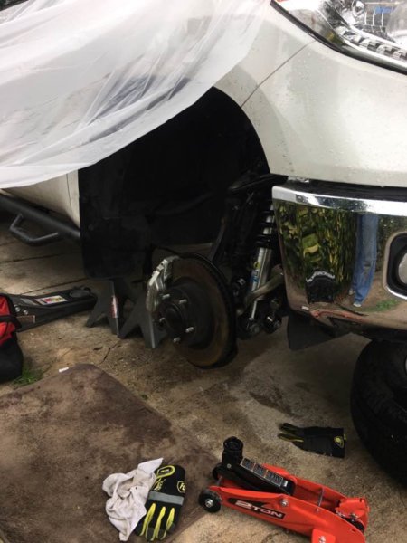

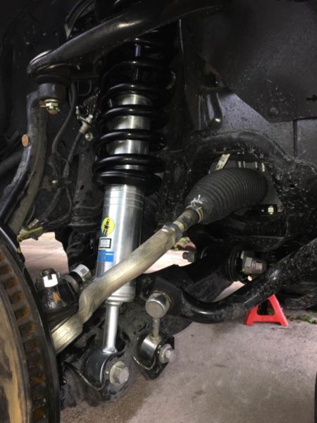

    OK,

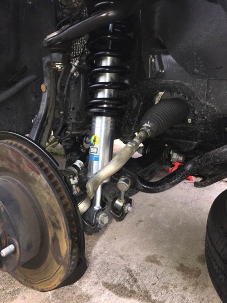

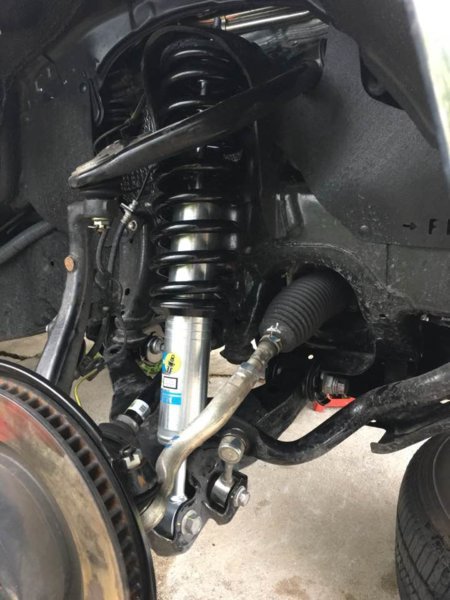

    We have a BINGO, crossed the finish line about a hour ago! So much prying with the bar, didnt even have to loosen the LCA cam bolt, I tried but wouldn't budge! I put a long pry bar and sat on it while I finagle all the bolts and 6112 in! Was better then yesterday, just that I used muscles I hadn't in years and even my hair hurts, lol!
    Had to make a temporary cover to work in the rain!17800292_10211972509326658_5614717668701216682_n.jpg17883537_10211972507846621_6724200877838361076_n.jpg17883719_10211972508766644_589149990660094363_n.jpg17884035_10211972509566664_8426761095703186460_n.jpg17903493_10211972508246631_6791510582268986928_n.jpg
    My shoulder feels like it was beating with a bat! Any way, I'll take it in tomorrow and get the alinement and have the check the drivers side UCA CAM bolts I loosened and the service manager I knew from a past dealer that used to work on my 2010, he said once I finished bring it in for a aliment and he'll have them check the torques!
    Ill do the 5160's and CB #2 shackle later this week and I'll just get it realigned once I get the new tires! I'm hoping the #2 shackles don't give me a big rake being I want no more then 3/4" rake rear, minimum but traction control still stays happy!
    thanks every one for you big help, been an inspiration and great knowledge form you all!

    SWEET! Good job brother! Man, that beastly coilover looks so much better in there

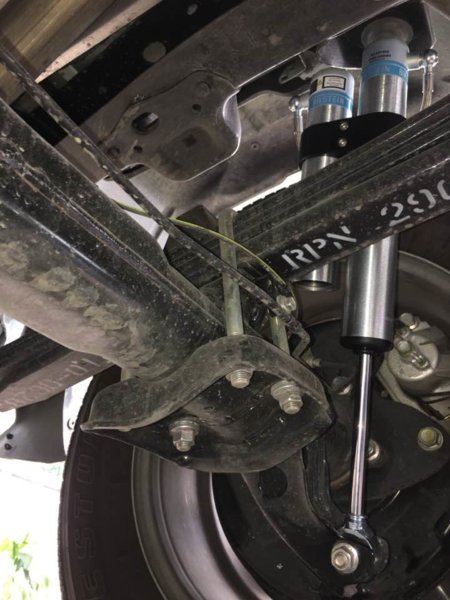

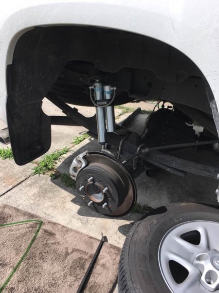

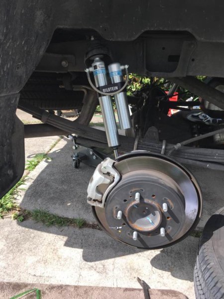

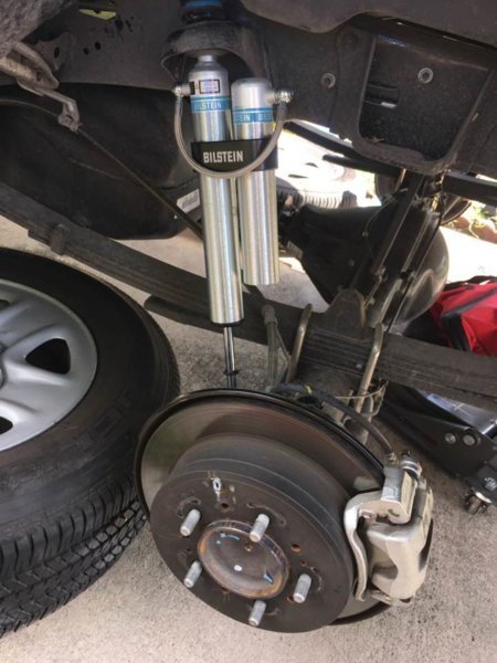

    DAY 2, Bilstein 5160 install
    I just finished the 6112's and 5160, did it in 2 days but took my time, came out great love the drive! I'll take in for the alinement next! I drove yesterday an it drove straight with no pulling right or left!
    The front appears about 1" higher then rear but I heard the front will settle and drop a bit!
    I still haven't done the #2 shackles but I have them just thinking wether I want to add them, I won't be towing or heavy hauling but still on the fence! But if it would help over all I would add them but don't know if CB #1, 0.65" lift may be closer to a minimal rake instead of the #2's which say 1.25" lift rear!
    now that I look at the 5160 install, I think I put the res on the wrong side, does it make a difference and if so do I have to take them all off again, :frusty: As it is now the res seems right at touching the frame hump where the shock top fit in, are these right and left specific shocks!

    Good job my man!!!! But it won't settle a whole inch. And isn't the rear shocks made for a certain height? Either with or without shackles, but not both?

    I just realized the instructions on the 5160's say to mount the reservoir on drivers side and the rev on the pax side facing rear, damn it! I wonder if I have to take the shocks off or could I just loosen the top nut and twist the main shock and rev the other way, I think the hose and fittings have play and will twist, just want to do it right!

    Great job Geno..........The front will settle down once you get it aligned. I would wait and see where it sits before tackling the rear shackles. The rear shocks have a swivel banjo fitting on them. They are designed to allow you to remote mount the reservoir just about any where. Just don't kink the hose. Hope this helps........

    What Lenny said! As long as the hose doesn't kink and nothing is close enough to make contact, you can mount them however you want. Looking good!
