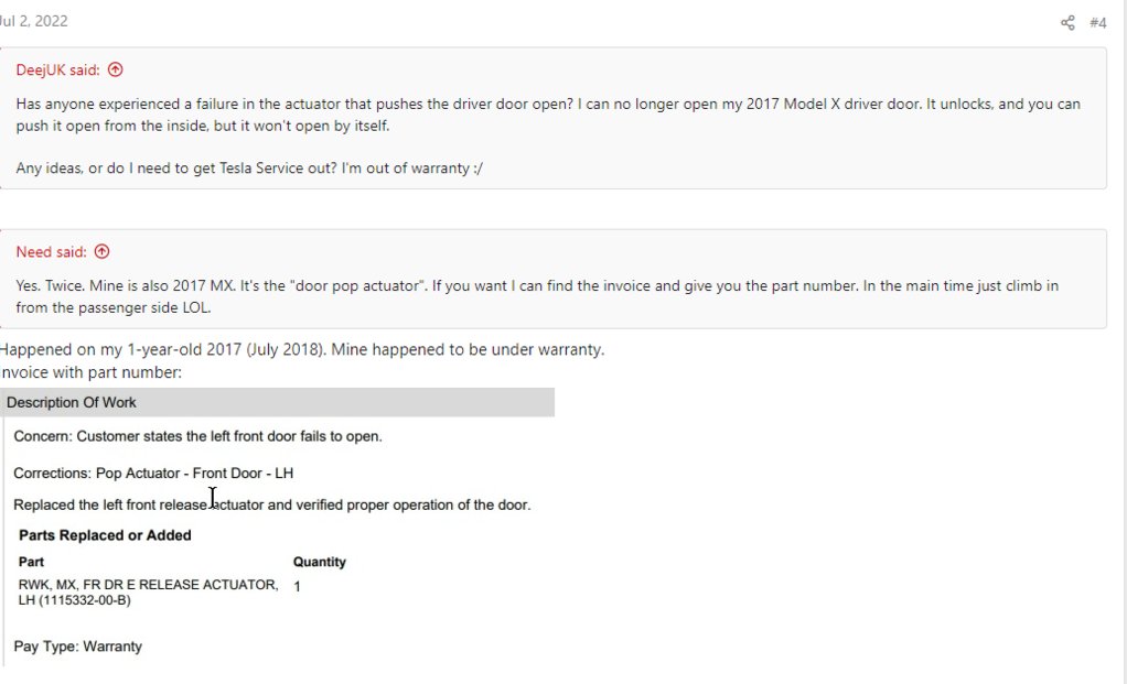

  20. Oct 16, 2024 at 9:03 AM
    #7850
    nobodyintexas
    nobodyintexas [OP] What?
    Jun 22, 2020
    #48303
    7,008
    South of Houston
    S/C'd 2020 White 1794 Tundra
    well.
    Driver door won't open.
    appears to be a known problem. door pop actuator
    easy fix.
    however...you would think the Earth just stopping rotating.
    from the Tesla forums:
    NWPirate and T-Rex266 like this.
  21. Oct 16, 2024 at 9:33 AM
    #7851
    nobodyintexas
    Jun 22, 2020
    #48303
    7,008
    South of Houston
    ordered the door pop actuator on line. supposed to take 15 minutes to change.
    1st service appoint was Dec 2.

  27. Oct 17, 2024 at 3:17 AM
    #7857
    nobodyintexas
    Jun 22, 2020
    #48303
    7,008
    South of Houston
    MX door update
    after work, I drove the Tundra to the League City Tesla service center.
    The nice young fella at the service desk was VERY customer focused.
    I explained we had a new MX and the door won't open,
    and also comically drop that it's the wife's car and please get me out of the shit(happy wife/happy life)
    so, he went back to the service guys to see if he can fit me in this morning. yes!!
    now the service guy comes out(another awesome customer service example) and asks the situation. I explain "someone" can't get in the drivers door.
    the service guy said to try this fix.....have someone get in and use the manual bypass* and that will usually reset the door routine.
    I called my son to have him give it a try......bam...it works now.
    Tesla is awesome.
    *FTR - if I was present, that would be the first thing I would have done.
    ...and - truly, I did not realize/consider that the MX has the same manual bypass as the MS. the MS is obvious, the MX, not so much.
    and I still have the doo-hicky part coming in - in case it faults again (it will).
    T-Rex266, NWPirate and Terndrerrr like this.
