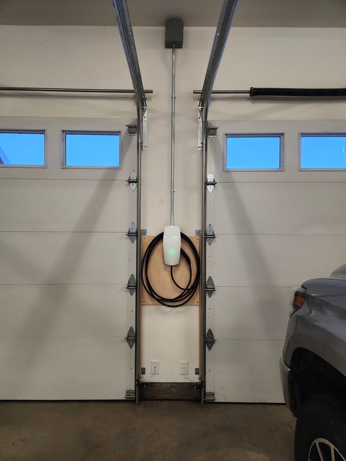

    You could run a piece of smurf tubing (non-metallic conduit) from the panel over to the location. That way you don't have to buy the wire right now but someone can pull it in later.
    I did this with 1" smurf and mounted a surface mount 6x6 box. You could do the same and paint it so it disappears.

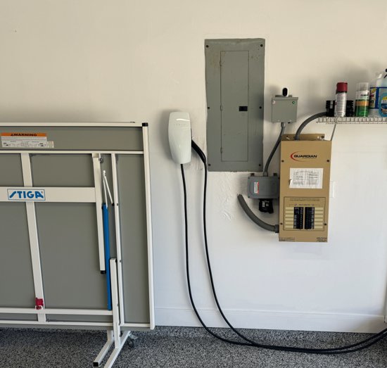

    my easy install at the Lake. 60amp circuit (48amp to car). put it right next to the panel*. the cord reaches both parking spaces.
    again, let the next guy install it.
    *I have no idea what those little subpanels are - I think they are whole-house surge protectors.
