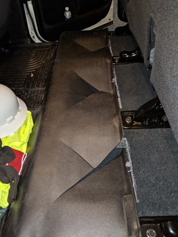

    Yes, I cut the my husky liner and turned out great, see last two pix. I used a general purpose kitchen shears (scissors).

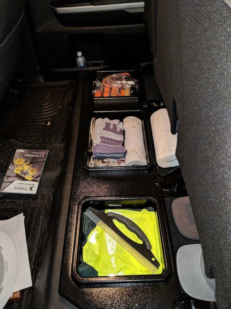

    I cut my mats, but did not cut out the holes; I just cut a big X in it from corner to corner. That way the box push it down into the hole and it keeps the mat secure. I was also concerned about those end pieces pulling out and flapping around loosely.

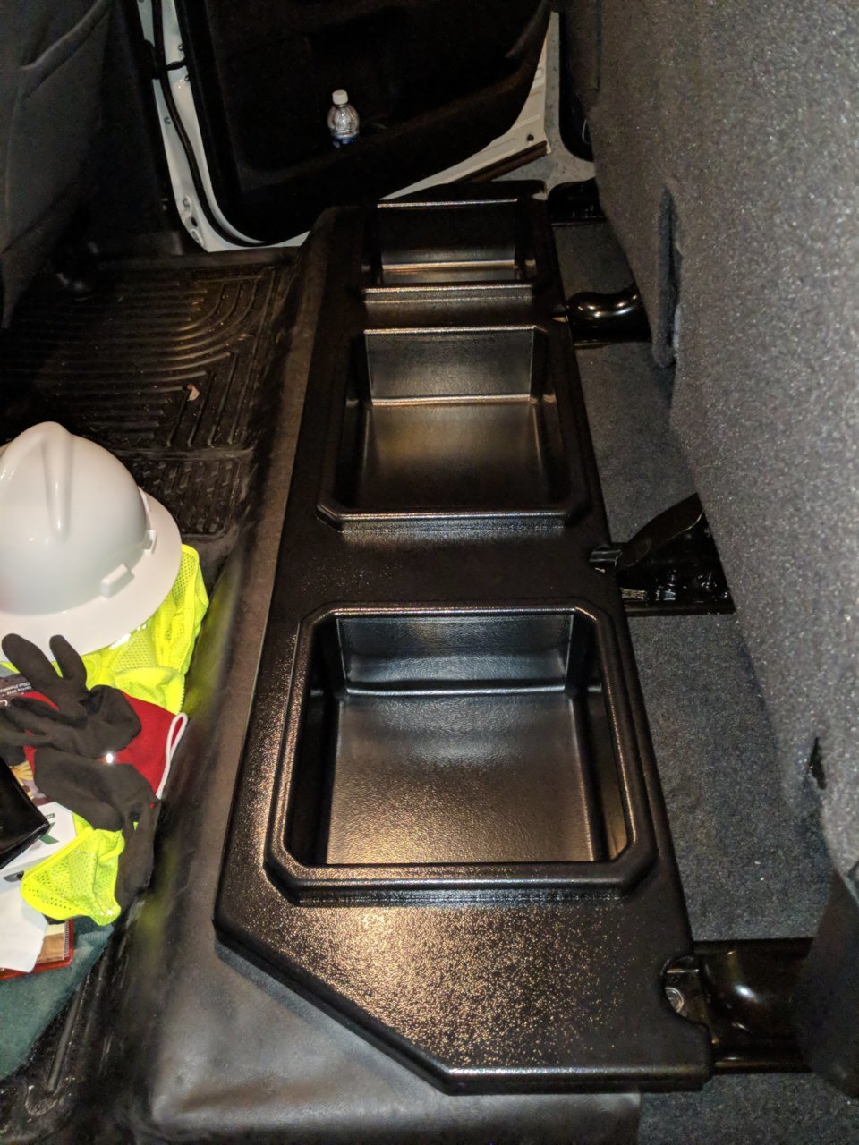

    I installed the plastic three bin ESP last month. First mod to a 7 day old truck. Spent a lot of time with a yellow crayon marking things before cutting. Once I made the cuts, I kept getting more and more surprised at how much freaking room is available under the carpet. Toyota just screwed the pooch under and behind the rear seat in the CM. ESP left a LOT of meat on the bone with the plastic storage. All three of the bins could be 2 or 3 inches wider and close to 10 inches longer (front to back). Could come close to doubling the volume of each bin.
    I don't remember the measurements I did, but I do remember looking at the length front to back that was available and grabbed an AR pistol with a 11.5" barrel and laid it down, muzzle toward the bed, and briefly thought about abandoning the ESP and cutting a custom hole in the foam for the AR and just having a carpet flap over it. Not unappy with the plastic ESP in any way, but could have been soooo much better.

    I just installed the ESP open plastic storage try in my 2019 CM as well. I'm happy with the extra storage space but am a little disappointed with the installation process considering the price of the tray.
    After cutting out the template I did a test fit with the underside of the tray and the cutouts were not at all the same size as the three bins. I had to close in the backside of cutouts quite a bit. The alignment references aren't great either as the bolts on the seat brackets might not be centered.
    I would advise placing the template very carefully with consideration to the overall space not just the seat bracket bolts. Make sure to test fit the template on the tray and as others have mentioned cut the holes undersized.

    Yes. They were only a day old. Scary to do, but it worked out good. I did not cut out holes; just big "X"s at each bin and folded it down into the holes. See post#68

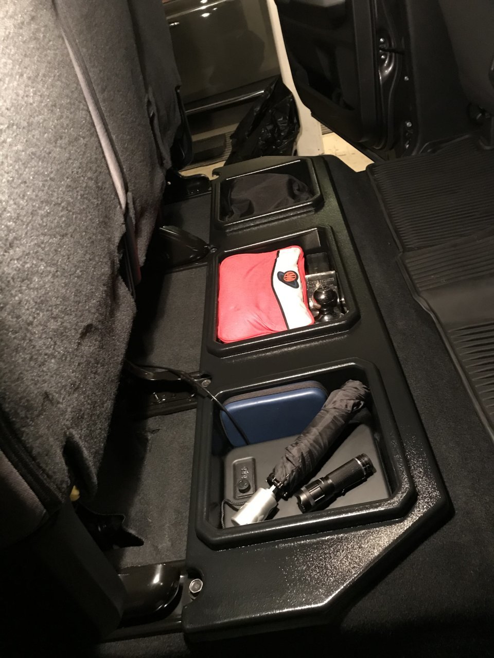

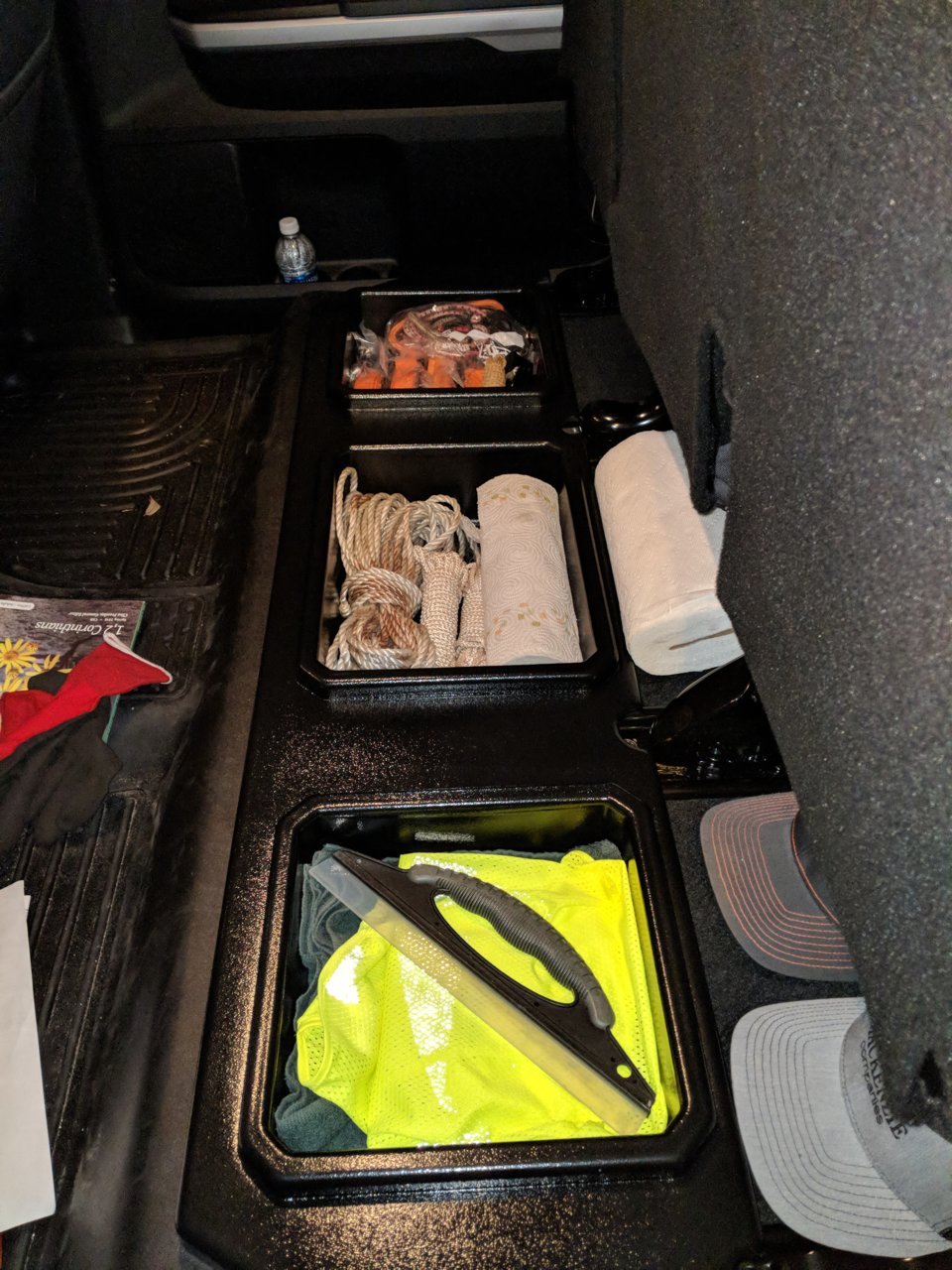

    Just to clarify based on my experience- under the carpet there is a large expanse of gray styrofoam. It seems to be one solid piece. When you cut through the foam and remove the pieces, you’ll see the metal floor covered in a sound deadening material. There are no wires, bolt heads, etc... in the places you have to cut to install the storage insert. I have the 38 gallon tank and it did not prevent the installation.

    I think it is just over 4" deep; 4-1/4" if I remember correctly. The ESP bins is probably one of the most useful mods on my truck - I really like it.
