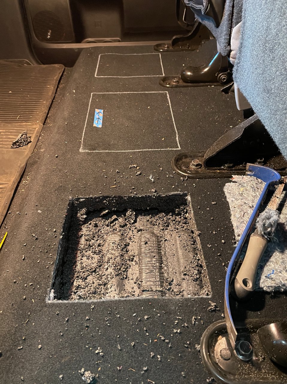

    For those that have done the ESP storage mod, does anyone recall if their template was somewhat asymmetrical? Maybe this will become self-evident to me here soon enough.
    Driver's side:
    Passenger's side:

    The main compartments appear to line up...

    So that looks like about an inch back from the bend in front, thanks for highlighting that.
    I think the template on my box was drawn haphazardly. I believe it all works if I essentially split the difference between the left and right, and shift it all about a quarter inch toward the driver's side. Thankfully there appears to be a very large margin for error...
    Edit: The upper right side of my template measures 35mm wide, and the same on the left side measures 20mm. So if I shift it right by 7mm, all seems to work. And the margin for error is way in excess of that.

    Well, that was easy. A drywall saw cut the stiff foam a heck of a lot easier than the recommended linoleum knife.
    Measure thrice, cut once, kids!
