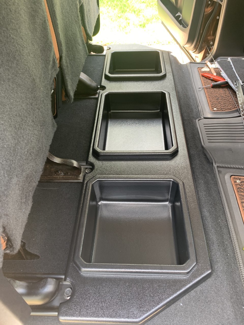

    ESP Plastic Storage installed today. Great idea to cut inside lines, tight fit.
    66DCCB76-F1B4-4C0E-83B1-89135582AAF9.jpg 6B5C019A-2233-4850-939C-5950C4CB0D6B.jpg F25B6D84-77C7-4139-8CA1-985C65D56484.jpg 2AD1E965-C1AD-4A9F-BA52-876E4BBF74AC.jpg
    bunz559, BLONGTX, Shaggie13 and 2 others like this.
