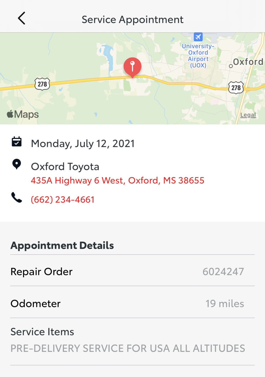

    I was looking at my service history in the Toyota app and noticed this entry. 7/12 is when I started having this issue. Don’t know why this entry was made unless it was not added before I bought the truck in April.

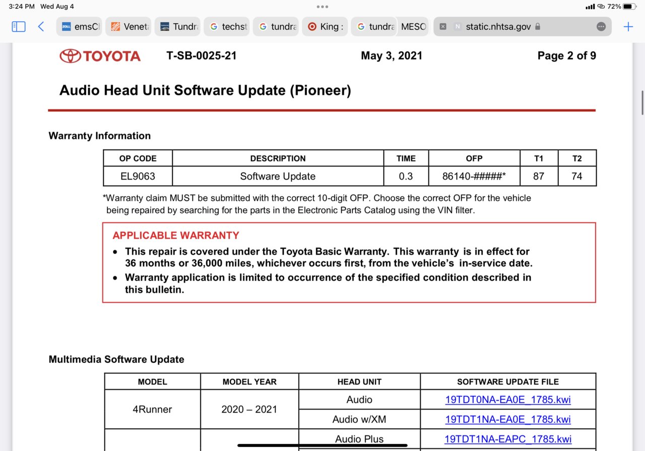

    5C23EABD-1B9D-49A0-AC51-23748D520CCA.jpg Just came across this. Going to look into it more however there is a suggested update via USB that the dealer is suggested to perform. Released in may of this year.

    I attempted the suggested update via USB without success- I assume the (your) dealership did not resolve this issue when you were there?

    They unplugged my negative battery terminal for 30 min. Ridiculous…… this says they need to match some radio ID before it’s downloaded. It’s supposed to be covered by Toyota.
