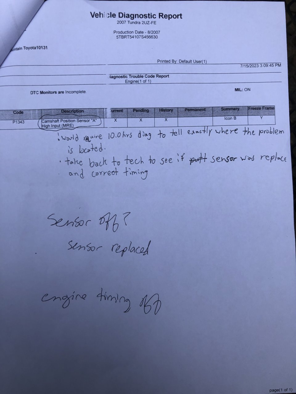

    So the check engine light came on and I replaced the camshaft position sensor but the light wouldn’t go off and when I took it to Toyota they said the engine timing is off ? Anyone know the fix ?

    Need. More. Info. What are you driving?

    2007 4.7
    153k

    2007 5.7l Tundra DC SR5 long bed 2wd
    TRD Sway Bar, Roll covers USA bed cover
    Vehicle was provided in the image at the top. I do believe the 4.7 still requires a timing belt change. Have you changed the timing belt?? Otherwise this may be a warning.. I don't know about 10 hours of diagnosis, but it may be a 15 hour + or - job for a timing belt change.
