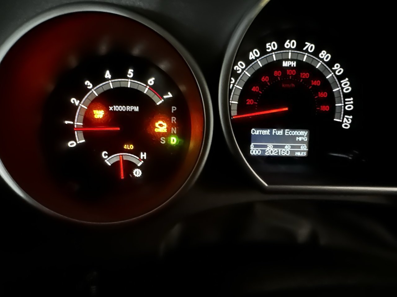

    Drove the truck about a 50 miles away. Turned it on to head home a few hours later, and the truck threw a number of codes. The 4LO and CEL lights were flashing while the TRAC OFF light was steady on. Using the graph in the following thread didn't help - https://www.tundras.com/threads/4-lo-flashing-no-4-lo-engine-light-and-trac-light-on-too.84367/.
    I found this thread that seemed to have most of the same codes I got, but am not sure what sensors he's referring to. Or, even if that is the problem I'm dealing with here since the first time I got the truck back, the timing was definitely off as I highlighted in my OP.

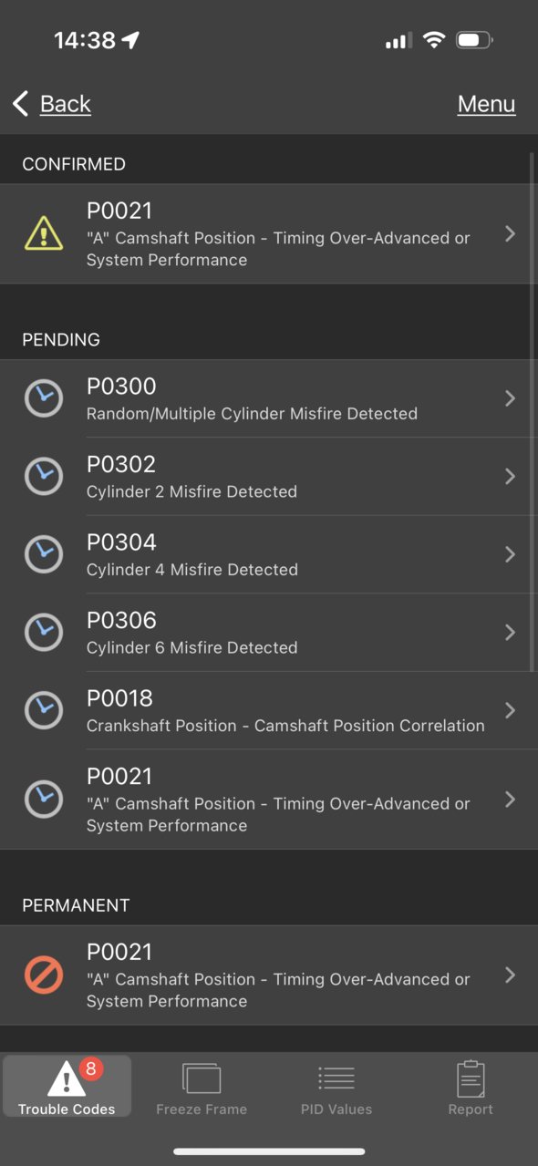

    Codes I got:
    p0300 - multiple misfires detected
    p0302, 304, 306 - Cylinders 2, 4, 6 misfiring.
    p0018 - Crankshaft position - Camshaft Position Correlation
    p0021 - "A" Camshaft position - Timing Over- advanced or System Performance.
    Cleared codes and only got p0302 and p0021 returning. This time CEL and TRAC OFF were steady on. 4LO was flashing.
    Truck seems to drive normally in either lower gears/higher rpms as I discovered when downshifting to get enough power to pull off somewhere safe to wait on the tow truck.
    Would greatly appreciate any insight.

    Seems like the chain running to bank 2/4/6/8 is still not right.
