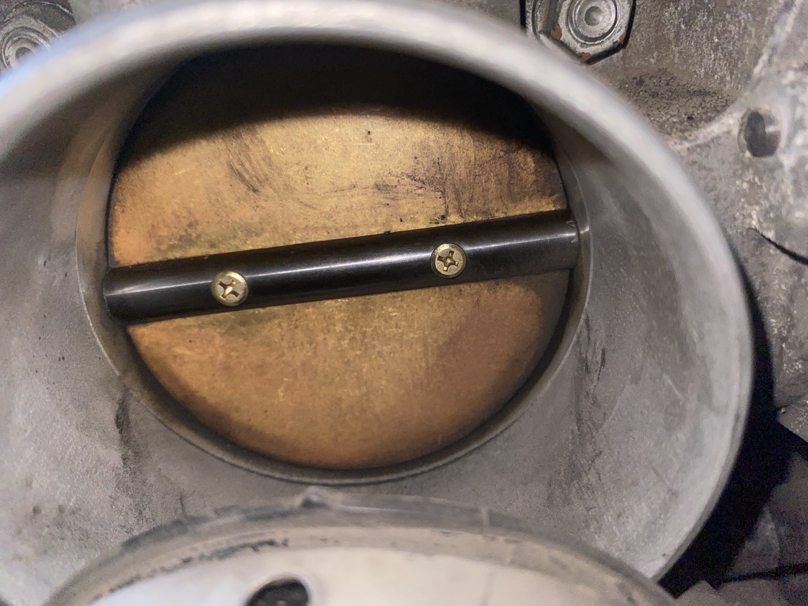

    I have been noticing that after my truck has been running at a high speed (50mph+) for longer than an hour, when I slow down to come to a complete stop the engine starts to rumble abnormally. I can accelerate and it goes back to normal.
    I can be running it for hours at various speeds and everything is fine. But only when at a high speed for an extended period of time this occurs.
    Has anyone had this happen?
    ANY advice is appreciated!
    -voodoo

    Curious, can you get us a picture of your throttle body opening? Like, pop the intake tube off and shoot us a picture of what it looks like, before attempting to clean it. (Can give cleaning tips and what to avoid if you want ... just don't slam the butterfly shut, and never spray anything into it. Sorry if you know this, we've seen some ppl screw themselves on here)

    Check what shifty said first. He's the man with 1GT.
    At steady state throttle and RPM, your ECM is shooting for a specific ignition timing and fuel map. If you have parameters pulled up your stock engine ECM will shoot for a 14.6AFR with around 15-20* ignition advance.
    I say that because you haven't mentioned if you're up to date on tune-up parts. Old up-stream O2 sensors can read off of actual value, even if they aren't throwing codes. And old spark plugs can be fouled or not throwing as hot a spark.
    At long-term steady state driving if your air/fuel ratio is off you could be running extended periods of a rich or lean condition but your ECM is reading it as fine. You come to a complete stop and your engine stumbles trying to reconcile the incorrect AFR reading or spark timing with what your engine is actually doing. You bump the throttle a couple times to force the ECM to react to the changing condition and move to a different portion of the fuel/spark map thus resolving the stumble.
    I may be thinking too far into this, but when was the last time you changed plugs, upstream O2, cleaned throttle body, cleaned MAF, checked for vacuum leaks, changed air filer? But the problem could be as simple as a gummed up throttle body.
