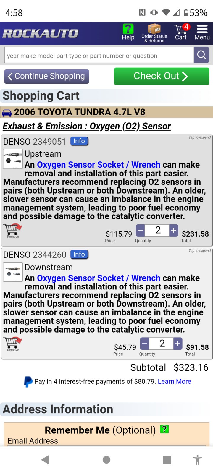

    Question? Are the upstream and down stream o2 sensors the same on each side? So if I get two of each, I should be good. Going with Gen 1 bypass, one because it sounds like the consensus is it does the job and two my mechanic said he won’t mess with the ECU and soldering. It’s illegal here so I need to pay him cash. He said he could get fined $10,000 doing it.

    It varies from year/model/drivetrain.
    Look up your part number at www.densoautoparts.com
    DO NOT order the part marked "Universal", you want the "Exact fit" (OEM) part. Then run that part number over to RockAuto.
    If you need help finding the part, gimme your engine (v8/v6?) and cab type. I see you have a 2006 4WD, I just don't know if that's a V6 (which could be auto or manual) or if it's a V8. If I had your cab type, I could deduce it's a V8. I assume V8 but don't want to assume anything.

    Yup I confirmed through Densos website those are the correct (direct fit) 02 sensors 234-9051 & 234-4260 that I listed about , ordering now, thanks again. This forum is invaluable
