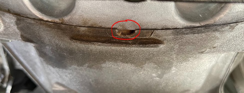

    I wouldn't worry too much about it. I had the same weep soon after purchasing my truck. I actually noticed it really early on. Did the same thing. Cleaned it off the bell housing and it's never returned in 15k+ miles. Mentioned it to the dealer before I did it so they could document it. They said it was normal for excess lube to come through the weep hole during the break-in period. Normally, I'm skeptical but in the case...I think they were right.
    Obviously, keep an eye on it. I take a look at it every time I drop my skid plate.
    Edit: Found the original picture. This is what it looked like when I took the picture (to give to the dealer for documentation). There is a weep hole at the bell for excess lube to vacate the house. It was completely dry to the touch when I took this pic so it hadn't leaked in awhile. As mentioned above, hasn't returned since.

  20. Mar 24, 2023 at 8:01 AM
    #500
    vtl
    vtl New Member
    Mar 23, 2020
    #44238
    2,944
    Boston 'burbs
    2019 Red SR5 DC 4x4
    What weep hole?
  21. Mar 24, 2023 at 8:02 AM
    #501
    KroppDuster
    KroppDuster A normal guy trying to survive this crazy world
    Dec 7, 2021
    #71535
    2,005
    Here. There. Everywhere.
    2021 SR5 TRD Off Road - Cavalry Blue
    Bilstein 5100s
    Added a pic to my post. It's circled in red.
  22. Mar 24, 2023 at 8:12 AM
    #502
    vtl
    vtl New Member
    Mar 23, 2020
    #44238
    2,944
    Boston 'burbs
    2019 Red SR5 DC 4x4
    Oh, that one... It is there for a leaking rear main seal or transmission seal not overfilling the bell housing. It means one of those two seals is leaking. It is not assembly grease. New types of low friction seals forbid using lube on inner leap. It will not get better. The leak will slowly increase until leaked oil evaporation inside heated bell housing become unable to hide it.
    Leaking RMS is a big problem in new Nissan/Infinity as I read. Maybe Japanese manufacturers switched over to a goofy seals supplier. Maybe Toyota switched to low friction seals that are very gentle and are easy to damage during installation, so under-educated assembly line worker wrecks the seals.
    I believe this is another factory defect.
  23. Mar 24, 2023 at 8:19 AM
    #503
    KroppDuster
    Dec 7, 2021
    #71535
    2,005
    Bilstein 5100s
    As I said, 15K miles later it's still clean as a whistle. If the RMS starts to fail & it starts to leak out of this area again, as long as it occurs before my extended warranty expires, then at least I'm covered. Until then, I'll keep an eye on it.

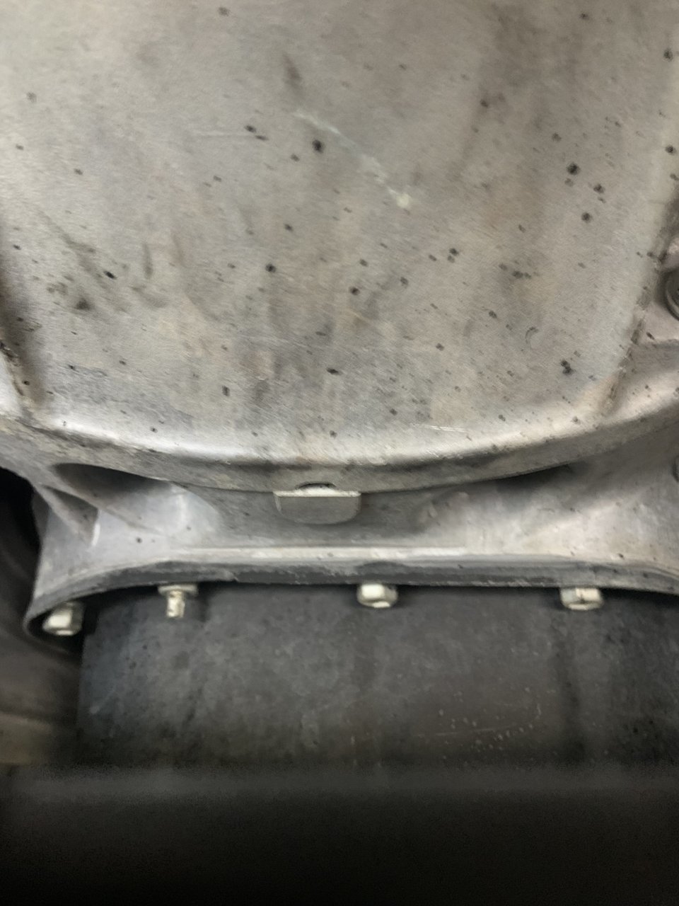

    I was under the truck reinstalling my skidplate. With all this talk about weepholes, I was feeling frisky so decided I’d show you guys mine. Must have went in dry at the factory, my weep hole is like the Sahara.

  27. Mar 24, 2023 at 3:27 PM
    #507
    hagrid
    Dec 5, 2018
    #22645
    2,332
    Spraynard
    Pittsburgh
    K1600GTL ZX-14R
    paynuss stretchers
    Thank you for the peek at yer hole!
