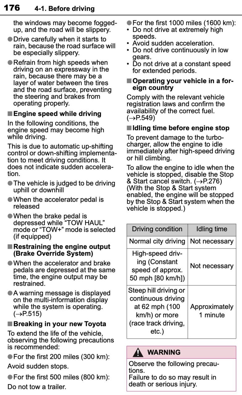

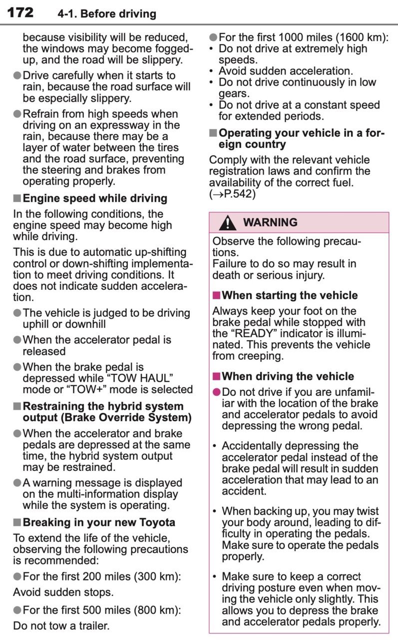

    I've compared the 2023 Toyota Tundra Owner's Manual (page 176) and the 2023 Toyota Tundra Hybrid Owner's Manual (page 172) and only the gas version owner's manual makes reference to idling after high-speed driving or hill climbing to prevent damage to the turbochargers. If the gas version and the hybrid have both been used for high-speed driving or hill climbing, I don't know why idling times are identified for the gas version only. Any ideas?

    Unless they have recirculating pumps(some sports cars do, but dont think Tundras do) to cool the turbos down. Our hybrid I cant control the idling since I would let it run 20-30 sec before shutting it off, but it shuts off on its own. Good Synthetic oil is your friend as far as turbos go.

    Maybe it's just that hybrid can't really be controlled to let it "idle" so Toyota kind of just gave up on this point?
    Ps I'm a big idler, warm up my truck for 5+ min and cool down for a couple min

    I’m curious on this as well. Is there a separate electric water pump or something on only the hybrid model? It should have the same idle time requirements as the non-hybrid if it doesn’t have some kind of additional oil or water cooling capability….??

    It could be that with the HV system, less power is directly needed from the engine and turbos. The reduced stress on the turbos can have them run cooler and with the additional output from the HV system, it would be easier to have ecu programmed logic for cool down strategy.

    Perhaps as the hybrid engine runs it also turn the oil pump on the engine. Both motors are joined at the transmission.
