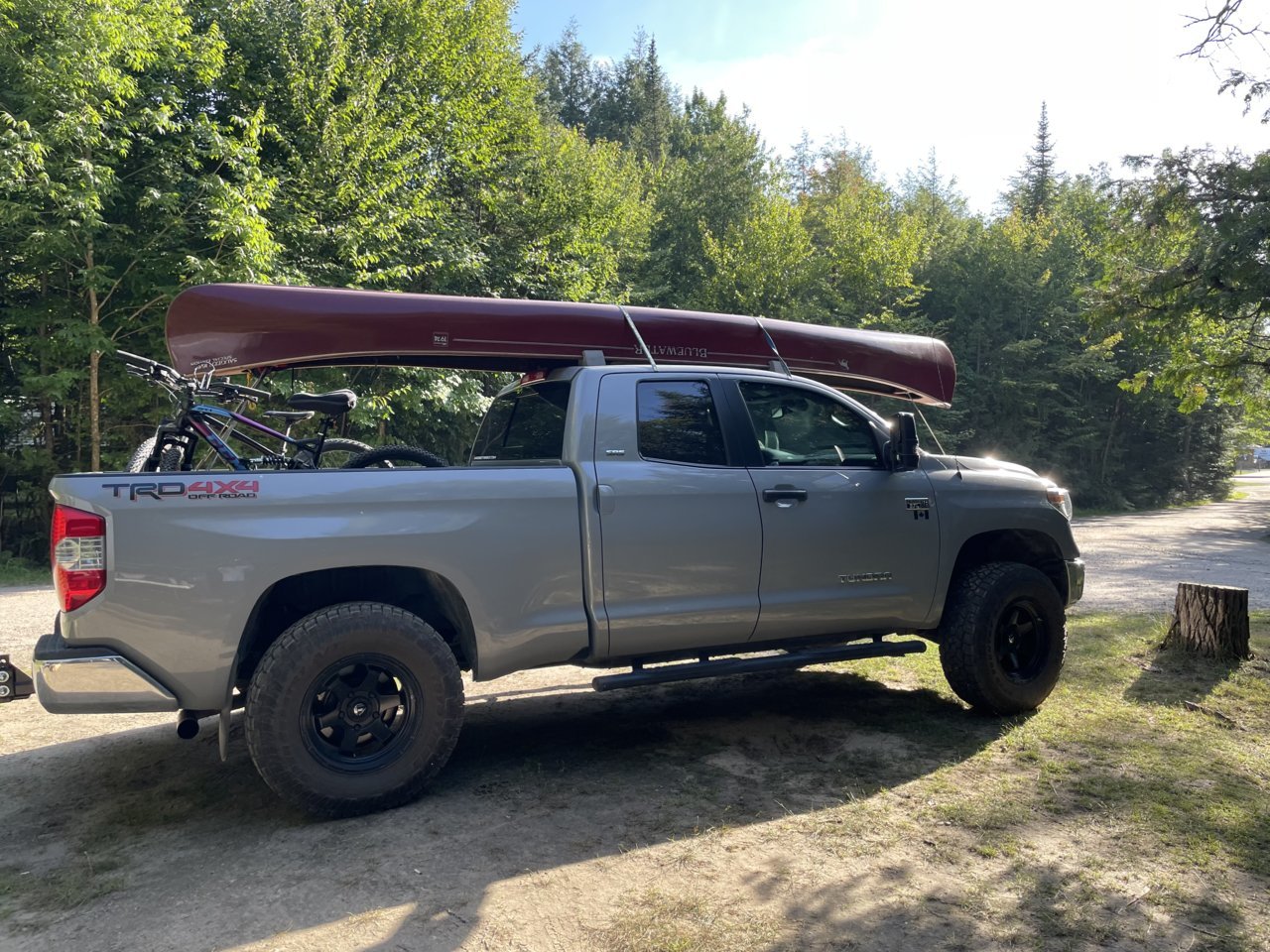

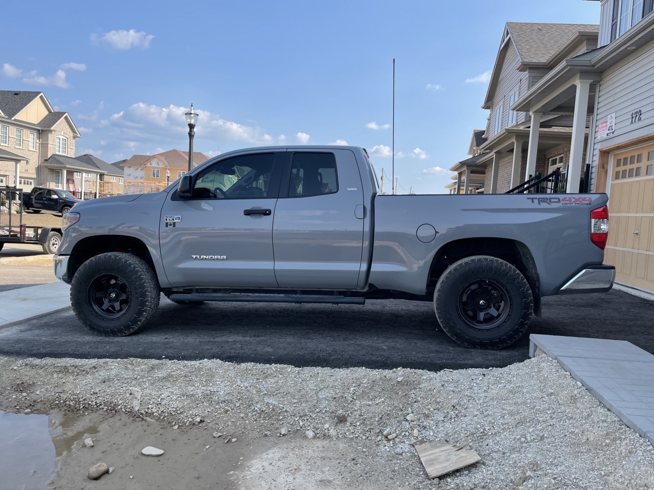

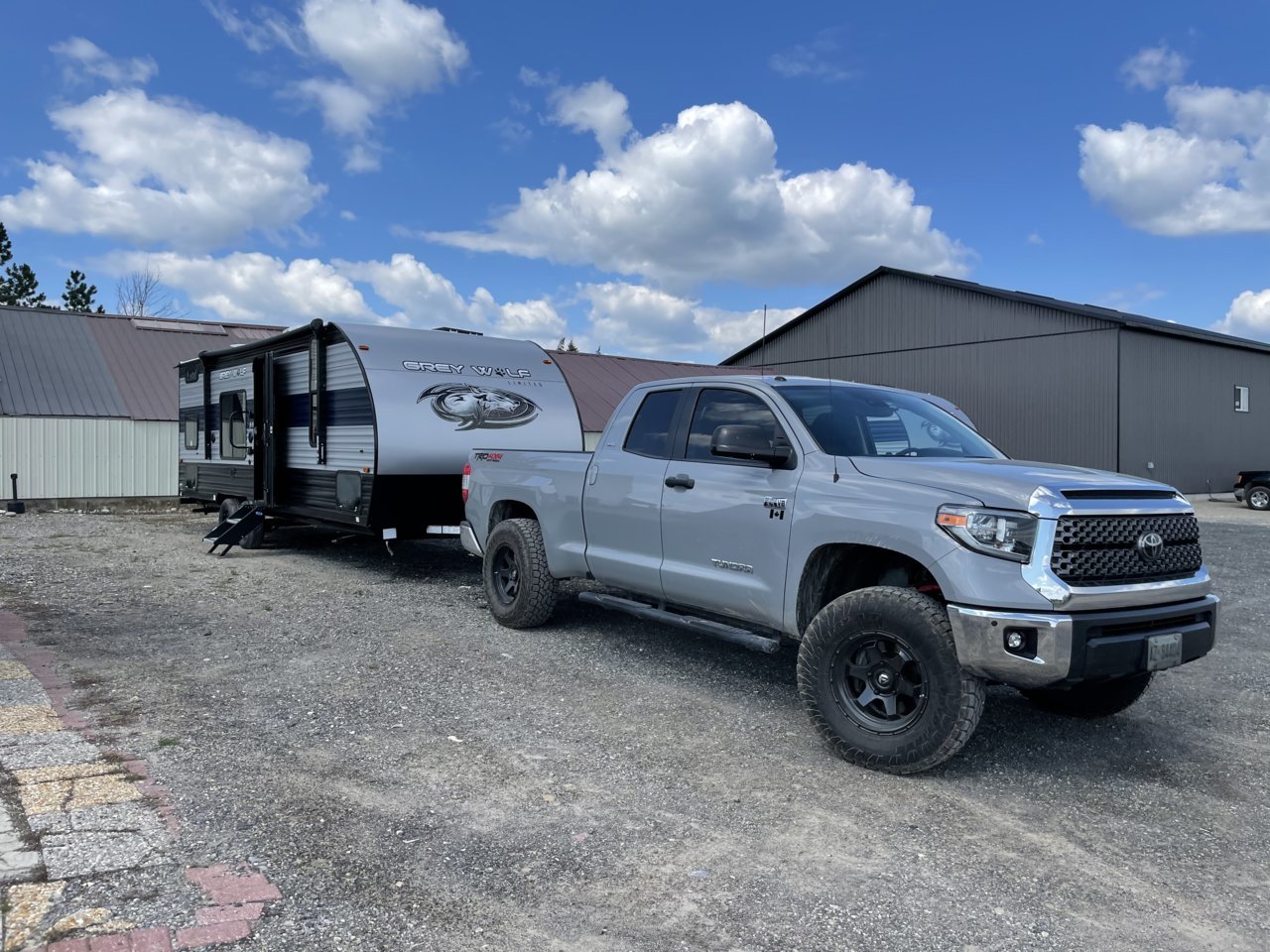

    You’ll love the set up I have 2.5 non-res all round set upfront at 2.5” with a CB 2” shackle with open country at3 (285/75 18) and it’s awesome all around for everything I do which is tow, off road it does the job is comfortable I have JBA UCA’s no issues with the sensors only had to recal. Cause the size change I do need to get the 3” Shackle replaced cause I’m just about level and I want the take back cause of the sag while towing my camper
