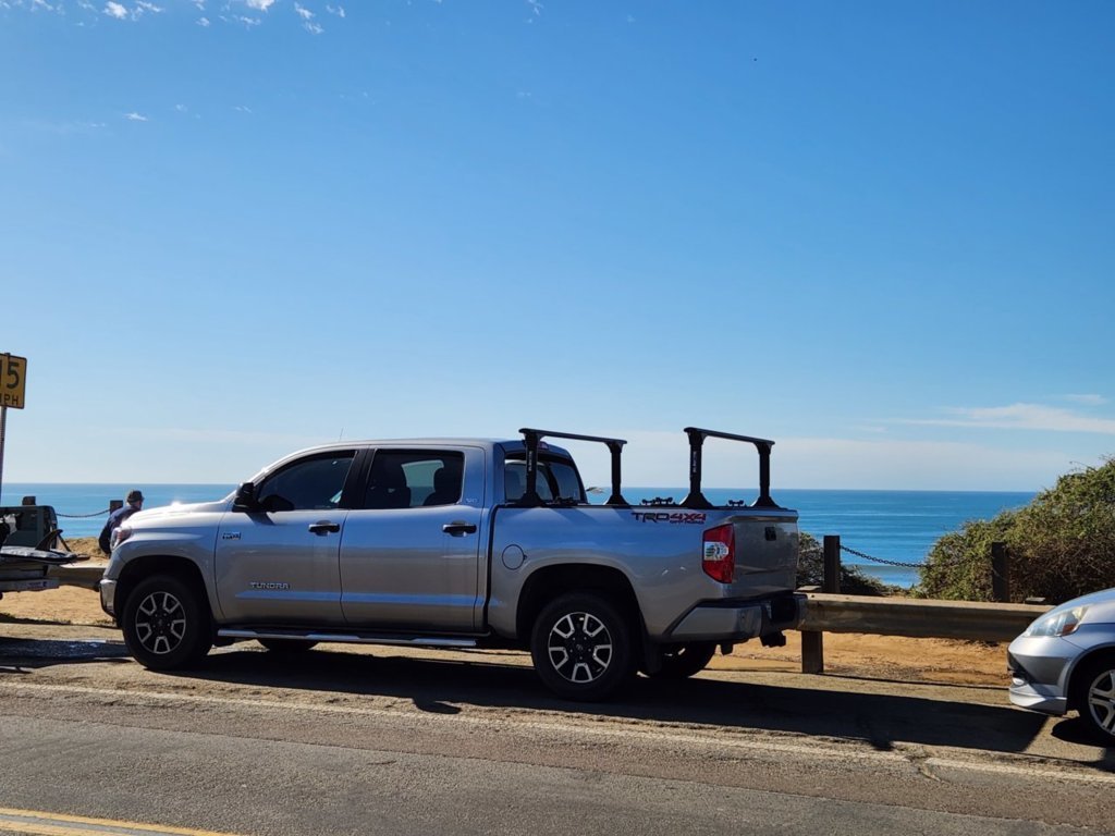

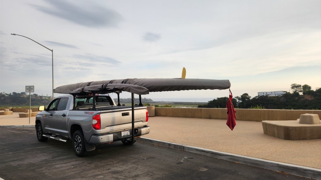

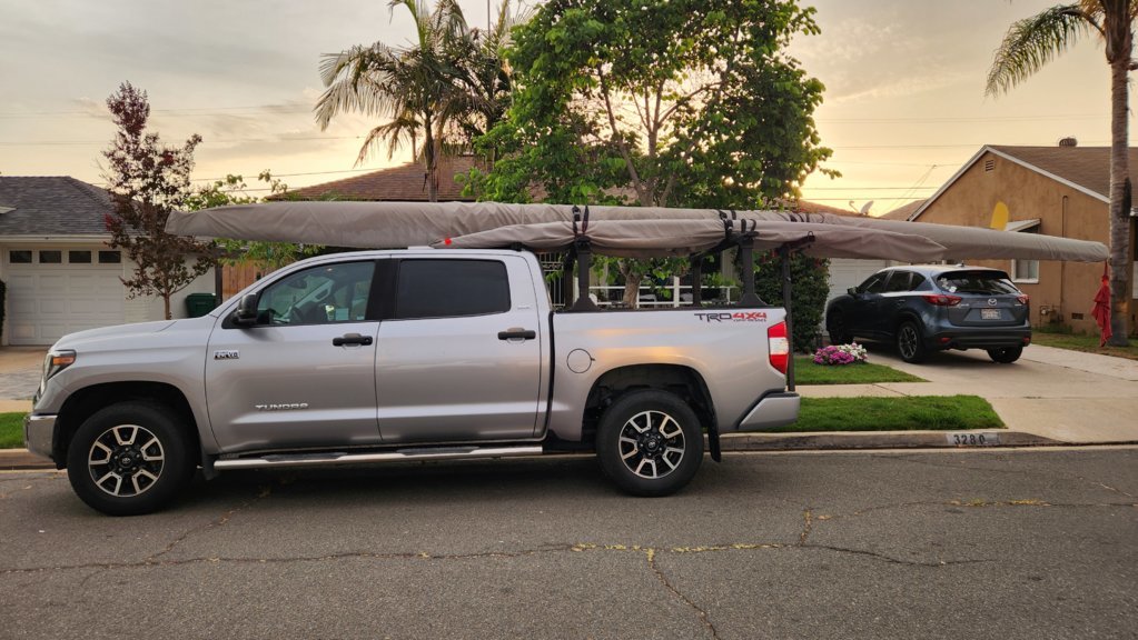

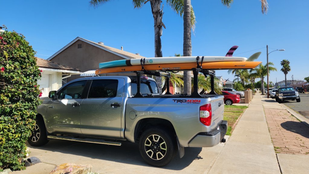

    I have usually run a camper shell on my truck(s) in the past, and totally thought I would be putting one on this new to me '19 but there are times when it'd be nice to have the open bed so I decided to switch it up on this one.
    I usually take a couple of boards with me when I go surfing, so I knew I wanted a tonneau to have some covered and lockable bed storage. The roll-up kind just didn't appeal to me. I might've thought about a retractable if I didn't have the 5.5' CM bed so the tri-fold made the most sense for my likes and needs.
    I also have to be able to haul SUP's, my touring board is 14' and the wife's is 12' 6" so racks are a must.
    I was really surprised how few options there are available to run racks with a tonneau.

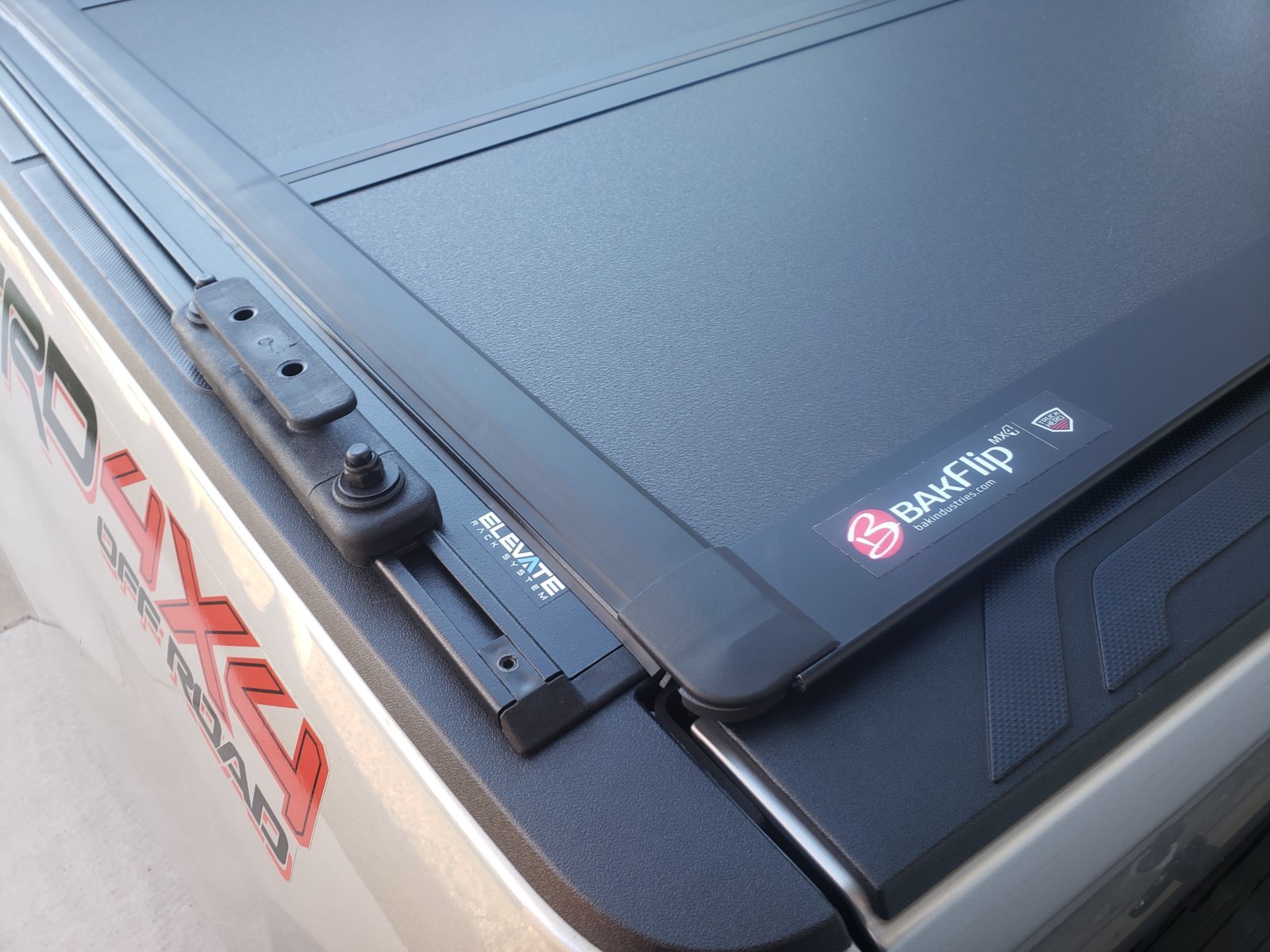

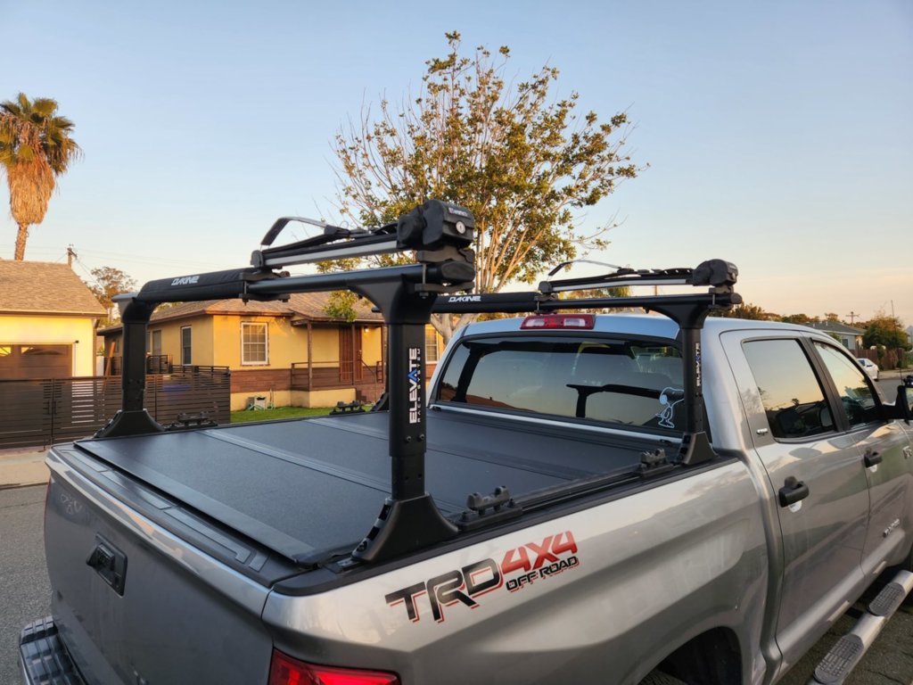

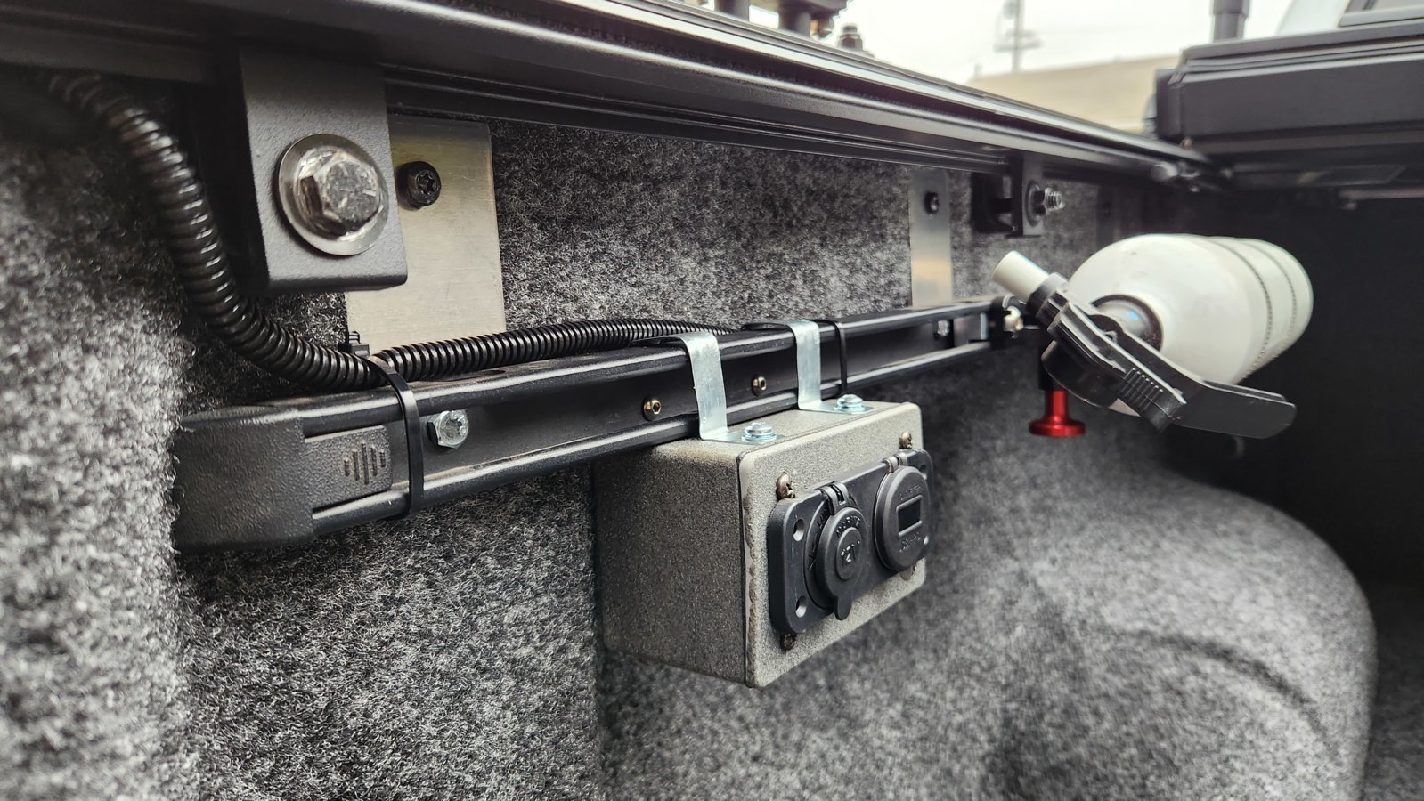

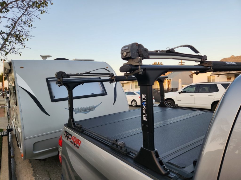

    I got the Bakflip MX-4 a few months ago and installed it with the Elevate T-Slot rails to allow adding the Elevate racks, which I put on last night.
    I like that the Bakflip allows retaining the use of the bedrails.

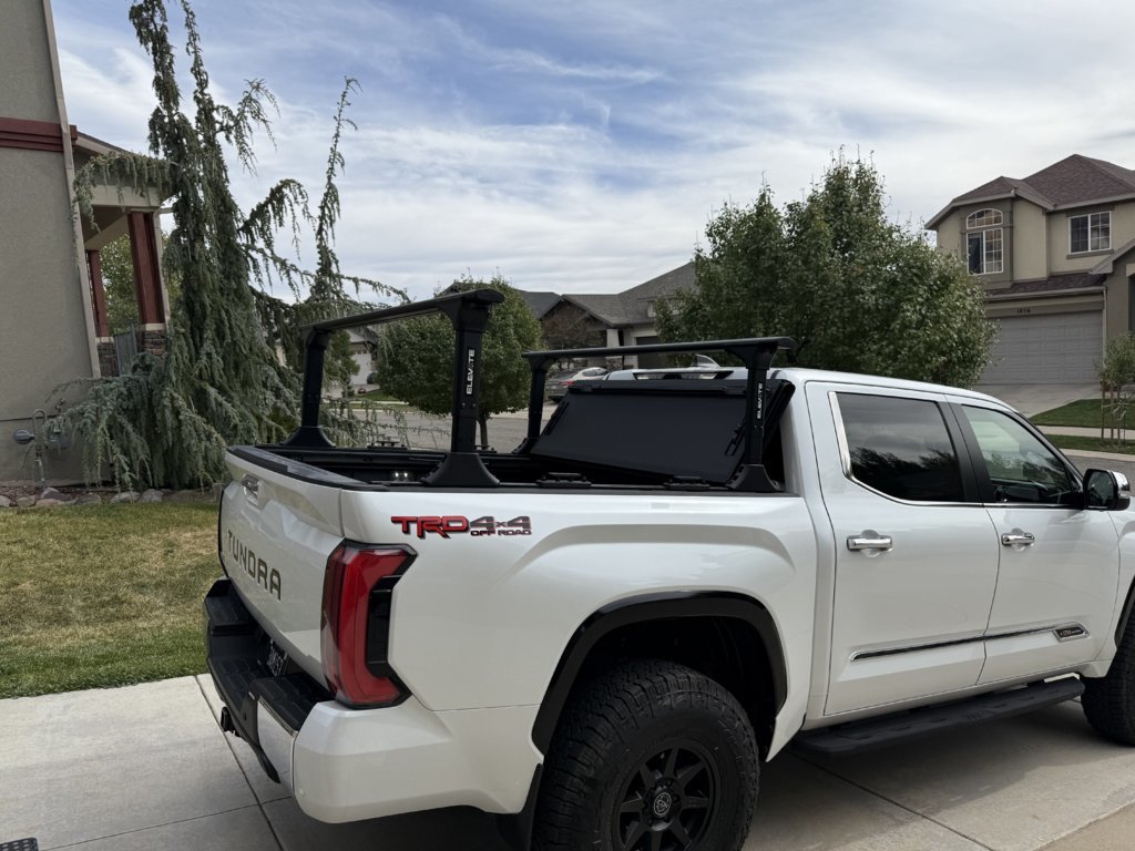

    Been very happy with the Bakflip so far. The racks are adjustable but in the low setting I can't quite fold the tonneau.
    High setting (pictured) is functional but looks a little dorky to me, I'm going to drill some new holes for an in between setting. I think they'll look better with the crossbars just barely above the roofline of the cab.
    I don't "Love" the look, but I need the functionality, and they're growing on me.
    They feel pretty solid, they're rated for 250 lbs driving off-road, 500 lbs driving on-road, and 750 lbs static load.
    So far, so good. Now to get the bedrug, 12V power in the bed, and bedlights, and I think I'm good.
    If my SUP's fly off at 80 mph 'cuz these are shit, I'll report back, but I think this'll work.

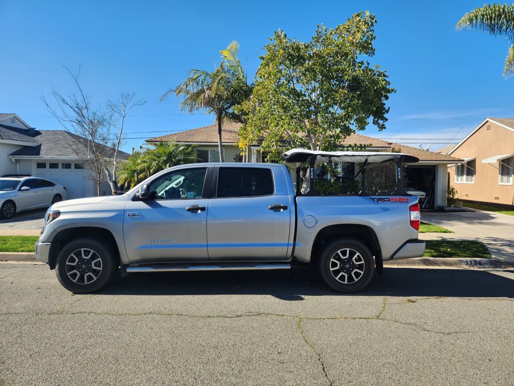

    Oh yeah, the TS rails come with some tiedown cleats which are mounted just inside the rack uprights.
    I mounted my old Yakima Landing Pads to the cleats, so if I want to I can run my Yakima bars down low. If the need arises I could have triple decker cargo capacity.
    Stuff in the bed, stuff on the Yakima bars, and stuff on the tall racks. You know, just in case. :rolleyes:

    There, that's a little better.

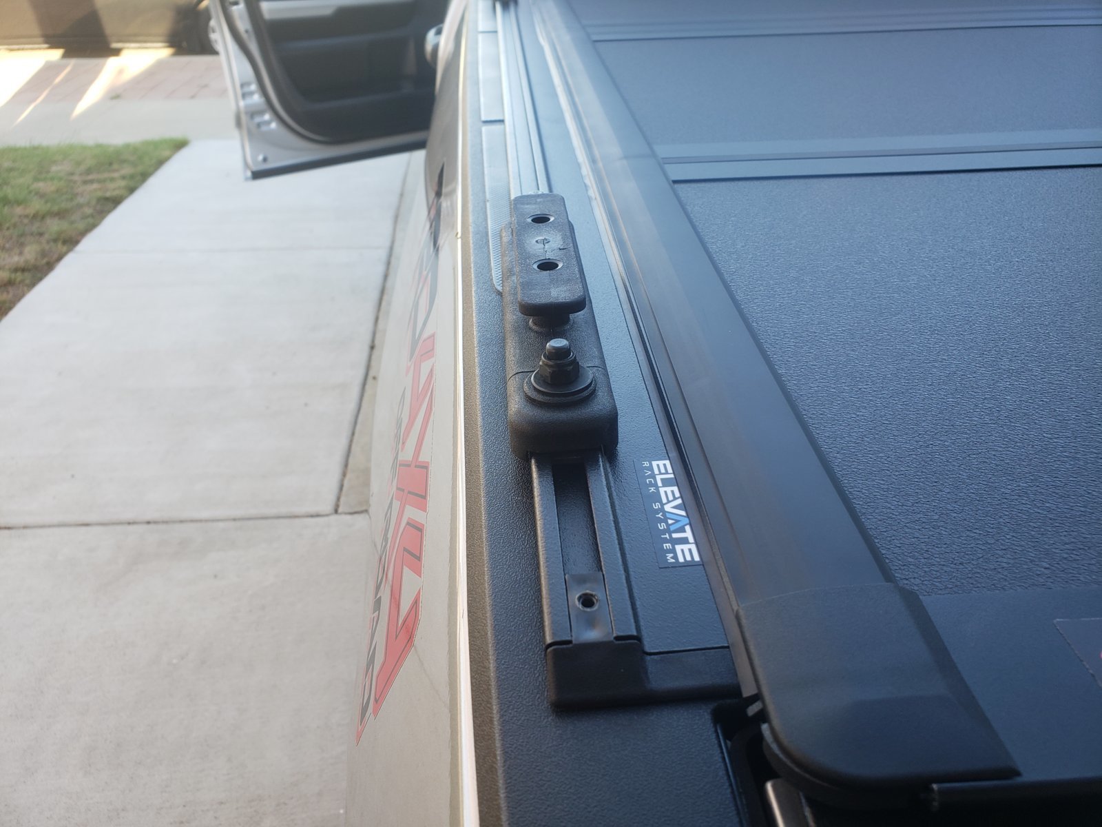

    How did you mount the racks?? I dont see any clamps holding it on. The pictures from the post above your arent displayed anymore - was it shown there?

    The Elevate racks mount to their T-Slot rails which are mounted in conjunction with the tonneau.

    I wasnt very clear in my question - I actually meant how did they mount the Tslot rails. I dont see any brackets connecting them to the OEM rails.

    The pictures should still be there. Pull the weatherstripping off the elevate rails. Take the Bak rails off the bed and pull off their weatherstripping, then just nest the elevate rails underneath the Bak rails and re-tighten the bolts that mount the Bak rails to the bed rail.

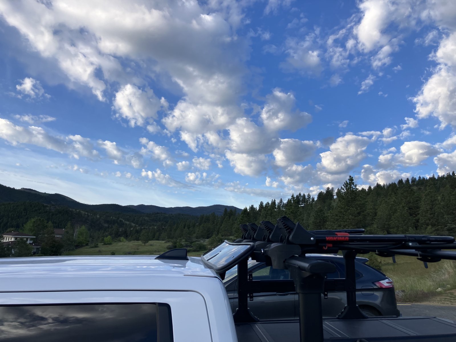

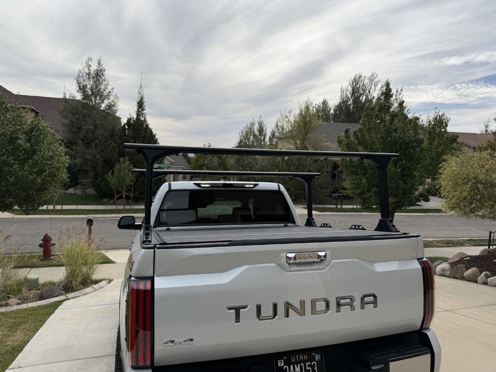

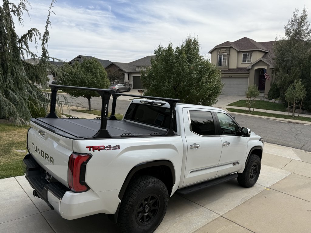

    I had some confusion with my local rack shop and communication with TruXedo. They said I needed the Toyota tundra clamps to mount from the tundra bed rail to the Elevate rail.
    I understand now after installing it that’s probably not true.
    The elevate rails are installed under the OEM tonneau cover rails. So the Elevate racks aren’t actually bolted down at all. The OEM tonneau cover rails is bolted on and the Elevate rails are underneath - so in theory they should be fine - unless you way overload the rack and it forces its way out.
    I just drove 3,500km (2,200miles) through the Rockies with a 150lb kayak on the rack and it did stayed perfectly solid.
    I also had to rip all the weather stripping off to get it to fit under the Tonneau rails.
    In the one photo you can see a Truxedo clamp installed. It's barely hanging on - I wanted to see if it was worth it but they do nothing and I couldnt put the bed rail back on with those. Thats why I ordered the 'Toyota clamps' but they also have nothing to bite onto so its pointless.

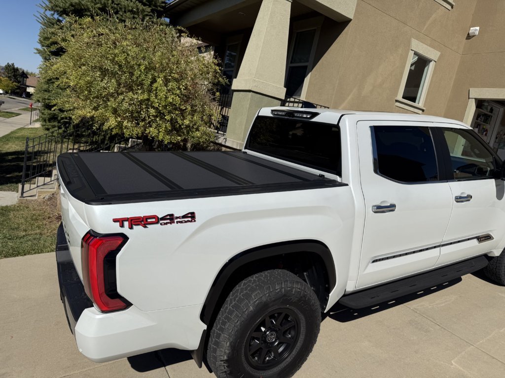

    hey, is everything still working well? I also have a 2024 Tundra that came with the backflip installed and I’m looking to add racks for my Kayaks. Everything says that the two aren’t compatible, but it looks like you’ve made it work. I spoke with one dealer that said that the deck rails will squeeze the backflip too much and it won’t flip up well. Have you had any issues?

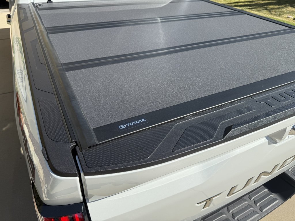

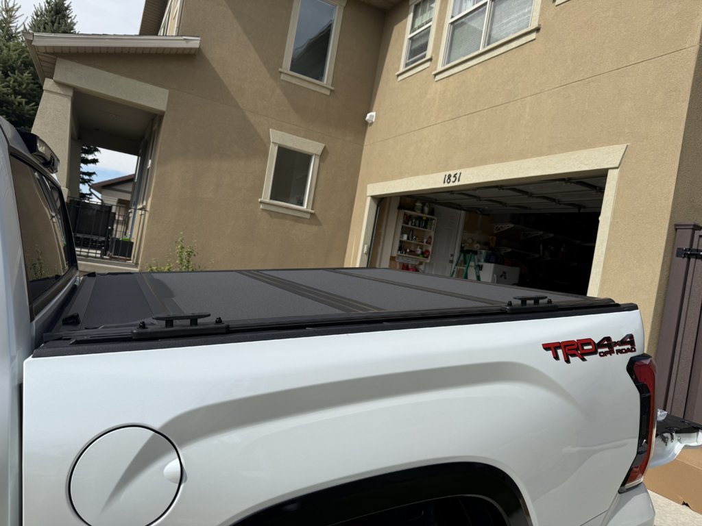

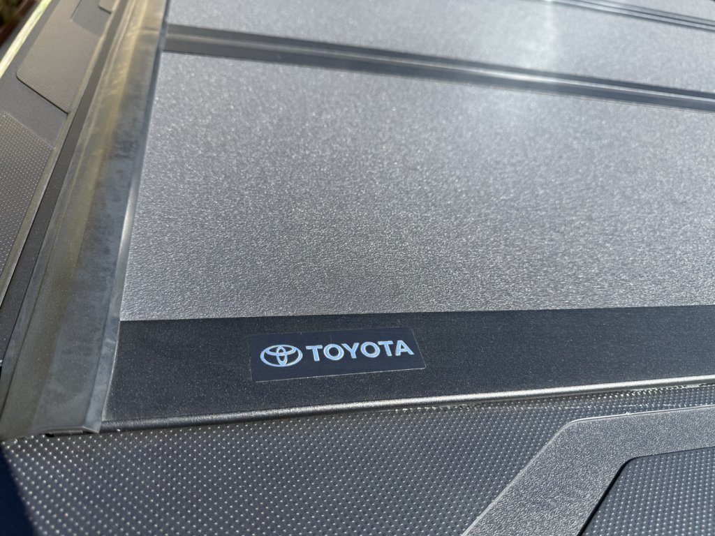

    Nice! Thank you for the response! I have the Toyota branded one as well. I’ll post a pic. I am pretty sure we have the same set up.
  29. Oct 10, 2024 at 1:54 PM
    4x4Remedy
    4x4Remedy New Member
    Oct 8, 2024
    #123984
    21
    24 Tundra
    3” Toyota factory lift. Icon 17” wheels
    It works! I did the same thing. Just took off those two weather strips and it’s a perfect fit! IMG_1819.jpg IMG_1826.jpg IMG_1827.jpg IMG_1830.jpg IMG_1829.jpg
