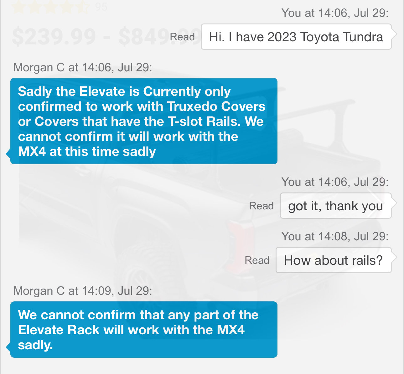

    Hi,
    If you have Backflip MX4 hard cover together with Elevate Rack, could you please share the T—slot installation details? According to the RealTruck they can’t be used together. TIA

    The MX4 picks up its outermost edge as it folds. I also don't see how an Elevate rack system would be able to play with a MX4 cover.

    The Elevate Rack is no longer compatible with BAK hard folding tonneau covers. The redesign of the tonneau cover and upgraded installation hardware interfere with the installation of the Elevate TS rails. You can still use the Elevate TS rails with hard roll-up or soft roll-up tonneau covers, and the Elevate FS rack can be added to tonneau covers that include T-slot rails, like Retrax XR models and the BAK X4ts.
