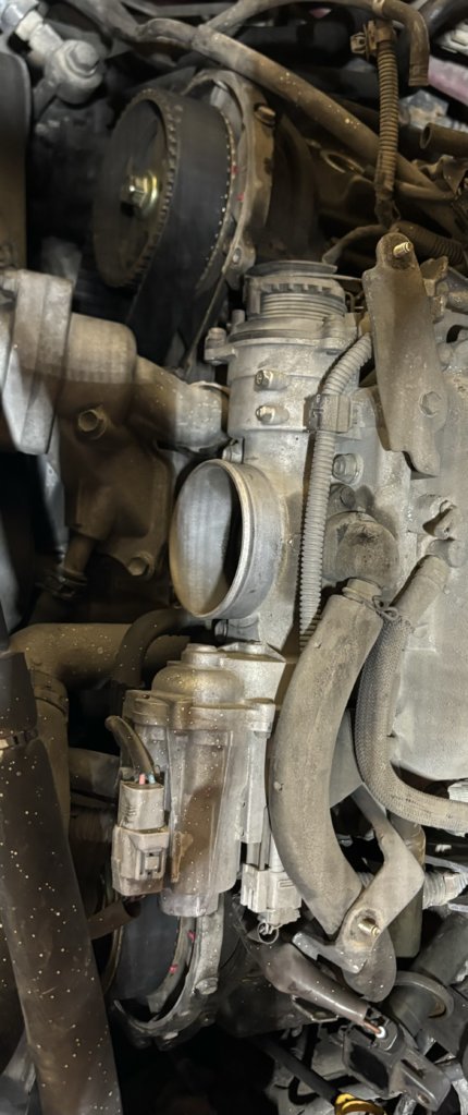

    If that was a head gasket, I would expect to see 1 cylinder, 2 cylinders, but not every cylinder at the exact same pressure. Before you dig into that fucker, did you check the timing? Just to make sure valves on bank 2 aren't opening at the wrong time, and that's the source of both the shitty idle. Don't expect the seller to tell you the truth on this one! I suspect the '24v jump' is potentially bullshit. Some people just can't help but strum up stories rather than admit they did something stupid, like get the timing wrong while doing the timing belt on their own.
    To that point, have you checked the condition of the timing belt to at least confirm it's ever been changed? Snapping a belt can brick the engine, it's an interference engine (low interference, but we've seen boat anchors happen in the past). I'd love to see a pic. Simple to look at it, 10mm socket, loosen a timing cover enough to lift and expose the belt.

    IMG_6512.jpg I think you may be right on the botched timing belt install.

    Ended up going ahead and changing the timing belt/water pump with an Aisin set. My thought was if the valves were bent it would not have even had the 60 psi compression. Turns out I got lucky as it has full compression and runs great now. Thanks for you guys help!

    Yeah, that compression test was really the red flag for me you were out of time. PO botched that one, or something jumped. Either way, congrats, and glad you got it solved! And it sounds like you may’ve gotten a great deal for a truck that just needed a tiny bit of tedious work.
