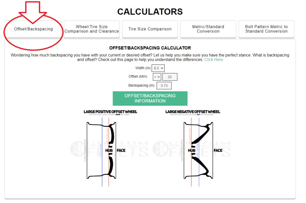

    After reading that thread, the optimal wheel size is 17x8.5 +0 with 4.75 backspacing. I messed up. I jumped the gun and bought a set of 17x8.5 +25mm wheels. Can I get away with +25 or should I just return the wheels?

    Return wheels. 5.73" backspace will have your tires sitting on top of the coils before the truck touches the ground, unless you buy 1" spacers. I wouldn't want to run spacers while towing, unless you're anal-retentive about hand-torquing to ensure you don't crack a spacer like @KNABORES.
    If anyone else ever touches your wheels, I wouldn't go there. Impact jockeys at the tire store DGAF and will blast shit down at 150+ and crack your shit to bits.
    How in the hell did you land on that wheel size? :rofl: I didn't even think anyone sold wheels with that backspacing for the old style of Toyota 6-lug (6x139.7 / 6x5.5) with a 106.1 hub bore.
    Hub bore is important too, btw. There's a reason to stick with Toyota specific wheels. And you can't use newer (2023+?) 6-lug Toyota Tundra/Tacoma wheels because the hub bore is in the 90s. Requires custom hubcentric spacers.

    Wheels have been returned and 17x8.5 0

    I've returned the wheels and ordered a new set, 17x8.5 +0MM 4.75 backspacing with a hub bore of 108mm.
