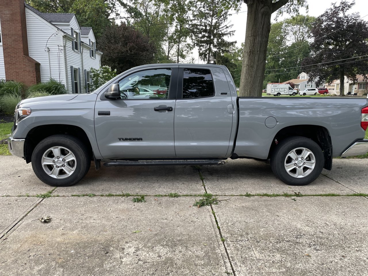

    Not much info out there on these. Especially if your looking to not level your truck. Had them on my Tacoma and loved them. Back then I bought the kit eibach sells that came with lift springs. While ideally that’s what is best, the problem is the lift in my opinion is way too much with there springs. I’m only looking for a slight lift on my trucks so anything over 1-1/2” is overkill for a truck used as a truck. My Tacoma was way too high in the front even on bottom setting so I removed the springs and went back to stock. Giving me 1.75 up front on 3rd clip up. Then even put a 1” block to get some rake back. This time with the tundra I opted out of there kit to save $100 and bought shocks front and rear individually. Second clip up said .6 lift so I went with that bc 3rd up boosts to 1.2 which would be my max I’m looking for. I tow a 6,000lb boat constantly and once a year 500+ mile trip. Truck used to nose dive on hard braking and lean hard into turns. Now she’s straightened right out. Although not as huge of a difference like on the Tacoma bc of size and weight, it is a significant improvement. Never tried bilstien 5100’s but I can honestly say eibachs are awesome and probably never will. My needs are better off road clearance, towing efficiency, and on road handling and these have fit the bill on my last two trucks nicely.

    Eibach kits that come with or without Springs are internally and externally identical. There springs will just give u more lift than 2” on the bottom setting compared to stock springs being more adjustable below 2”. Yes the 2.0 version is fully adjustable to whatever exact height you want but I’m not that crazy, and I don’t professionally Baja the thing just want something that grips the road instead of leans and dives.

    I’d definitely go for it. Towed my 7k boat 1,000 mile trip this summer and handling was great. Empty ride and handling has been impressive as well. When I’m due for tires I may go up to 1.2 setting, funny I’m getting grabber atx too

    No problems whatsoever with the Eibach shocks or with RAS. I've never felt that the shocks didn't have enough compression or rebound. I've since sold my travel trailer, so I really don't load the truck like I used to...but it's nice to know that I can load it down and not have much sag. I did fill the bed last weekend with fire/bbq wood (close to half a cord of mesquite) and had the rear drop about 1-1.5in. BTW, I did "lighten" the setting on RAS after I sold the TT, as I didn't need as much preload. I highly recommend this setup if you tow/haul on the heavy side from time to time.
    Edit: I ended up setting the front shocks at 1.25in "lift" height. This combined with the RAS at near max setting gave me close to 1.75in rake. When I set the RAS to a lighter setting the rake is closer to 1.25-1.5in.
