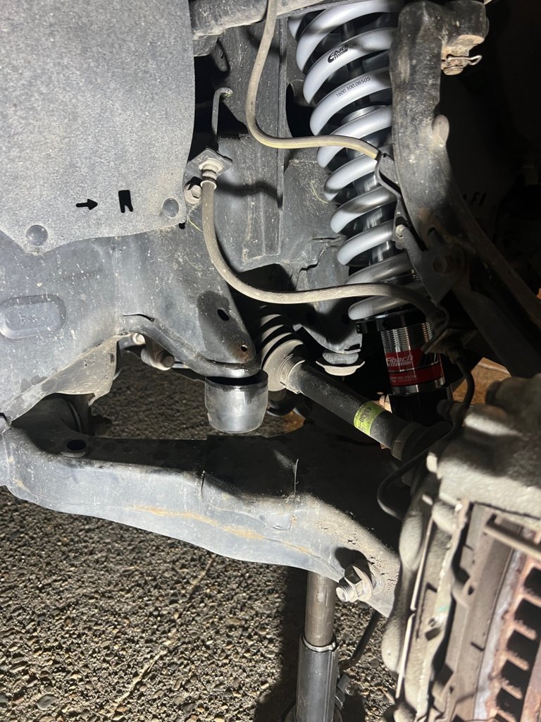

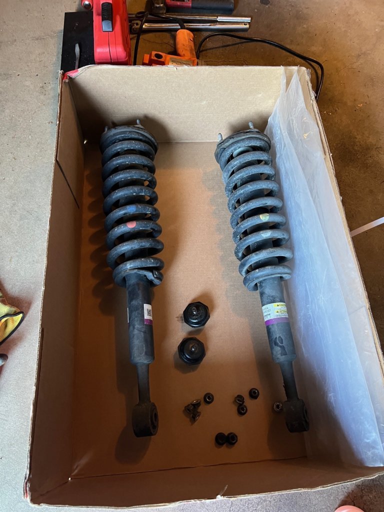

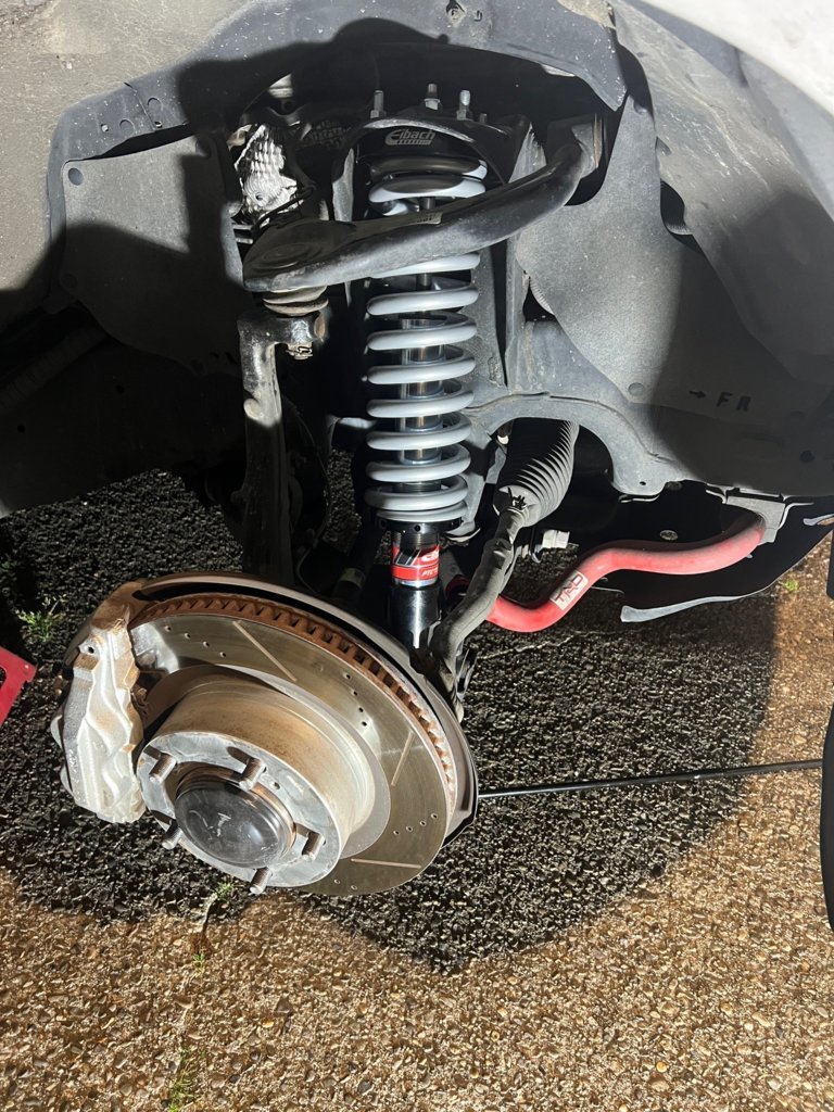

    I figured this was a good place to add. I purchased the Eibach Pro 2r kit and f/r Durobump bumpstop replacements from Hotshot Offroad and just finished the install. This was to replace my stock Hitachi shocks/struts on a 2018 Platinum Crewmax with ±116,000 miles. Overall, the install was straightforward with no issues. I soaked everything with PB blaster for a couple days before I started, and thankfully I didn't have any issues with the front bumpstops like a lot of folks. They were definitely rusty, but came off clean with a little finesse.
    I tackled the rear end first. Didn't have to remove the tires, just jacked it up high enough to get full-droop on the leafs and then coaxed the shocks into place. I loosely threaded the upper mounts on and then lined up the lowers. I did the rear bumpstops with the truck fully back on the ground, and then snugged everything up. Drove it like this for 2 days before I installed the front coilovers and already hugely improved the ride quality and handling.
    Last night I installed the front coilovers. They went in more or less exactly like the instructions/youtube videos show. I do have a couple of comments specific to my install that might help others. I only had one side up on jackstands at a time. I removed the lower front sway bar bolts before lifting it up and removing the front tire. Then I loosened the upper and lower strut bolts, popped the tie rod out of the knuckle and removed the bolt holding the ABS wire bracket to the upper control arm. This allowed plenty of flexibility to pull the knuckle out of the way. I decided to leave the brake caliper/disc on just to simplify things and had no issues like that. Once I removed the jack from the lower control arm I was able to pop the ball joint off the knuckle (with a pittman arm tool - mine were definitely not loose like in the video) and lean it out of the way. The original struts came out pretty easy with a 36" pry bar under the lower mount.
    I wanted to keep the factory ride height (roughly) due to garage clearances at home/work so I lowered the collar 8 full turns (1/8" per turn) on the bench before I installed them on the truck. I put the lower mount in a vise and held the top mount, sprayed a little lube on the threads and marked a reference line on the collar. Then I just used the spanner wrench included in the kit. This worked out great, and barring any settling as they break in I am roughly 1/2-3/4" higher in front than before, likely due to the well-loved factory springs. Even with the preload collar lowered about an inch these were still quite a bit longer than the factory struts and took some effort to get into the lower perch. I had to use the pry bar and a dead-blow hammer on both sides, but once I figured out the correct approach they went right in. Once the lower bolt was back in with the nut loosely threaded, I snugged up the top nuts and reinstalled the tie rod at the knuckle. I had to jack up the lower control arm a bit before I could use the pry bar to pull the upper control arm/ball joint down enough to thread on the nut. Once it was snugged up, I went back and torqued everything down. Then sprayed the rearward front bumpstop with PB Blaster again and used large channel lock pliers to remove them. I had to use a flex-knuckle socket adapter to have clearance to install the new bumpstops but they went on easy. Then, I put the wheel back on and lowered the truck back on the ground. Basically the same on both sides. Once both wheels were down I reinstalled the sway bar end link bolts and double-checked torque on everything. I'll probably check it all again in a few days too.
    Before install, the front was sitting at 37" from ground to fender and the rear was 39". After, the front is sitting at 38" on both sides so just about an inch of rake. TBD if the springs settle at all but I'll recheck after a couple-hundred miles. Going to get it in for an alignment next week, but so far it tracks straight with just a slightly vague steering feel over uneven ground. The ride improvement is dramatic. It actually rides like a truck now - but in a good way. Firm but forgiving, definitely not supple, but it feels like higher speed bumps are totally smoothed out and the truck feels solid again. Honestly the most noticeable improvement is over the lane marking turtles at 25-30mph. Those used to shake the entire truck (definitely needed to do this 60k miles ago) and now I don't even feel them.
    Side note - I noticed that both front sway bar end links have play where they attach to the TRD sway bar. They are Moog end links, with less than 10k miles on them and the bolts are completely rusted/frozen. Sadly, I suspect I am going to have to replace the sway bar if the holes are wallowed out. I still have the original end links in the garage, so I'll try swapping them out first when I have time. Definitely explains the creak/clunk I've heard lately. Hopefully the sway bar is ok, and its just junk end links. Too bad, moog used to make quality stuff but these are definitely garbage. Seems like the steep price for the OEM ones is the way to go.
    Anyway, here's a few photos. Sorry for the potato camera, I was doing this mostly solo and photos were an afterthought.
