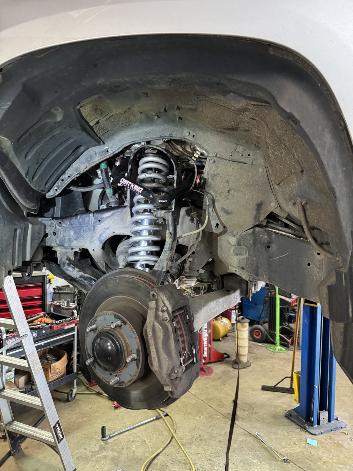

    Well today finally got here. Lol. Got over to my mechanic early this morning and got the new suspension on. Eibach stage 2r. also installed dirt king ucas. Got an alignment done and instant enjoyment. My
    Mechanic came back and was saying how much he like it and how much better it was than stock.
    I went in with a take it or leave it as to changing the lift on the fronts. We talked about it for a bit and I just said to leave it as it comes. I have a Prinsu roof rack and ARE topper with rails on top. I have to carry 16 and 20 ft lumber to some of my sites when my crews need it. It’s already kinda tall for me so leaving it at a 2 inch lift is fine. Wife also voiced her appreciation not to lift it more than 2 inches.
    The ride:
    I immediately noticed a big difference between 120k stock and this set up. Nose dive is gone, sway is gone and it just soaks up bumps very nicely. Not as stiff as my dobinson ims on my Jeep grand Cherokee but I kinda prefer the Eibach. The Jeep is my wife’s and she likes the way the dobinson ims suspension is on the Jeep. Stiff. I know I know, that’s what she said .
    But I also had bilstien and ome springs and struts on another vehicle and prefer the Eibach stage 2r.
    That being said, all of these suspension upgrades were all nice and rode great. None were heads and shoulders better than the other. But I will not hesitate to put the Eibach on other vehicles I have in the future.
    Also installed dirt king ucas. What can you say? The guys said it was very easy to do the alignment and they seemed to be a great quality uca.
    also installed the carrier bearings.
    I know the uca and carrier bearing are not necessarily needed but it made the alignment a lot easier. That’s a win.
    If you’re on the fence go for it. Give Colton at hotshot off-road a call and he will take care of you.

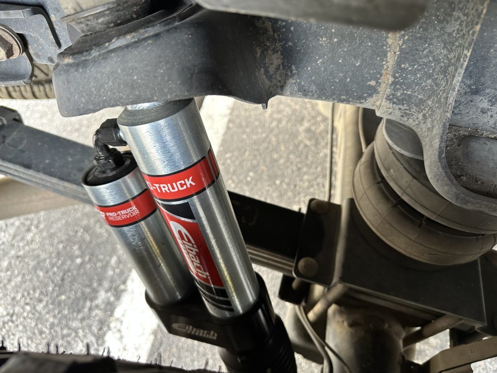

    I had the RAS HD installed about 5 months ago or so. That made a huge difference. That alone stiffened up a lot of the body roll and took out all the bounce in the rear. It also got rid of the porpoise effect from the rear. So it made the rear solid and predictable but it also made me realize how soft and bouncy the front had become.
    Again, I have 125xxx on the stock suspension so it was time but I bought the truck with 30xxx miles and I never really liked the stock suspension. I have the limited and it was ok but not near as good as now.

    Can somebody with the Eibach 2.0 R rear shocks show me what they have going on for the bushing situation? I know you’re supposed to use your old bushings but when I pulled my stock shocks off there was not a washer on the bottom side which just doesn’t seem right. Any help is appreciated.

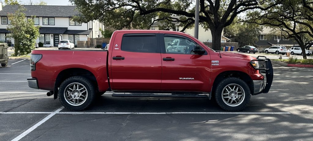

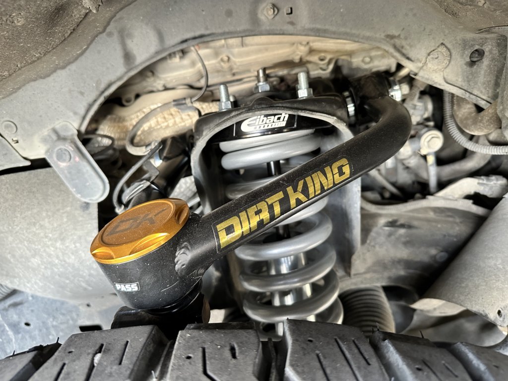

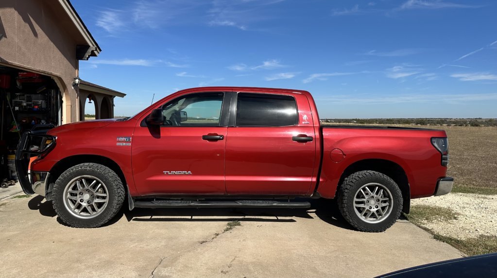

    I got my Eibach Stage 2R's and Dirt King 2nd Gen UCA's installed as well as getting the alignment done (that required me going to 2 different shops to get done. My nearby shop that I've traded with for a couple of years lost a customer in me for how they handled this. Not acceptable for a shop that claims to specialize in lifts).
    I did the shock and UCA installs myself, and it was my first time doing that kind of job. Learned a lot, but it went well, I thought.
    Before install, the distance between the top of my rear tire and the fender well was 8". After install, it is 8.5". (I could compress the rear shocks holding them in my hands and pressing my hands inward. They were that bad). Before install, the top of the front tires were 5" from the fender well. They are now at 7". So I still have about 1.5" of rake, and that suits me fine.
    The Eiback coilovers came set at 2.5". I backed them down .5" (every full turn on the collar will adjust the height by 1/8").
    I drive about 60% of the time on city streets, highways, and toll ways. The other 40% is on rural backroads, some of which are in poor condition, as well as unpaved/groomed roads, and some two track trails. I work in the city, but I live in the country (I office from home, but my clients are all in the city, so I travel into the city several times a week for onsite meetings. I avoid highways and toll roads where I can, opting for backroads as often as possible). I don't do overlanding, and I likely would not attempt anything beyond Green rated offroad trails. (Maybe a lite Blue rated, but it would only be at the lower end of that range. I didn't set my truck up for that sort of use).
    My previous setup appeared to be the stock OEM black shocks and UCA's. I have no idea if those had been changed prior to me purchasing the truck. (Bought it in 2019 with 114k on it. It's currently at 185k). But they were way past worn out when I installed the new components last week.
    Driving. Just wow. Like a whole new world. Much, much smoother on paved roads. Handling is much more stable. As others have stated, it feels much more planted. Bumps, expansion joints, and the like are all but non-existent. Railroad tracks are much more subdued. Paved roads that are in poor repair/condition (of which I travel frequently) and unpaved roads are much more pleasant and manageable. I haven't had it down any two-track trails yet, but I have no reason to believe that the performance and ride will be any different than the other pavement that I travel, taking into account that rougher surfaces will be..... rougher than smooth, groomed surfaces.
    And as I stated before, the handling is soooo much better. I haven't towed with this setup yet, but I don't tow but a few times a year, and nothing regularly like a travel trailer.
    To be clear, it's not like riding in a Cadillac hovercraft. It's a pickup truck. But it is such an improved ride and driving experience compared to what I was riding on. I wanted effectively a hybrid setup that was good on road and offroad, but specialized/dedicated for neither. I feel like I got exactly that. I am very happy with this setup, and I'm satisfied with my purchase. (Another shout out to @memario1214 at Hotshot Offroad).
    In a few weeks when my annual bonus hits, I'll be getting new wheels (Fuel Coverts w/20 offset). I'll be keeping these same tires as I have been pleased with their performance and wear thus far.
    Before (on an inclined driveway):
    After (on a flat parking lot):
